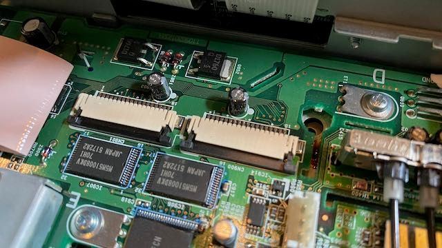

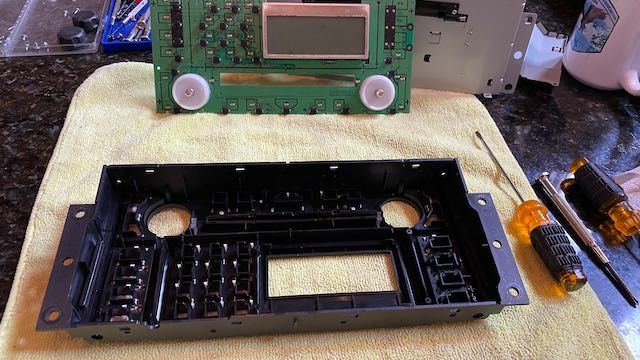

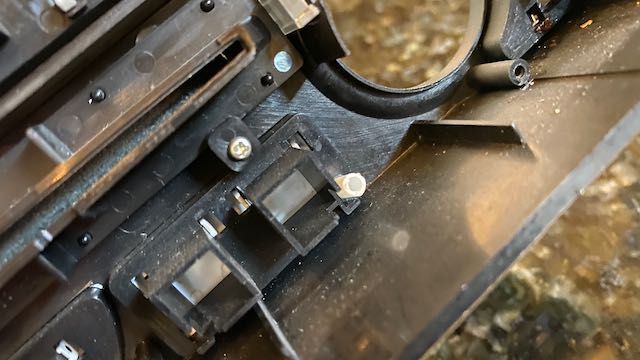

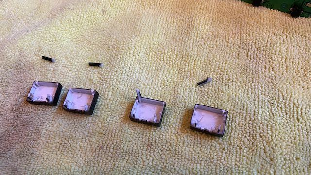

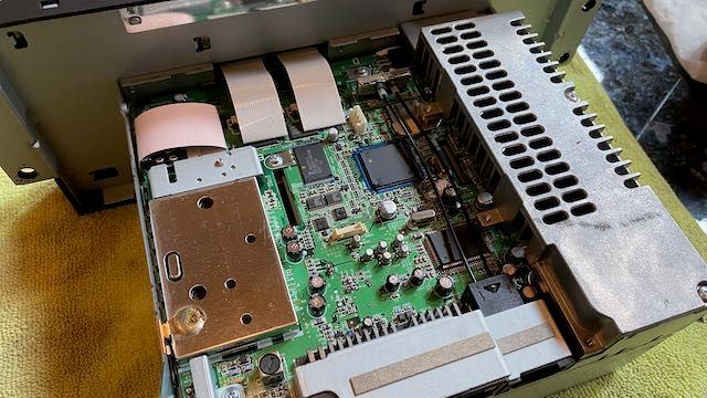

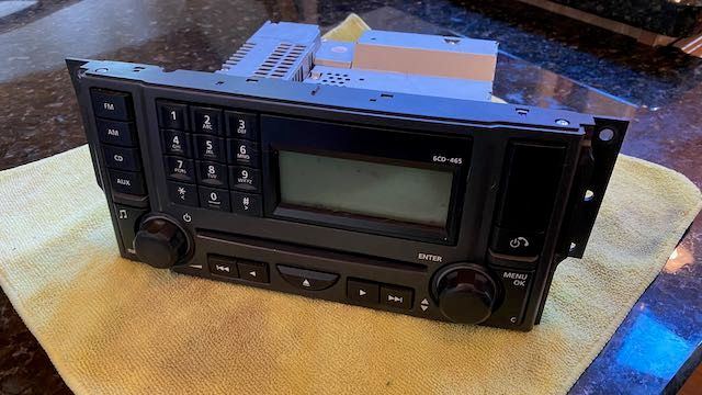

Default Fix for "flat" or broken radio buttons...

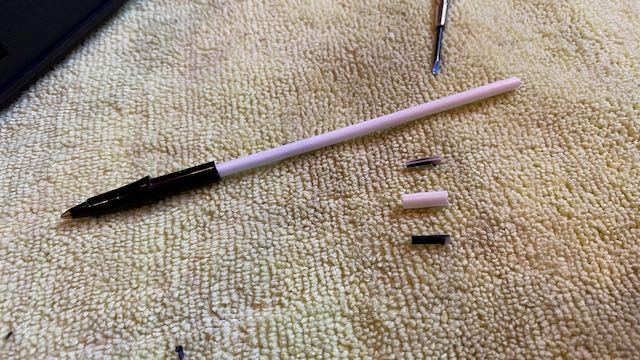

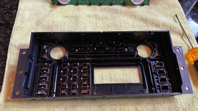

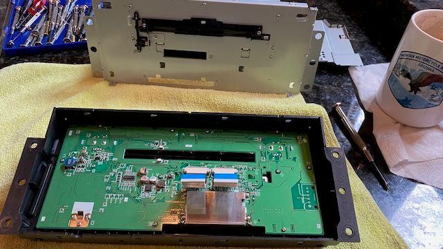

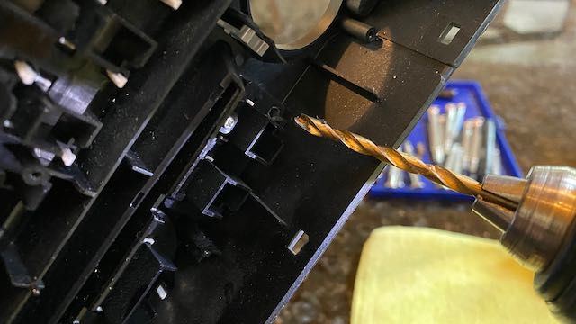

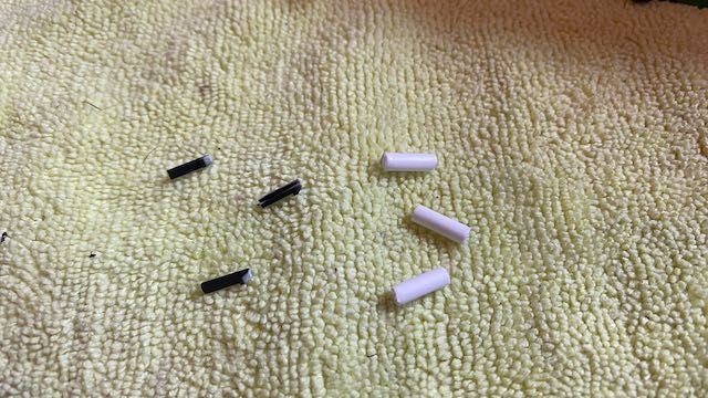

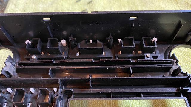

I followed the directions here:
https://landroverforums.com/forum/ge...buttons-52892/
worked fantastic! Only advice I have is to keep the broken button in the mounting plate when drilling from the back, just be careful to not drill too far. If you try to remove the buttons to drill, you might end up breaking the pivot point mountings of the buttons themselves as they are very delicate.
I've added some photos during the process. Once done, I had all the buttons working again. Just take your time and don't force anything, and don't over-tighten any screws while reassembling.
