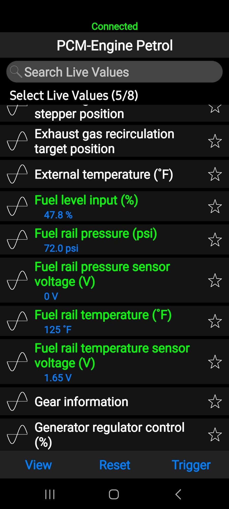

Default do these fuel numbers look normal
This is at idle after running for 60 minutes.

I just dealt with this same issue, however the time period between starts ended up getting longer and longer for me, sometimes up to 45 minutes! I replaced many of the same parts you did as well.
What ended up fixing it for me was I went back and carefully re-seated all of my injectors. Based on some research it sounded like it was getting vapor locked, I never checked fuel rail pressure after running it but the symptoms were textbook. One of them had to be loose somehow. After doing this it starts fine now when warmed up.
Best of luck, I know how frustrating this can be.

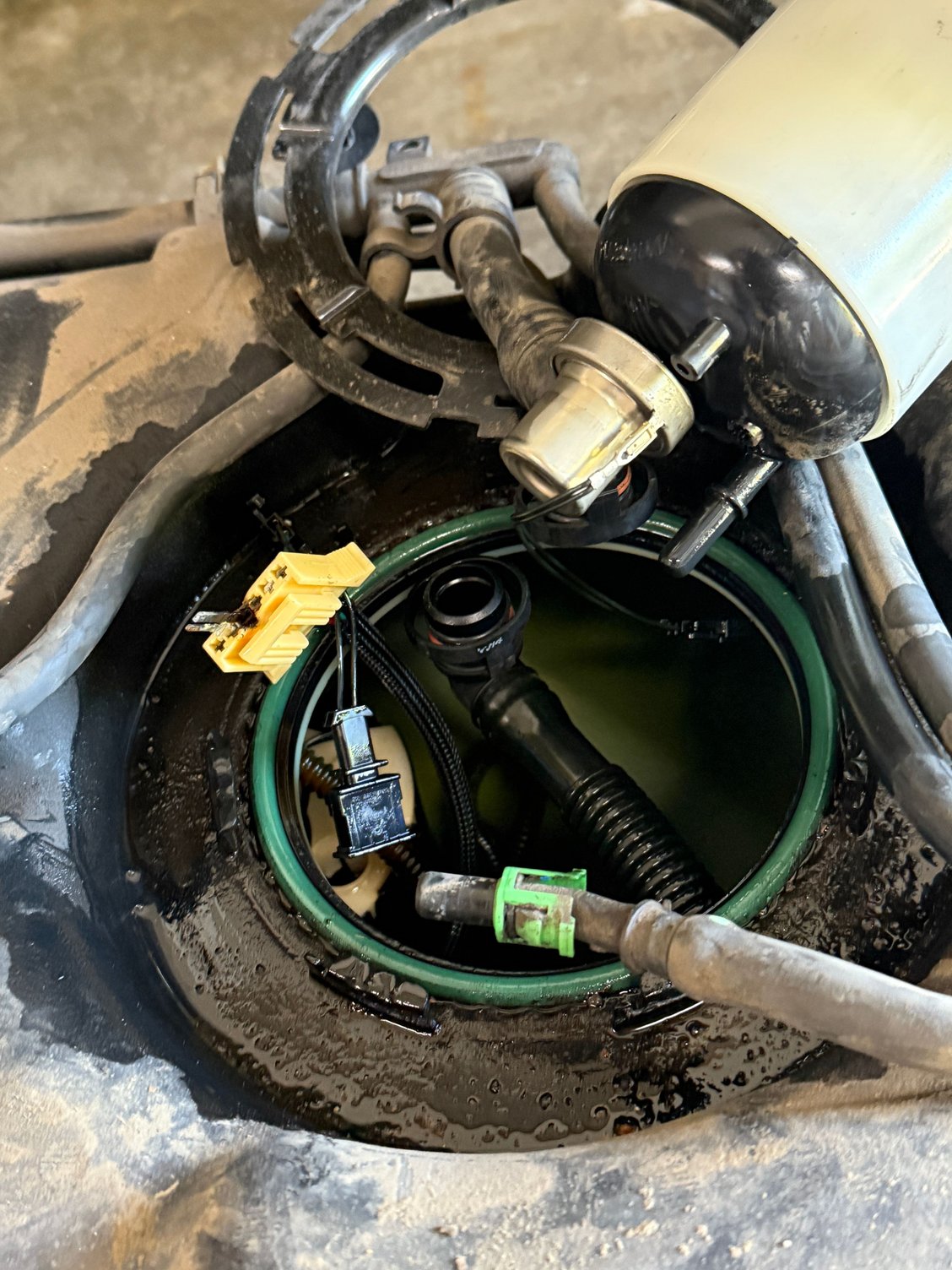

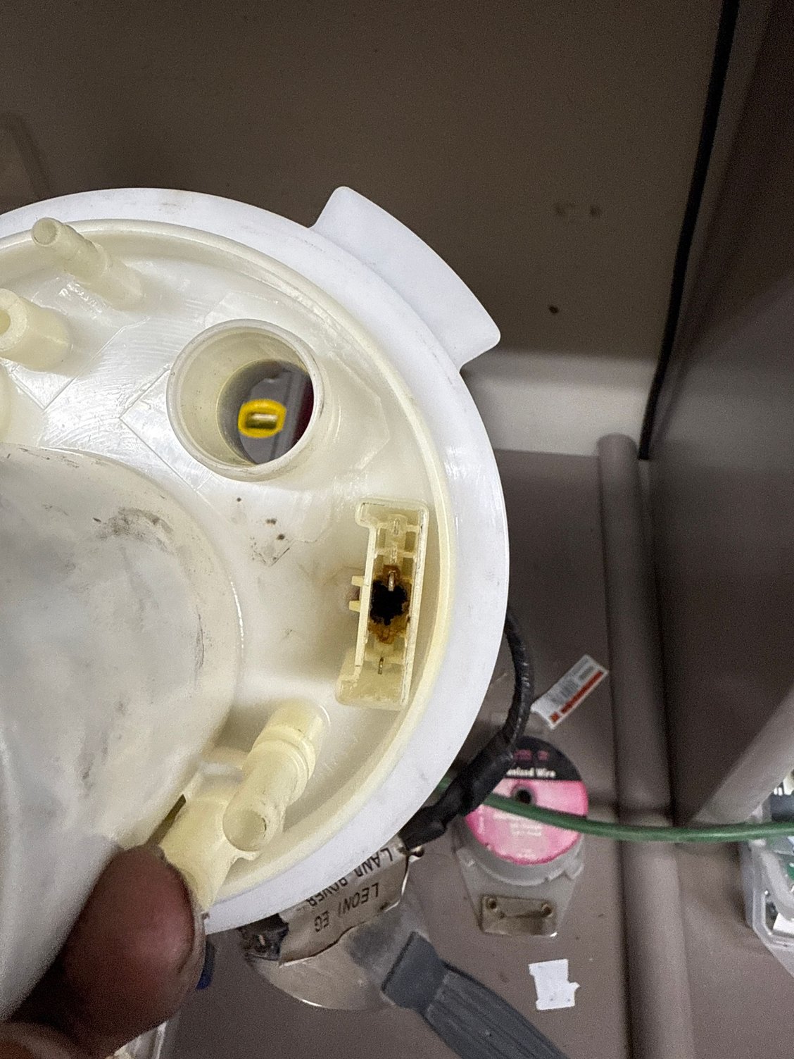

I just found the issue with my LR3 which wouldn't start when it got hot. I found the filter flange plate connection for the pump was all corroded and burned out on the inside of the tank.
not sure i can add pictures since this is my first post but it may be something to look at that may help you.
I looked back at the Carfax history of this vehicle and it seems the previous owners went and replaced a lot of what you had replaced and i bet they was trying to track down this intermittent problem by doing so.
When I initially replaced the pump I noticed this same condition on my filter assembly so I replaced it too. Didn't fix the problem. I have since replaced it again with an OEM filter. Still no change. Interestingly enough there was also a fuse associated with the fuel pump under the hood that appeared to be overheated and slightly disfigured. Of course I replaced that too.
I'm wondering if a clogged filter caused an overheating situation with the circuit and now there's damage somewhere in the circuit. I have no idea. Did replacing the filter fix your problem? I've done it twice..
