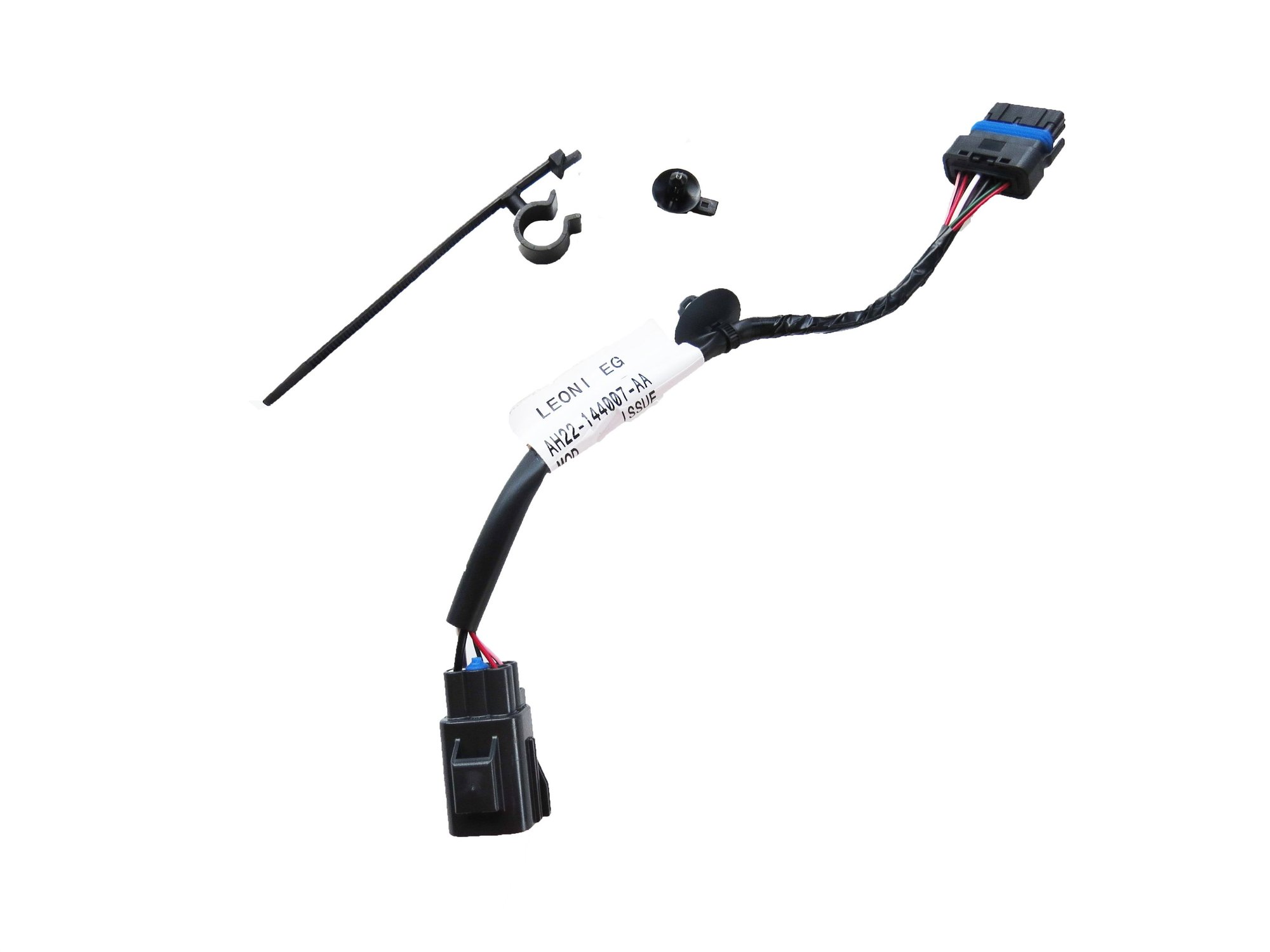

I'm still waiting for parts to come in hopefully they will be here today. i am replacing the pump filter and jumper cable.
I think if the fuse was disfigured then the harness that supplys the pump took alot of heat.This can cause the cables to become brittle and even effect the plug connections. i know the jumper cable between flange plate and the harness on mine is warped slightly and the female spade connections don't look 100% due to the heat from the bad connections.
I dont under stand why they added a different connection to the flange plate that required a jumper cable to link up to the old harness connection. seems dumb to me to add in unnecesary connections.
if the new jumper cable doesnt fit to the harness correctly i will cut the end off and splice it in that way then the only connection is the top side of the flange plate.

Thanks a lot for the reply. What is this jumper cable?
Old Oct 7, 2024 | 08:57 PM
  #23
Saluk's Avatar
Joined: Sep 2024
Posts: 12
It is from the top of the flange plate to the existing harness. I believe this was needed for the upgraded fuel pump.

the harness side was misshaped probably due to heat. It wasn't so bad that i couldn't push the two together.

Yes, it's been running without issues so far. I replaced the pump, filter and that link harness.
