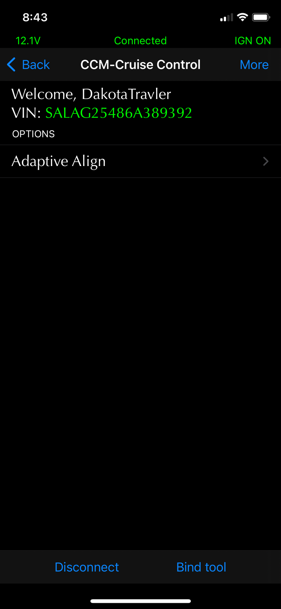

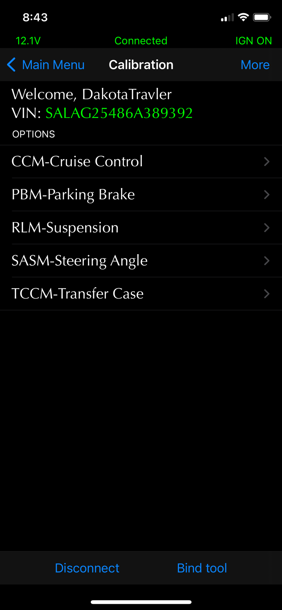

And another update. Playing with the GAP tool, I now have a way to calibrate the radar and it all shows up in ECU infos. It was an easy fix... Just had to re-scan ECUs. This is something one is suppose to do when they first use the GAP tool. It basically searches the vehicle for all the ECUs you have installed and builds a list. It will not update that list until you scan again. I dont recall this being mentioned on the Disco3UK site - maybe it was - but I do not recall. I am not going to calibrate unless I have an issue as it seems to be working great right now.
