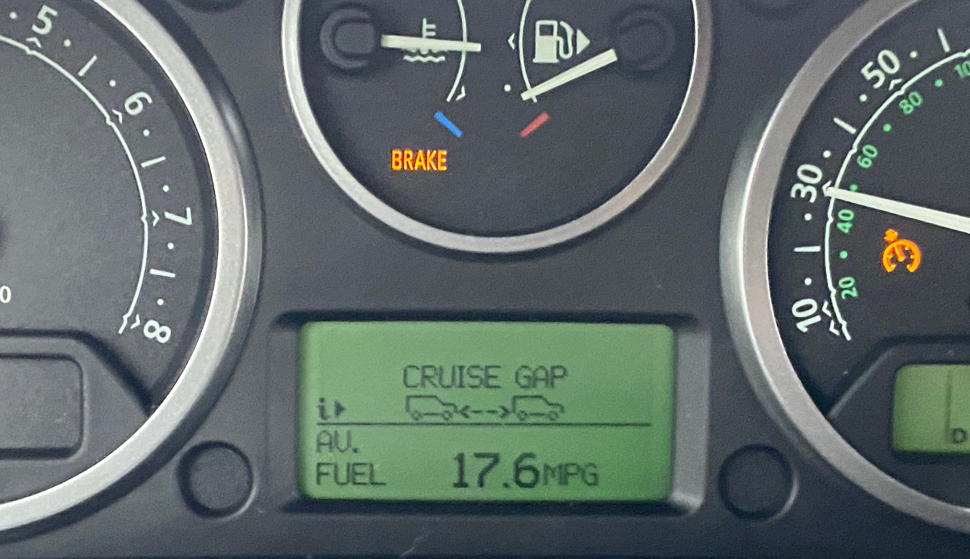

Working!

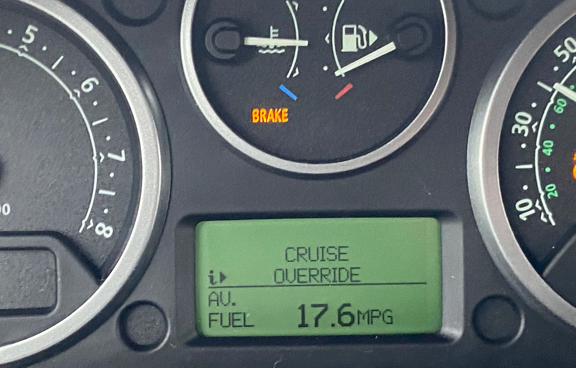

I installed the module and I only got "cruise not available" when I would press any of the steering cruise switches. This was not happening before when I would press them, so obviously something was different. No calibration alerts or anything. I figured I would let the truck sit for a short while, at least a couple minutes for it to do a proper power down as I read once before that worked for someone. And it worked for me too. It still does not show up in ECU infos which even GAP said it should. But maybe on an LR3 it will not. Also there is no way to calibrate it in the GAP menus that I can see. However, it seems to be working fine as is. While I have not tested it much, it did apply brakes as I came up to a slower vehicle and I have no errors. When I apply the gas with it set, it says 'cruise override'. But it still does not show up in the list under faults even when showing all ECUs (although 'Cruise Control' shows under all ECUs, but says not fitted). So it seems to work, but not sure if it will ever spit out faults or such that can be read. Maybe the truck needs another sleep cycle? Will tinker and check with GAP again.

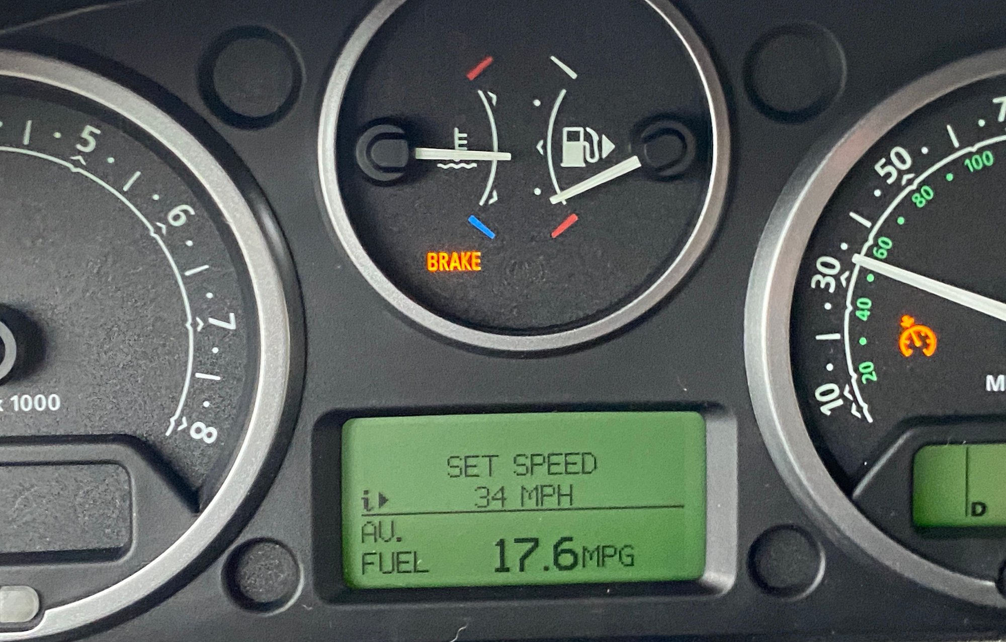

One thing I like and did not know about was it showing what speed the cruise it set to. That is something I like in modern vehicles and I always felt the LR3 should have had from day one. I mean why not?

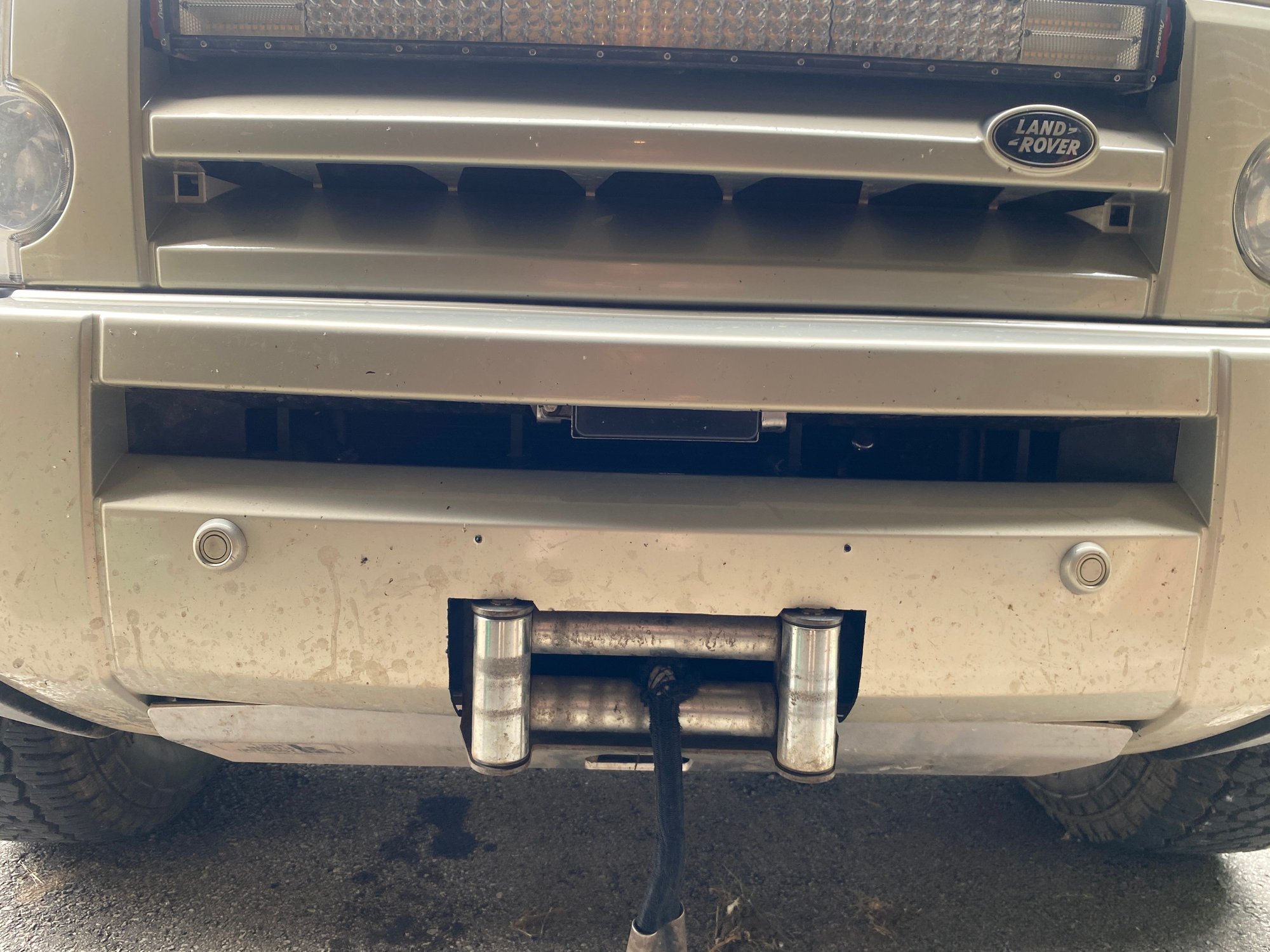

And this is how the module looks installed, mostly covered by the front bumper cover. I really had no choice on location unless I wanted to get really creative with modifying the grille. I have since painted the brakes black to hide them better. And it sits low enough that downward pressure on the bumper cover does not press onto the radar module.
