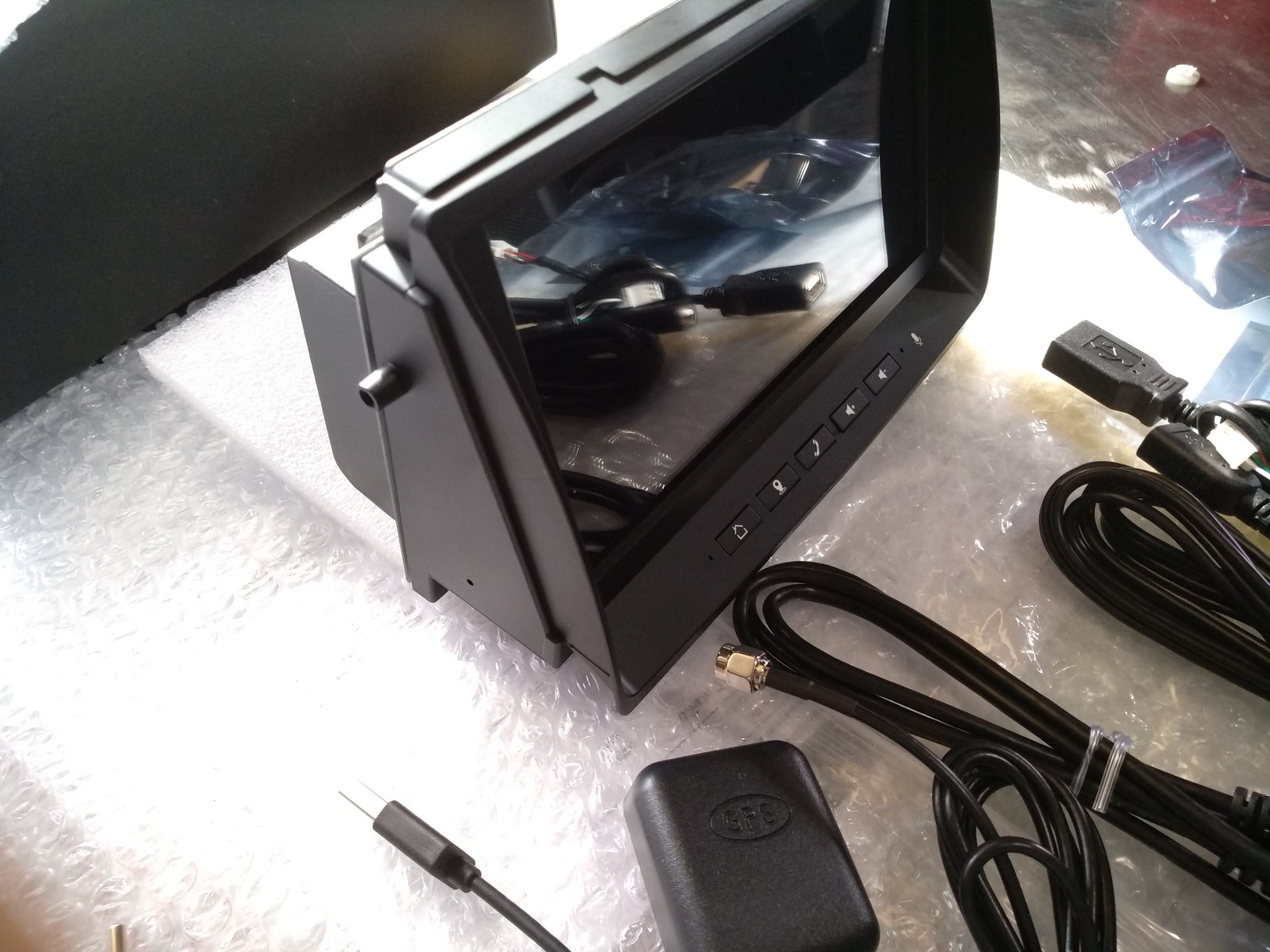

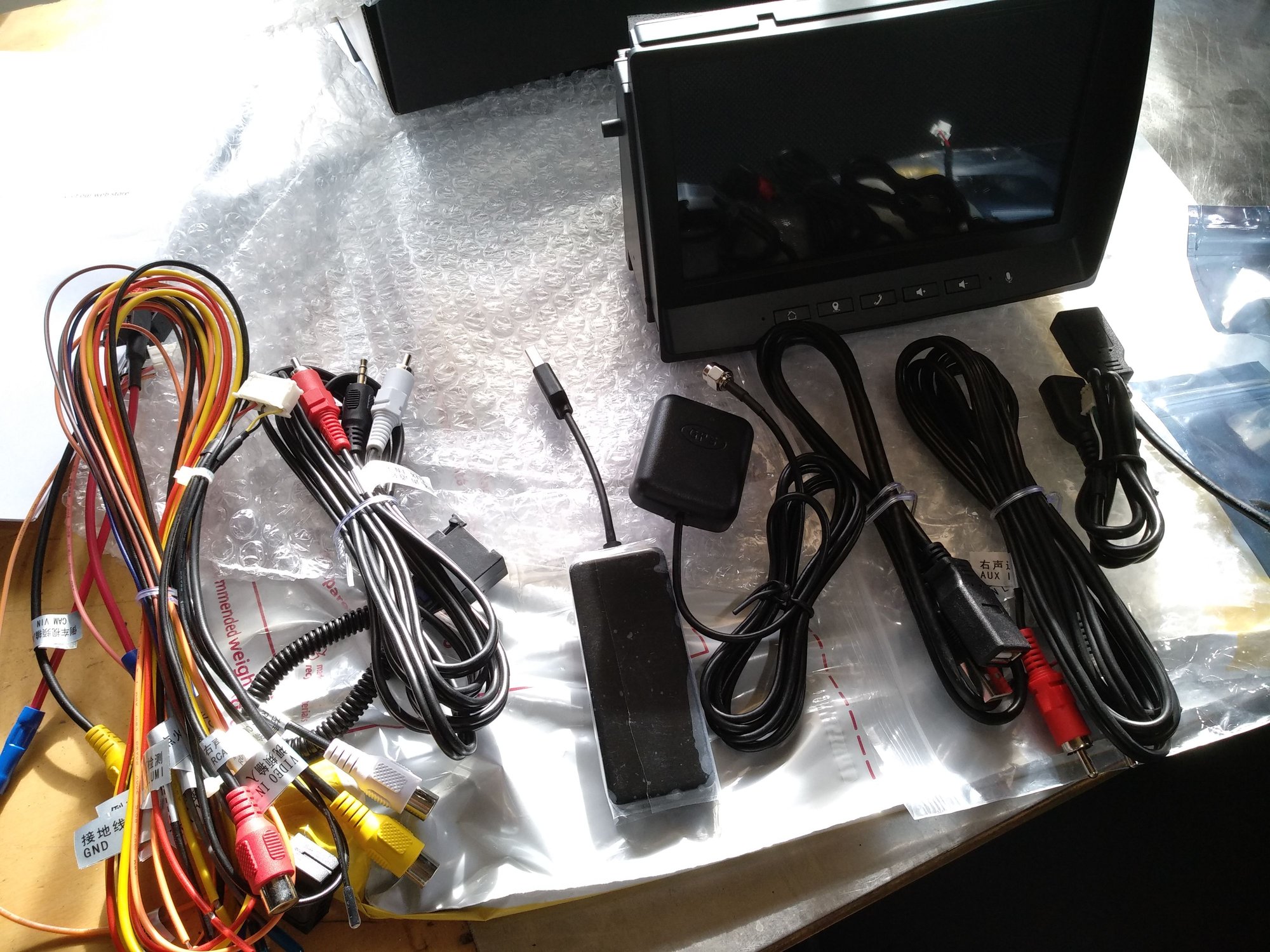

I installed this unit in April but wanted to use it for a while before making a decision if it was worth it or not. After taking it on a long road trip to Cape Cod as well as daily commuting I can honestly say this unit performs great. Having Waze or Google maps, podcast streaming, voice calling, voice texting, back up camera as well as front camera really improves the driving experience and makes me love my LR3 even more. I bought it from a company in England called Unique Auto Developments. It was pretty straight forward to install although the instructions suck. I had a problem at first getting it turned on, the ground wire had pulled slightly away from the plug, the company replied to my emails about that but never got back to me with three other questions I had about wiring up the cameras. I'd say support is lacking. It plays through my existing radios AUX port and I can still use the Rovers bluetooth connection to talk on the phone even though the call is going through the new unit. When I get into the car i plug my phone in and Android auto automatically comes up and I'm ready to go. All in all works great.
front camera
rear camera
Charging port for phone, one for android auto, the other for phone mirroring
Looks factory

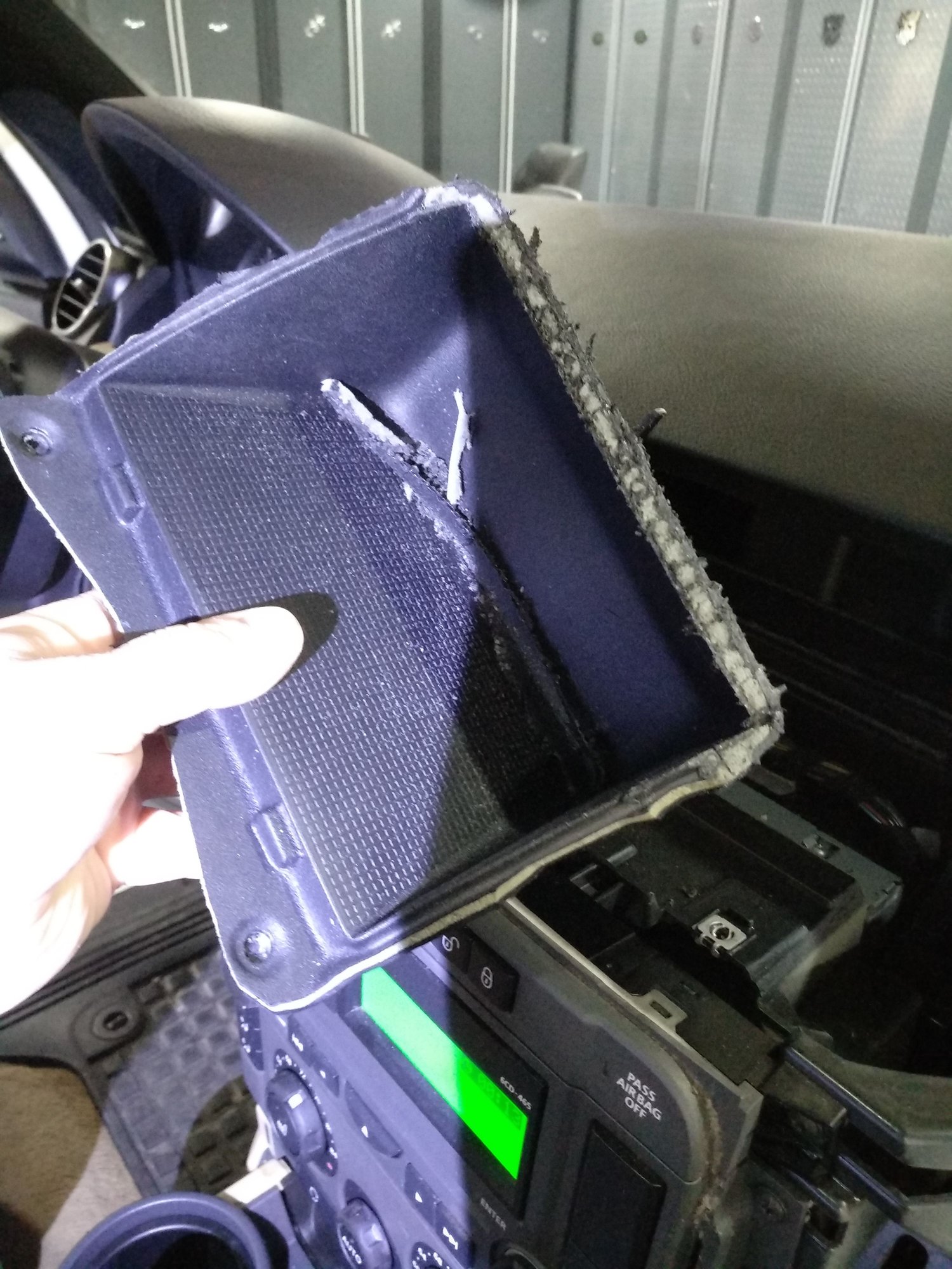

Have to remove storage box
One cut, straight across the top to remove box
