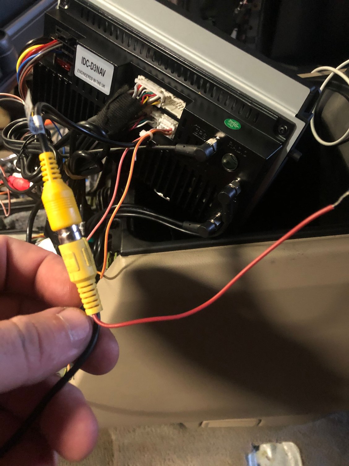

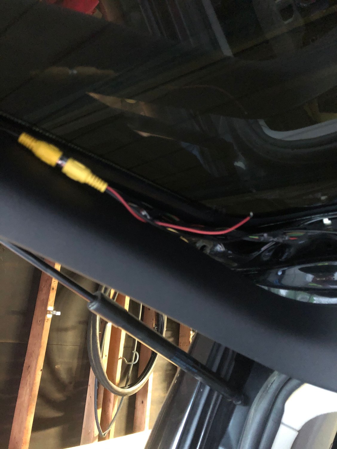

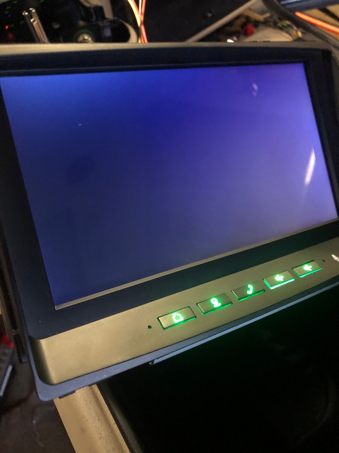

Default Purchased this, finally have the android turning on and booting up.
I purchased the same rear view camera and installed. The light turns on and I have the yellow video plug going from the camera to the special reverse yellow plug on the android unit but the video doesn’t come through?
Any advice?

You need to wire that red wire into a tail light reverse light.

Correct, the red wire goes to the reverse light. That triggers the head unit to display the rear camera input.

Or you could power it from up front and fit a switch so you can use it forward and in reverse.
