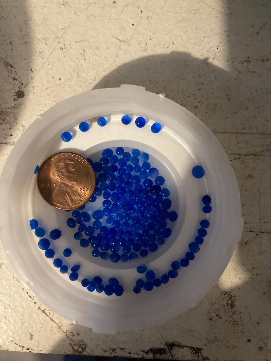

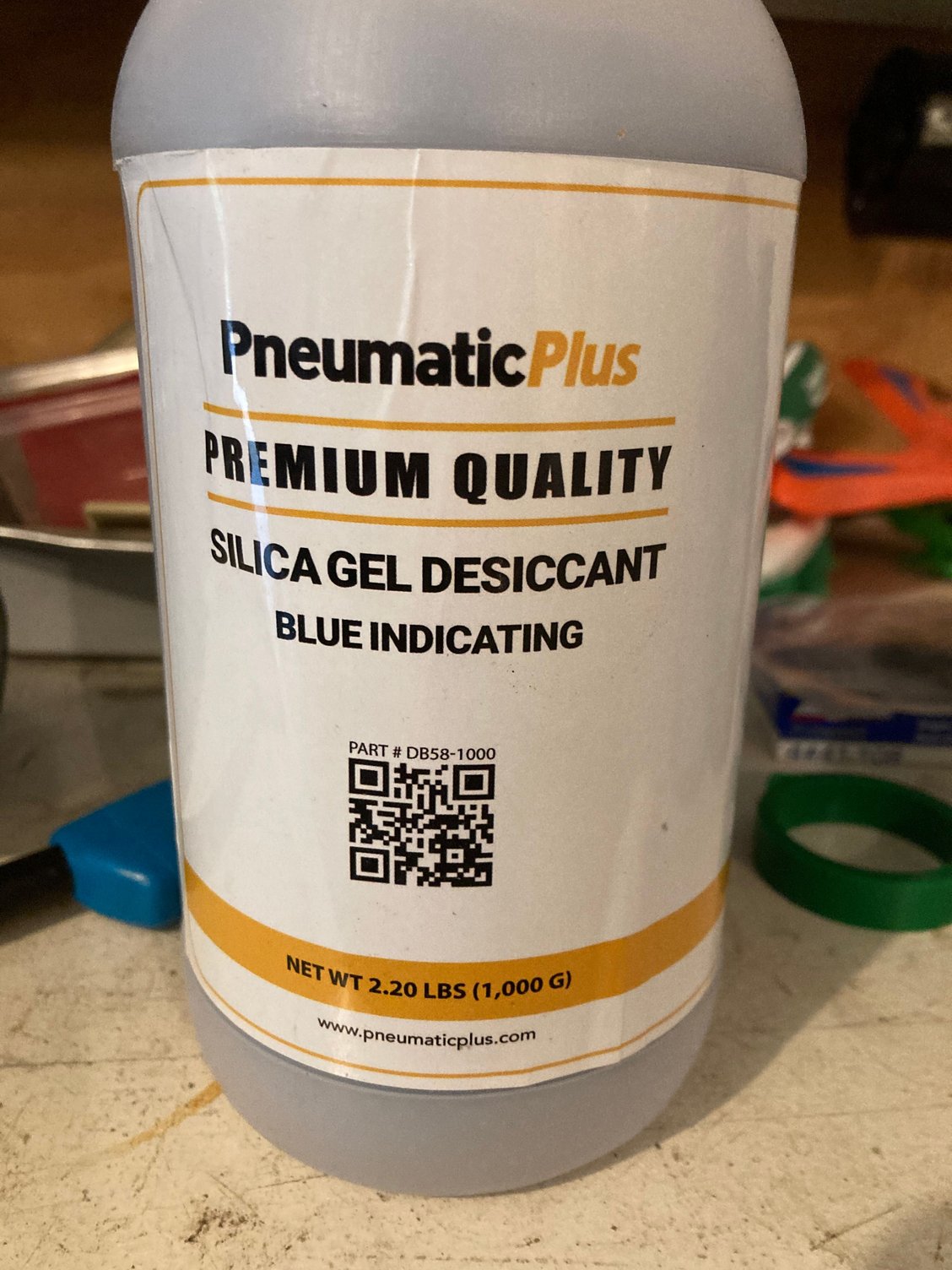

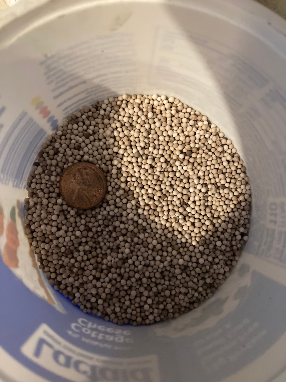

Just changed my desiccant. I’ve attached the photos of the old (beige) and new (blue). As you can tell they are quite different. I did a little research and the original desiccant appears to be molecular seive desiccant. The new is silica gel desiccant. the basic difference is the molecular seive is much more absorbent. I suspect the silica gel will require
Molecular seive desiccant
Silica gel desiccant
more frequent changes.
fyi my compressor and drier are of the AMK variety. Original to the 2008 vehicle as far as I can tell.
