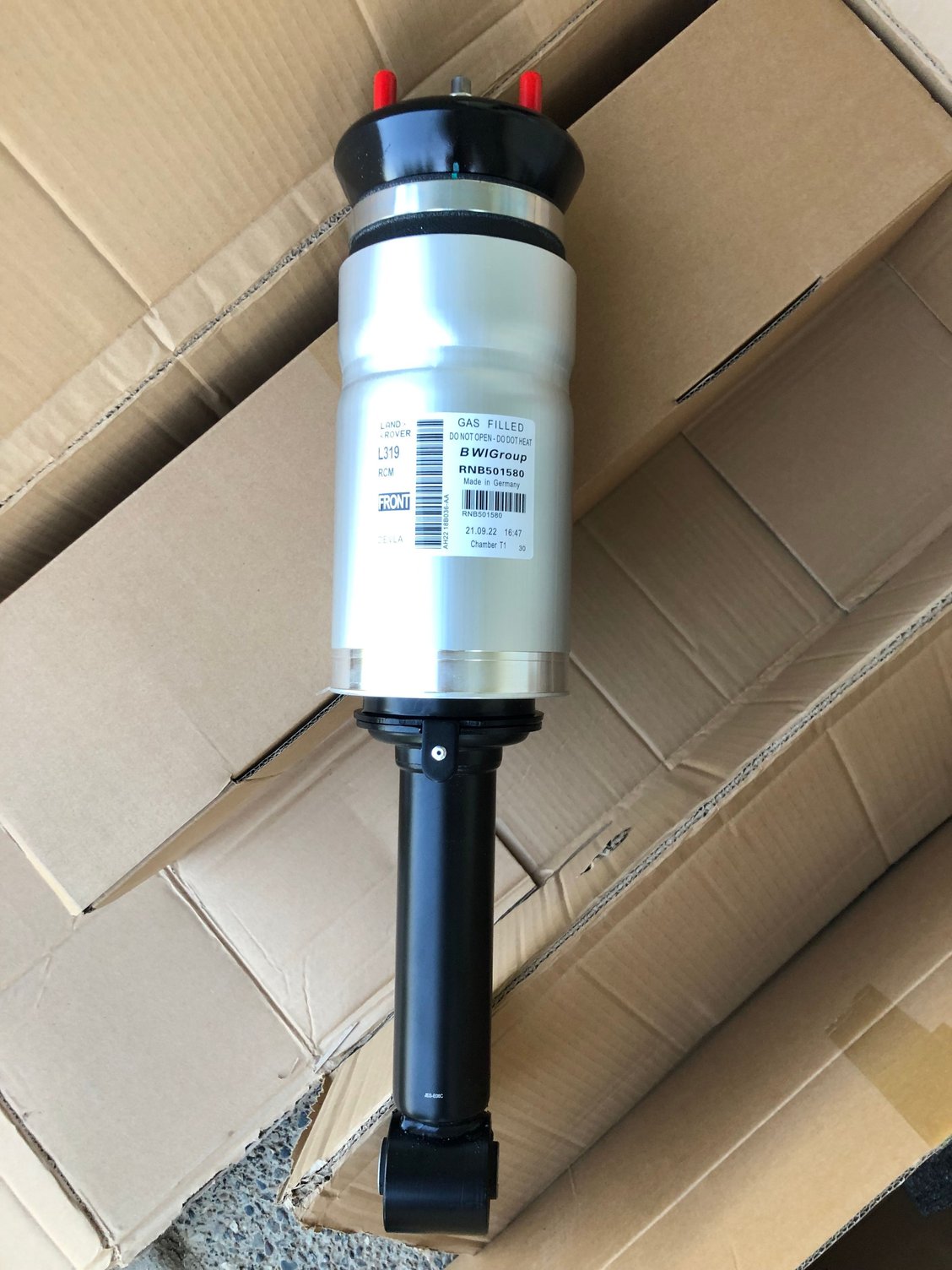

I received the “fakes” in the mail. Just want to make sure one more time that the consensus is they are fakes before I return them and call they guy a liar on the review. Pictures attached.

Well for one that white part number stamp is a classic for generic parts. But there is a SUPER easy way I can convince you they are fakes. Again, that label. Notice that it is identical to that in the auction - including the suppose time it was made. But you say, surely I simply got the set the photographed.... Nah, the struts done even match. First in the auction the labels are lower down on the strut. But the strut themselves are not even quite the same. The metal work at the bottom edge of the aluminum is not machined the same. So basically how could the struts they show and the ones you have end up being made at the exact same time..... 16:47 and same date..... And again if you look at other auction of "genuine", etc. You will see that same label with the same date/time/etc. Because that label is made in bulk to put on fakes. Real struts will have different dates/times of course because they really, really need to track that incase there is a production issue.
Now like I said before, they could still be very much better than what you have now. They just are not BWI or OEM by a long shot. The ride quality, you will not know until install. And the shock could fade fast going from a smooth ride to harsh quickly. It really comes down to how long you may keep the Rover, if you care and such. It is not like you paid for genuine at genuine prices.

Thank you Dakota. I fully trust you and appreciate the help. These will be going back. I know that I won’t be happy without OEM because I will always question what I have. Don’t know how long the river will last at 265k miles but it is running strong and I’ll keep as long as it makes sense.
