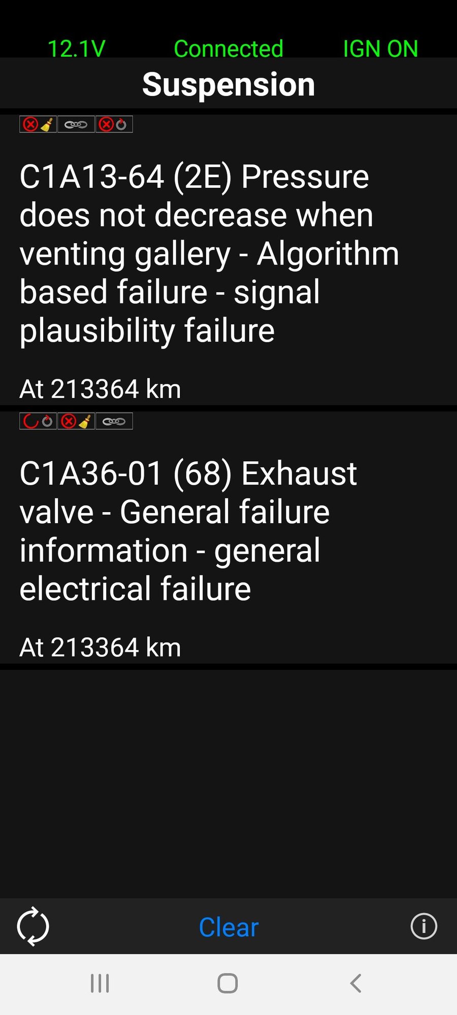

I have still not done the calibration on the suspension, but it is holding / maintaining normal ride height. Driving it daily.
I start the LR3 and there is an initial fart of air, then the compressor starts, runs approx 40 seconds and shuts off and farts again. I start to drive and I get a suspension fault and when I read the codes, I get as below in my screen shot. I am confused. I hear it venting, but I still have these 2 faults.
Any ideas ?
Old Jul 21, 2020 | 03:04 PM
  #90
Matthew Lord's Avatar
Joined: Feb 2020
Posts: 50
I had the top one. Rebuilt the compressor and how it's gone. But now I have other problems... I'd say that while you're getting the pressure release when pumping or raising/lowering you're getting a stuck exhaust solenoid on the compressor and possibly the compressor is caked with desiccant powder.
