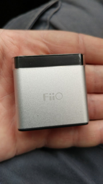

Didn't get the time to screw with this that I would have liked but the headphone amp showed up yesterday afternoon.
So it is a 80% solution. It has workable volume levels now. I went with a small one by FIIO sound quality is good so that is a plus. If I were going to do this over I would order the next one up as it has a bit more punch to the amp.
For now this will work. I have it tucked away in the dash, still need to clearance the ac duct plastic on the drivers side vent for the charging cable.
