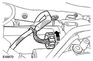

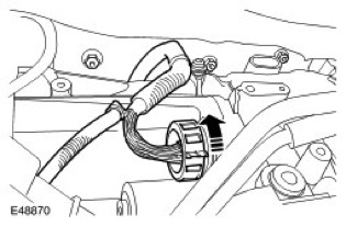

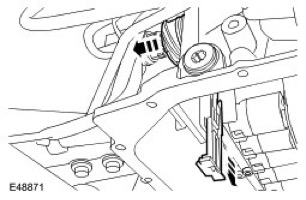

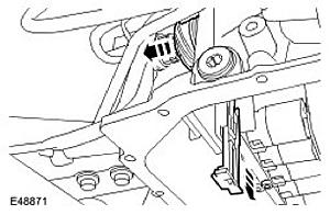

Raise and support the vehicle.
Remove the fluid pan. For additional information, refer to Fluid Pan, Gasket and Filter (44.24.04)(Section 307-01)
Disconnect the electrical connector. See right hand picture.
Remove and discard the electrical connector sleeve. See left hand picture.
Drain Auto gearbox oil and remove oil pan.
Release the sleeve retainer.
Remove retainer.
What these pictures do not show is the proximity of the exhaust pipe which adds to the difficulty of reaching the connector and sleeve. Nor does this description talk about how to remove the sump for this you should search on YouTube where there are some good videos.
