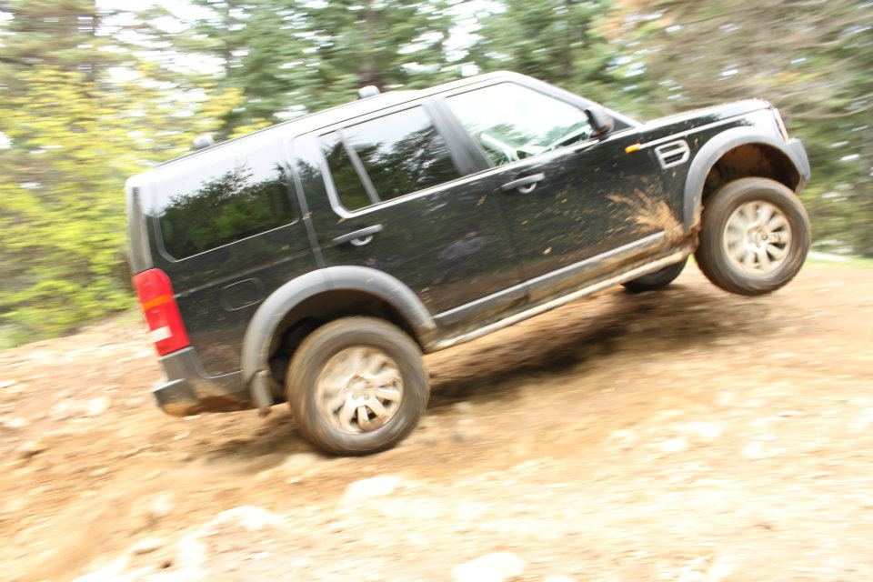

Not sure but my hunch is that your trade-off (width for diameter) may be okay with clearing the frame rail and the wire bundle if you've moved it (driver's side wheel well) but in the rear you will likely rub in the rear wheel wells in the FWD section.

I have that setup; however, right now I have the 19s with my winter tires mounted so I can't go out to the garage and measure for you, sorry man. Here is a pic though, that shows how close it can be. The tire is drooping in this photo but you can see the potential for interference.
Attached Thumbnails Anyone running 265/70/R18s?  Pics? Issues? Thoughts?-lr3-hogs-back.jpg
