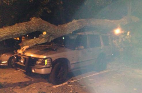

Hello to all,
I had a tragic death of my Discovery 2 while in Auburn this semester, pictured below. I am now getting my dad's LR3 and I cannot wait, I've always loved the potential that it has.

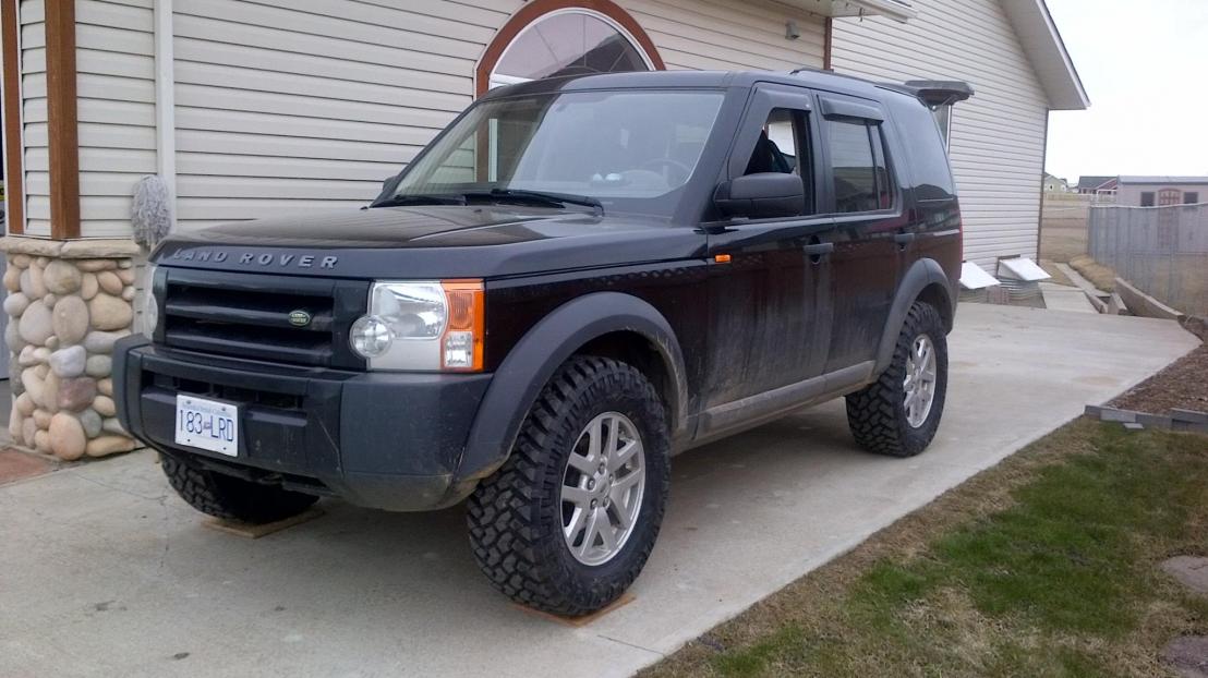

As I mentioned, the spacers will reduce or eliminate the hub centre mating surface and could potentially cause unwanted steering wheel shake, steering wander, vibration, uneven tire wear, loosening wheel nuts, and so on. Mine are only on the front and only 3/16" thick as that was all I was able to put on (without extra hassles like the studs not being long enough - I tried 1/2" first).
The width of tire was the first problem. The side lugs rubbed on the upper control arm in the front. Once I got the spacers in I noticed the tire would rub the mud guard liner in the rear wheel wells, and that was when I discovered the coolant lines that run to the rear heater. The attached picture shows plywood under the tires as I was constantly turning the wheels left and right to check my clearances the day they were installed and I started trimming.
But with all the negatives, I did pay $2,000 to purchase and install them, and they change the look of the LR3 from 'soccer mom' to to 'hard core off roader' without having to change anything else.
I will definitely have to down size on my next set and lose the aggressive look.

Dang, that looks amazing. I've never seen those rims, reminds me of the hurricane rims on the D2 I like those a lot, look great. The whole car really looks great. I keep seeing lifted LR3s and I keep getting more and more excited about mine. I finished up some late night additions tonight, and I'm waiting for daylight to take pictures so I'l post them tomorrow.
Thanks for the update on the tires as well. I have just found a good price for 31.75" goodyear wrangler duratracs and I'll be going with those because they look great and they're great tires.
All that being said, your LR3 is defiantly one of the best lookin ones I've seen, props to that.

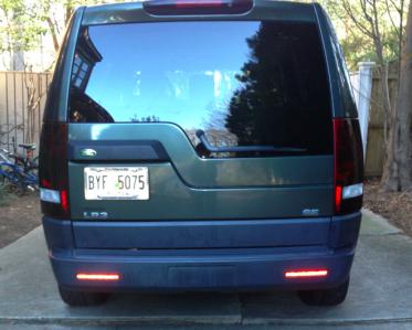

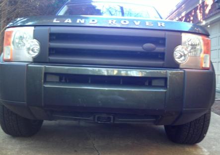

First two additions are on:
Blacked out Taillights and Grill

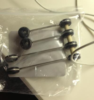

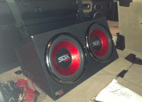

Subs and Johnson rods came in. I'll be putting the Johnson Rods on once "Santa" gives them to me and I'm on the way to purchase the amp for the subwoofers.

Hey man...I don't even know how much Johnson Rods are these days, but to me a much more effective use of $-resources is to get the IIDTool and use it to achieve your lift. It costs more money but it also allows you to read/clear faults and calibrate various systems including suspension.
I had modified rods and resisted the IIDTool for a while even after I owned one stating that I liked the "hardware solution." Once I decided to just use the IIDTool I have never looked back. The biggest benefit is that I can cruise around at stock height settings with my 32" MT/Rs on if I want to and just change to the modified higher settings once on the trail.

Yup, I was set on the rods as well but after thinking about it, it made no sense to get both. The iid takes care of it all at a reasonable price. It's nice to drop it down a little on long road trips and jack it up when you get to the trail.
