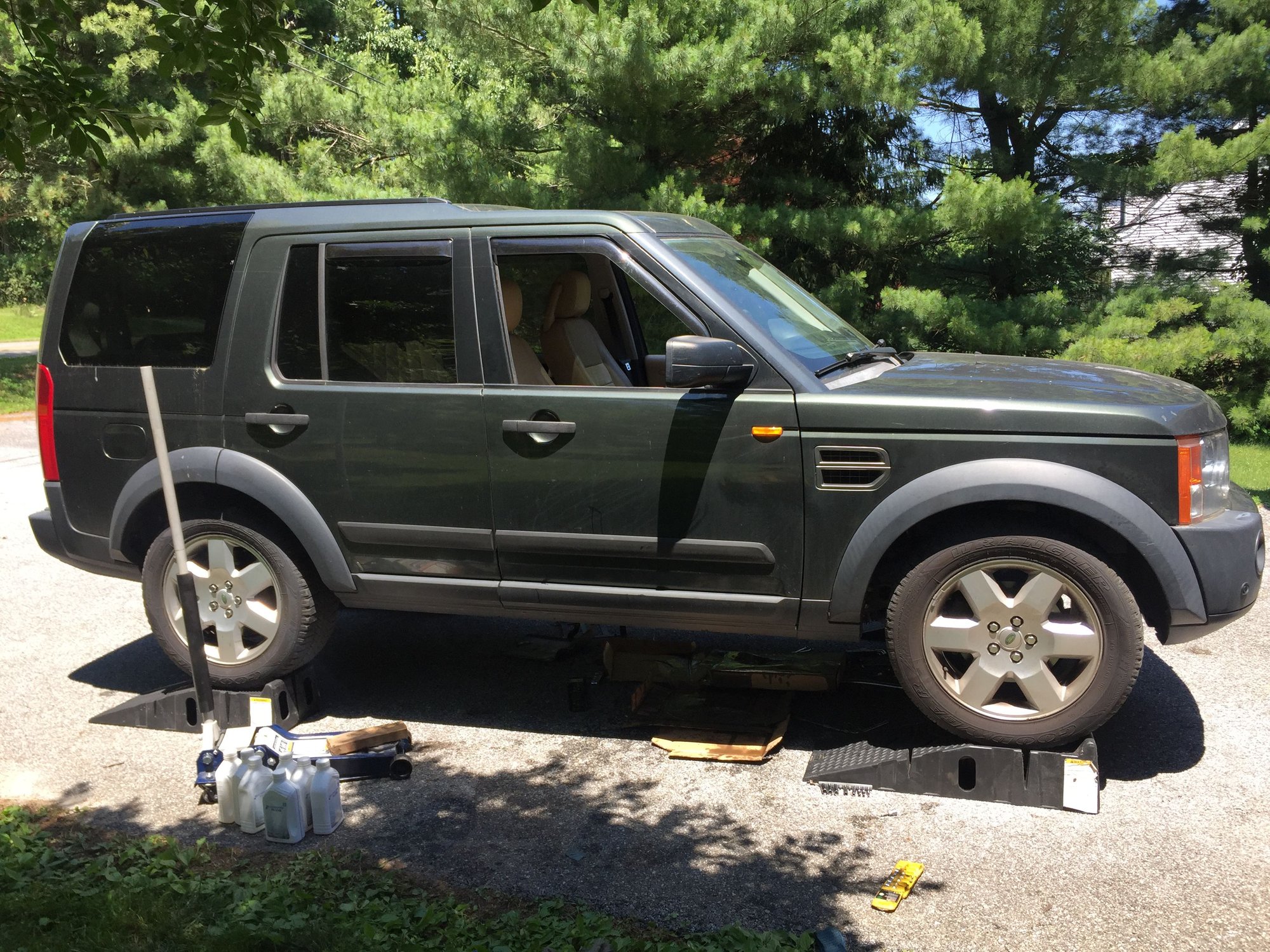

Got a pile of goodies from Atlantic British for 100K service. New pads and rotors on all corners, accessory belts, spark plugs, transmission pan, filter, and fluid. The two piece transmission filter kit makes the job seem a ton easier than previously demonstrated.
Should be a good weekend!

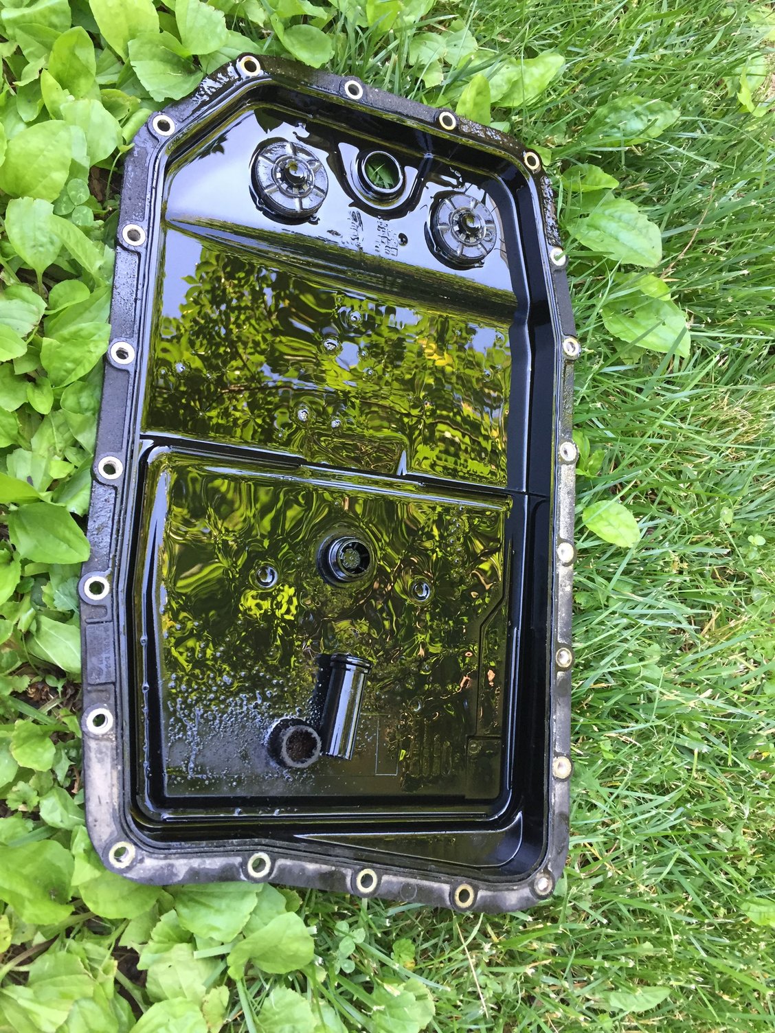

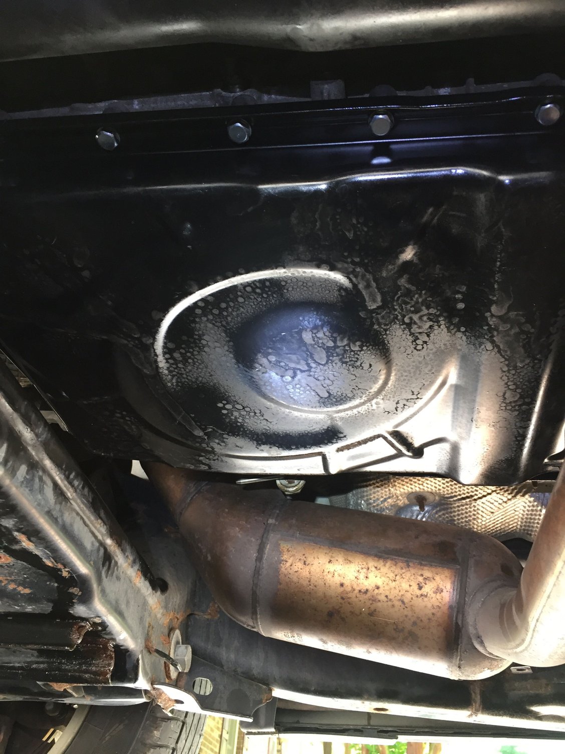

Pan is out

New filter and pan pan are in, fluid topped off and no leaks. The hardest part was getting the plastic housing back into the top of the trans housing.
Make good note on the way you take the pan out (which way you twist). It goes back in the same way.. but if you try and reverse the twist you are in for a wrestling match.
Watch the AB install video a few times and have it handy when you do this service and I would say it's doable for most DIY wrenchers. It took me just over 4 hours to do this in my driveway using ramps.
