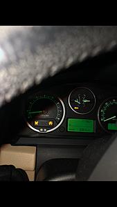

Hello, New to this forum and site... I am a college student and bright my LR3 from Denver to Tacoma. recently these three lights on my dash lit up (see photo) and would occasionally turn off. when they are on my car rides extremely low and bumpy (due to the suspension being lowered) has anyone else had this problem or know what is wrong and how to fix it?? thanks!!

Do some searches on this forum, you're bound to find something that helps. In the meantime, check your brake lights and tail lights. Believe it or not a burnt one (or the wrong one installed) can cause this. Next try the brake switch. Cheap part, easy fix. If it's not those it may be a wheel angle sensor; how is the alignment?

Low battery voltage can also cause those lights to come on.
