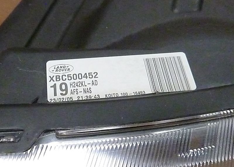

Here's an image of the part number decal on a left xenon with adaptive. NAS is North American spec. There are 3 types of headlights for LR3's that I know of for North America. Base Halogen, Xenon w/o adaptive, Xenon with adaptive.

Taking a survey of how many HSEs are or are not equipped with adaptive headlights is not very scientific. Alex, your two HSEs didn't have AFS, and both of my current HSEs do. The only thing we can say is that no SE models have it. Also, another good way to see if it's so equipped is to start it up and turn on the lights immediately (and make sure you're aimed at a wall or something so you can see) and look for the headlights "doing a dance" at the onset; that's the AFS calibration. Happens every startup, even when the lights are off....just easier to see when they are on.
