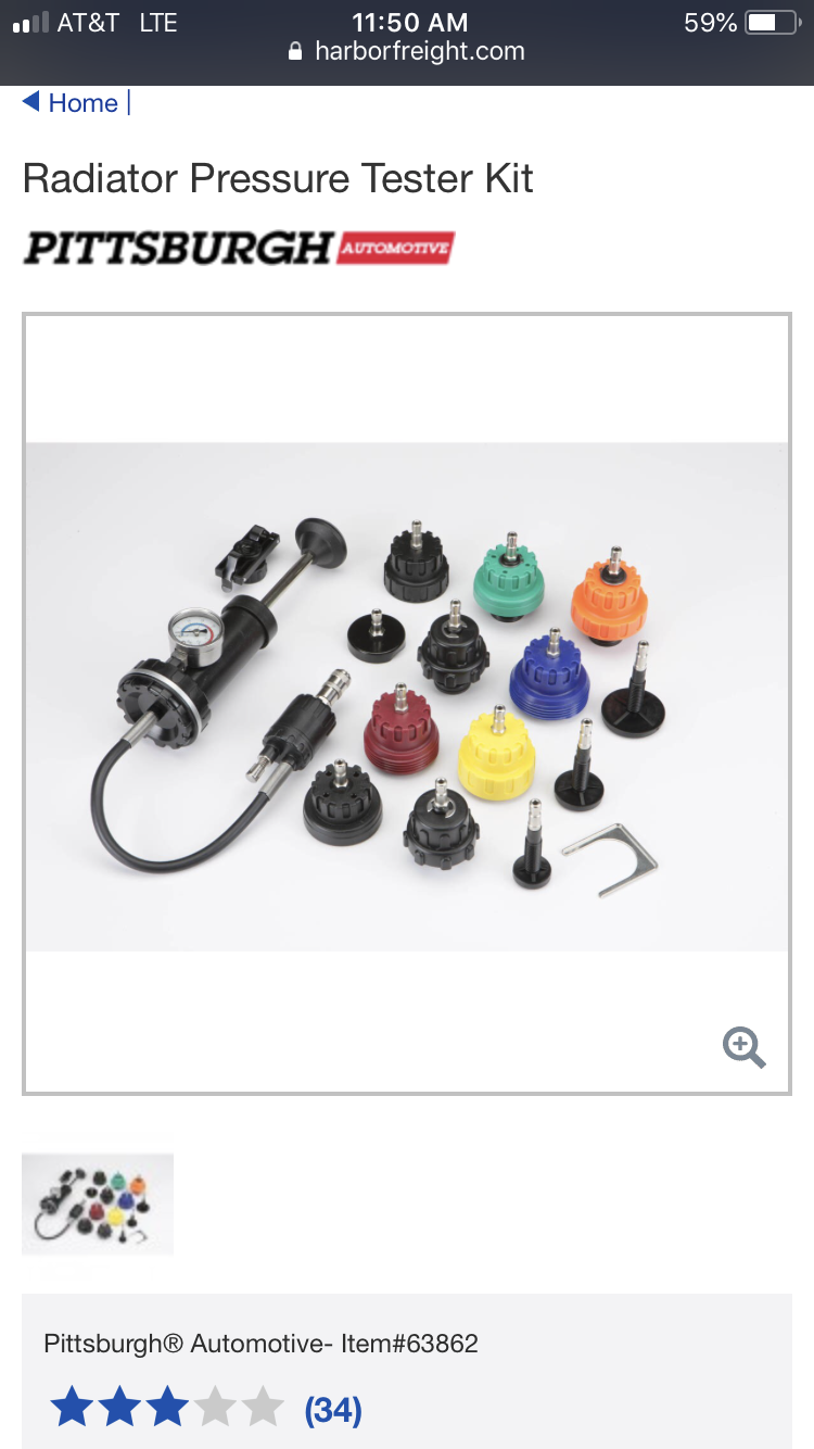

Pressure test the cooling system to find the leak, harbor freight kit has a cap that works.
One of the black caps is the right one.
https://m.harborfreight.com/radiator...not%20provided
