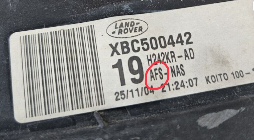

You can upgrade from Halogen to Xenon plug and play (and changing CCF if you don’t want lights to flicker at start).
You cannot upgrade plug and play from Halogen or Xenon to Xenon-AFS, that will require AFS ECU.

No, that one should be fine (HID = xenon) and you can replace your halogens with those. 👍
The ones you cannot upgrade to directly is HID AFS. AFS means the lights can swivel left and right when you turn the wheel at certain speeds.

This one will not work for you.

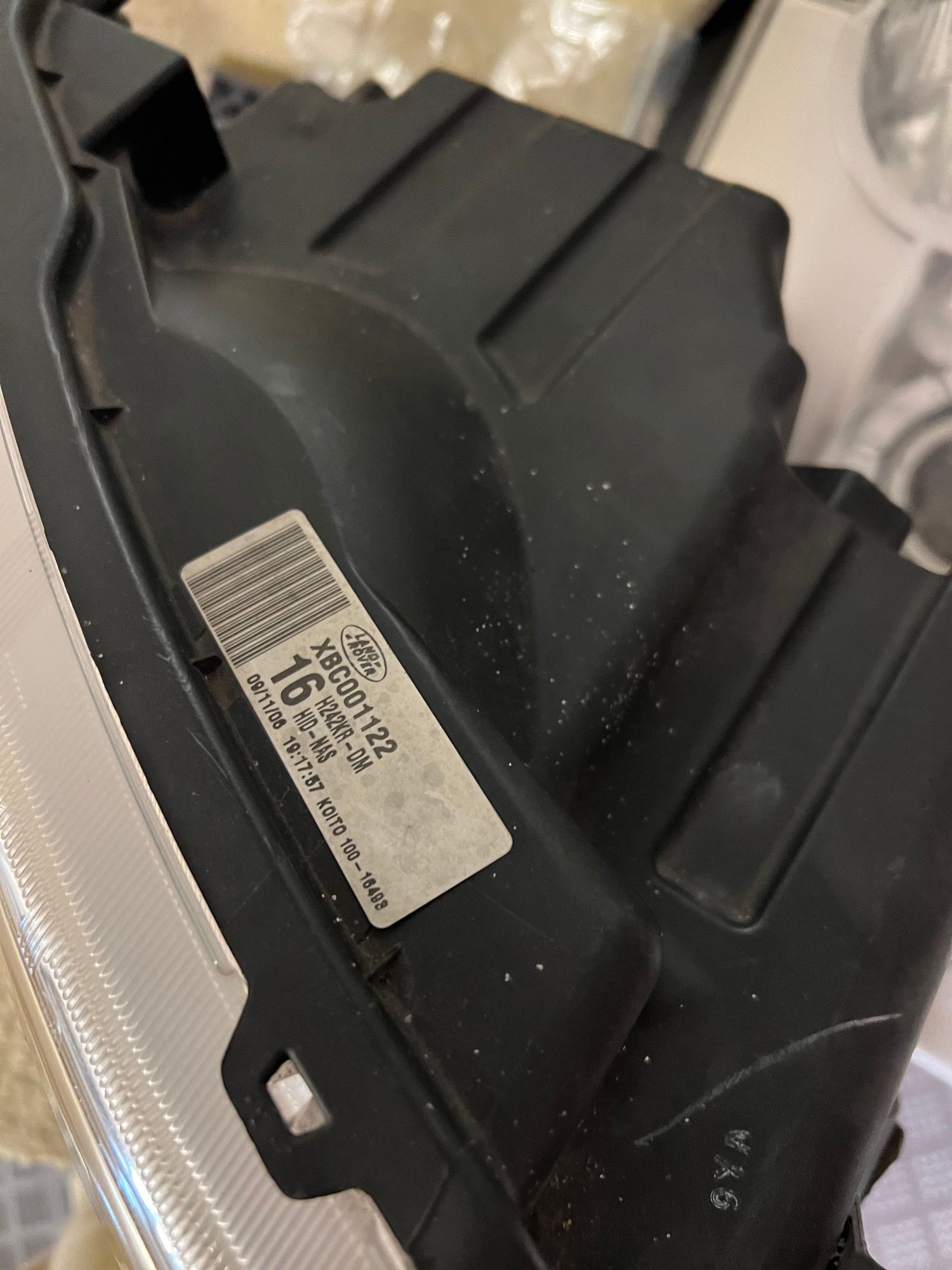

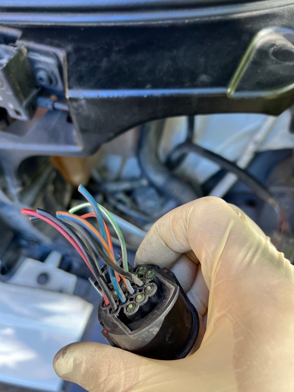

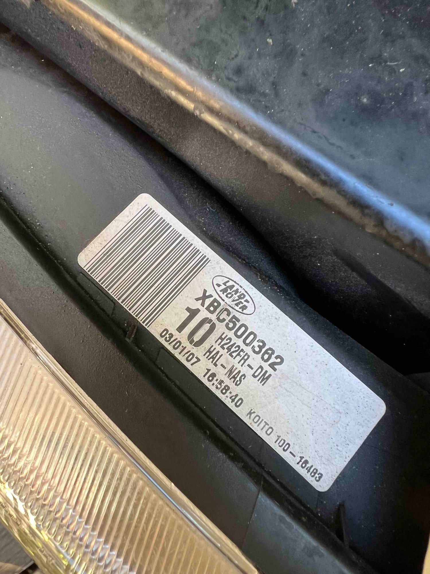

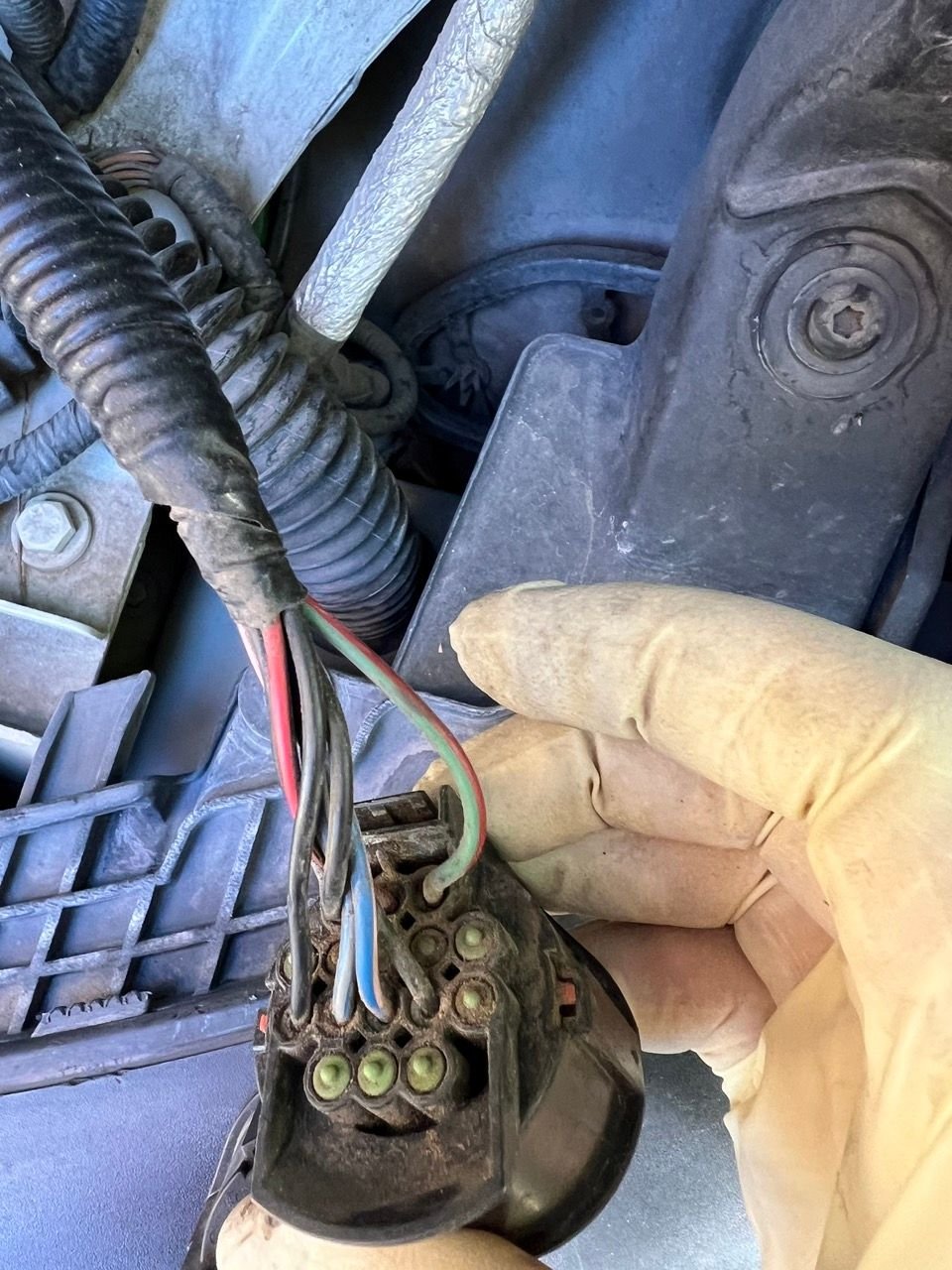

Follow up question --- I bought used HIDs off ebay to replace my HALs and installed. The headlights come fine on but the turn signals on the new front light assemblys dont work, just a fast blinking. Thought it was a bad bulb but changed them and still same issue. I then noticed that the wires on the plugs on the car (LR3 07 SE) are 7 wires, whereas the HIDs had a cutoff old plug included that showed 8 wires. Is the wiring the issue or perhaps I need to reprogram the car with the an IID device to Xenon? (IID device coming today haven done yet). Or do I need to splice some wires? Pics attached, any help most appreciated.
Original lights on car
ebay purchase
This wiring harness came with HIDs from ebay
This is OEM wiring on car

Huh. In Europe it’s plug and play. I glanced at the wiring diagrams (you can download yours here: http://rave.stringsandints.com/LRL18...R3-Wiring).pdf) and it didn’t seem like turn signals would have something special for NAS.
Just to verify, you used W5W bulbs, not LED, right? I ask as fast blinking tends to mean that the vehicle thinks there is a fault with the lights.
