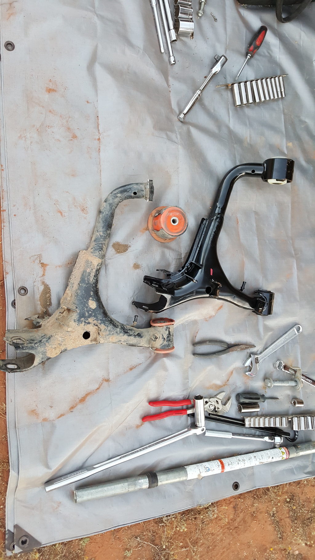

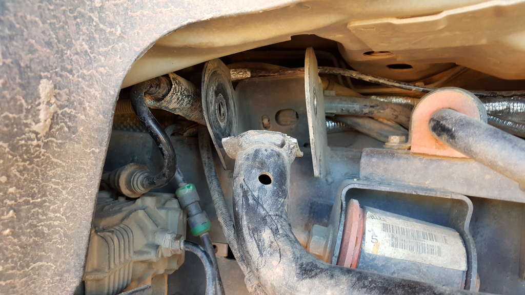

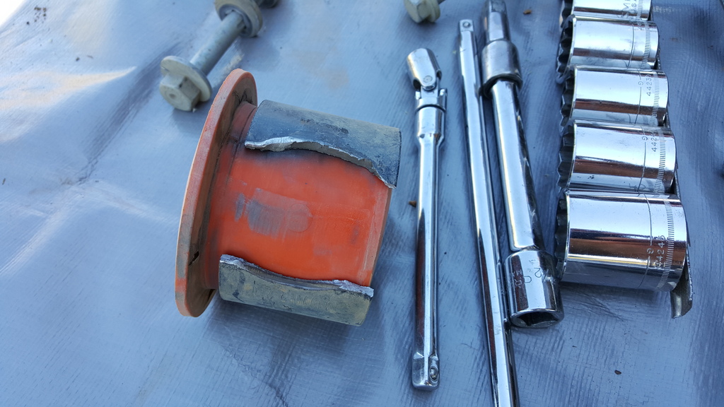

To the point, when I broke a driver's rear upper control arm (at the fwd bushing) I had a clunk similar to what you're describing. Of course, I noticed it in high range as once it failed it was pretty obvious.

Actually I suspect it went something like this: Last year on Deer Valley I broke a front strut. (I've written about that before - Arnott part that has since been redesigned). I imagine that and some other rock crawling trails stressed it pretty good. Then when I went to Sedona for the WNLRR I took the Back way to Crown King trail and since I wasn't traveling alone this time I took all the hard lines for fun. I believe this probably cracked it but didn't cause total failure. On the drive from the trail to camp outside Sedona I flat towed another Rover w/trailer maybe 5 miles as well - more stress. Then the next morning heading from camp to Jerome for some trail time I ran a lot of washboard that probably vibrated the crack into complete separation. At least that's when I started hearing the clunk. It only took a few minutes of inspection to find the problem. I eased it back to camp and arranged to have a new stock control arm brought up from the dealer in Scottsdale by an AZLO member who was coming through and replaced it later than night so I only lost one day on the trail.

And no, I don't think the poly-bushings caused it.
