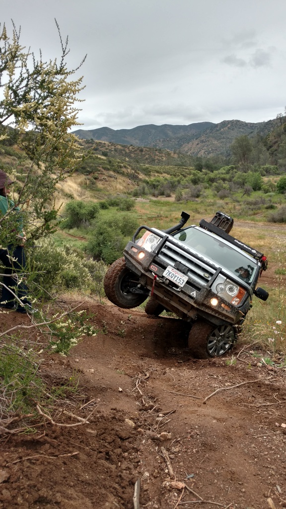

So in that specific instance I actually made the climb prior to Volkov doing it and did it pretty easily. But I have mores tire than he does these days, so I think more than anything that was a statement of new 33" Cooper STT Pros vs half worn 31.5" BFG KOs.
The hill wasn't very long but was fairly soft dirt with a bit of mud on top so the STTs got to dig in and keep me going. There was a turn at the top that needed to be taken wide to avoid dropping into a fairly deep rut on the down-hill side of the turn. Since I did it in one clean pull I didn't have any problem driving around the rut. Volkov started up the climb, slipped a bit, (pause while I make 'fail!' comment over radio) then engaged his locker and kept on going. As he approached the top where the turn was he stopped again to disengage the locker since turning with a fully locked front is tough.
That's where it went wrong. When he tried to get moving again he slipped sideways and fell into the rut which tipped him a little too far for comfort. I think his passenger front wheel was only about 2' in the air. Luckily I was able to take a different line to the top and act as an anchor so he could winch himself out of the rut. He barely winched a truck length - just enough to get out of the tippy spot, then he was able to keep going under his own power.
Here's a shot of Volkov conducting a lateral stability test.

Volkov....man that photo looks pretty scary! Especially with you "turning uphill."

Since Volkov is out at OE I'll again answer for him - he couldn't really turn downhill there. You can't see it from that angle but he's about 2" away from putting his driver's side sheetmetal into the side of that rut. Even better, once he dropped into the rut and got tippy he dropped the suspension back down to access (as seen in that pic) to lower his CG. So he was sitting a little higher when he first went in.

Good thinkin' on his part! The one time I was in a remotely similar situation (and waiting for winches to get hooked up while I was trapped in the car because of a stump outside my door) I'd completely forgot that I could lower the damn EAS and make myself feel a lot more comfortable. Doh!

So Overland Expo was awesome for starters. Second that picture of me on the hill turned out awesome, but it was a little bit scarier from the drivers seat.
