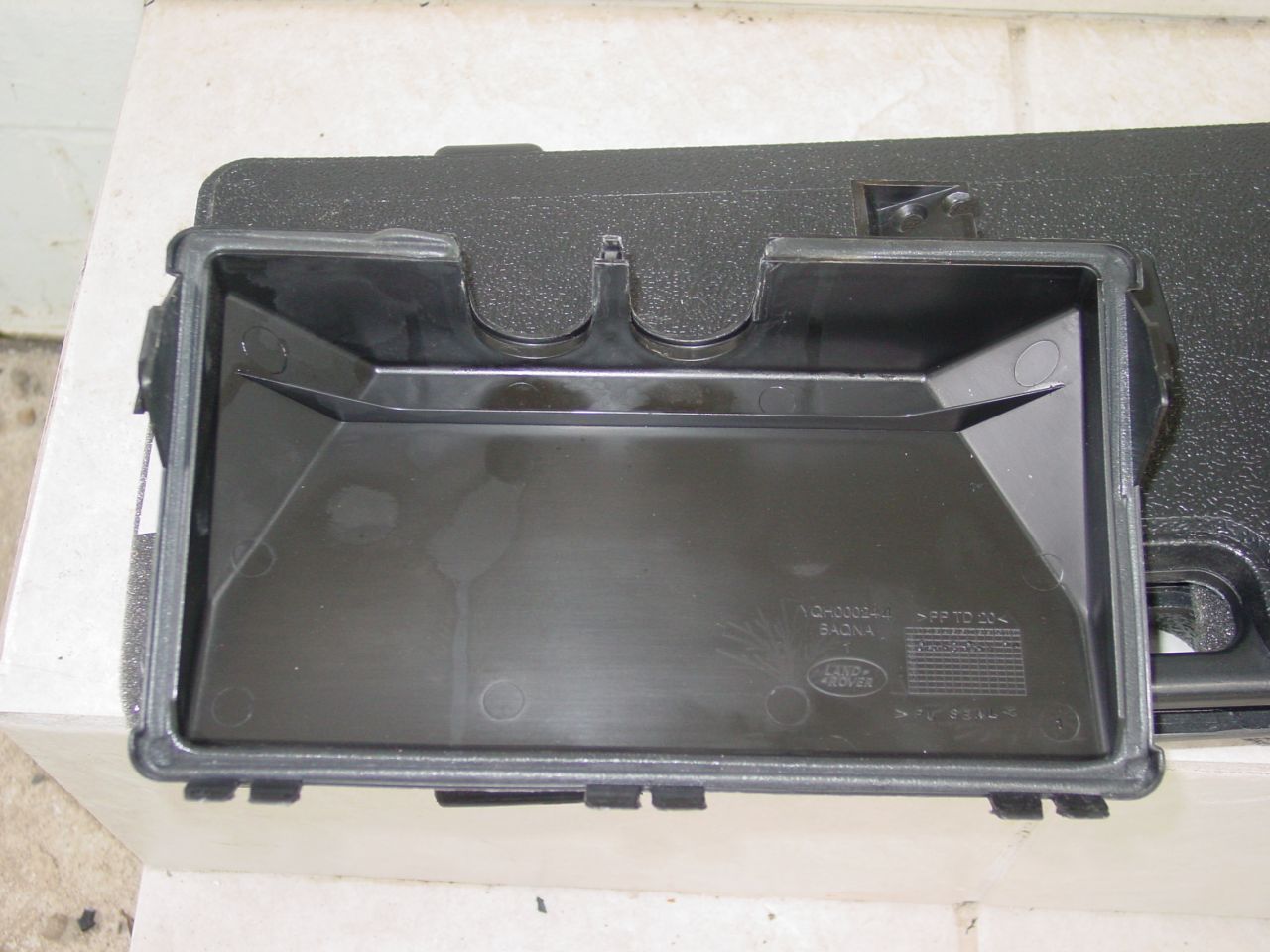

Default corroded pins going into tranny computer
This is a cheap fix if it works and if it does not, still costs nothing.
It is common for the electrical connector pins on the top of the ECU to lose connection due to corrosion, either from rain/car wash water or battery fumes. Also I am certain your tranny computer is OK, just not getting good signal. It is rare for any of the pcb stuff to fail - except for the key fob pcb where the solder joint cracks that ties the rechargeable battery to the board.
Corrosion is the primary reason LR provided the battery vent hose per the jpg's below - to direct battery fumes away from the nearby electrical.
I have a dual battery setup and the aux battery jpg shows the hose better, but the white elbow on the main battery is also connected to a factory vent hose.
If you do not have the vent hose connected, then the odds are that over time, battery fumes have got at the tranny computers connectors.
The other jpg's show the tranny computer located behind the battery and with the cover off exposing the connectors. Also note the black electrical tape wrapped around the top of the rubber boots. This is an attempt to tighten up the top of the boots to keep rain and car wash water from being funneled to the connectors. The only way to keep battery fumes away to via the vent hose.
I think the reason your 3 eventually starts is that like all corrosion problems, they are not instant or overnight. Corrosion starts small and builds over time. The fact the engine starts etc means that power is still getting thru, but in minute quantities, hence the time delay for a charge to be seen at the pcb.
Also if you have not replaced your brake light switch, do so. That is twenty five dollars and solves more problems than you can count. In your case, I do not think the brake light switch is the primary problem but it can be adding to it. Normally when the 3 quits due to electrical problems, there are multiple problems to be resolved.
Also check your brake and tail light bulbs for operation. A burned out filament can drop across the second filament and throw the 3 into tranny fits. I recommend factory dealer bulbs, not far east sourced bulbs. Those far east bulbs can just to too expensive due to the problems they will cause the various computers.
DISCO3.CO.UK Photo Gallery - Brake Light Switch Replacement
Attached Thumbnails Computer nightmare!-imgp0441.jpg   Computer nightmare!-main-battery-hole-cable-5.jpg   Computer nightmare!-lr3-transmission-module-case.jpg   Computer nightmare!-lr3-transmission-module-cover.jpg   Computer nightmare!-lr3-transmission-module.jpg

Actually, on the thread I started after this one regarding the problem of it not starting/running someone suggested pulling the controllers and checking them over...
So yesterday when I was down here at work messing with it, I took the time to do that.
Pulled both and checked them over pretty carefully. All the pins are in very good shape considering the age of the truck... all but the very tips of the pins were nice and shiny and not showing any corrision I would be at all concerned about. The cases of both controllers look very clean and the connectors are firm seating, don't move around and the wiring to them appears to be in pretty decent shape. no obvious crimps or anything visible really.
Also, seen the stories about the instrument cluster being a problem with the CAN bus(s) so, I took the time to pull it out of the weekend too, cable was nice and firm, looks in good shape... So don't think that's the problem...
I am just running a single battery setup, but the vent tube has always stayed hooked up and routed FAR away from anything sensitive... I have always been very careful about that, cause yeah, what havoc can be caused by the stupid battery exhaust...
Actually did check over the brake lights and everything is good there, pulled each one and checked it to make sure and they all look good.
The brake light switch is however something I have not done... So I am sure that it's time to swap that out.

Default Battery venting!
Originally Posted by DavC
Bruce,
Can you go into more detail Re: the vents? is this a DIY thing to add to the battery?
Regarding venting of the battery, and do it yourself, yes and no.
The LR3 in its stock form from the factory in the UK came with a CaCa battery internal design installed with a built in vent hole on each end.
The vented end closest to the cowl was plugged off with a cap, and the end closest to the grill had a 90 degree elbow to which was attached a suitable sized rubber vent hose about five feet long that ended near the battery side fog light within that corner bumper black plastic.
The idea was that battery gases would exit thru the hose down to the front bumper as that area is all plastic without much wiring. The thinking was that battery gases would not do much damage there; at least less damage than if they exhausted near the tranny pcb board.
I mentioned the blank off cap on the cowl end of the battery for a reason. If the cap gets blown out, then guess the route the battery gas takes - the easiest, and the nice hose vent set up is just there for the ride.
Since my Traxide auxiliary battery install is not factory Land Rover, I then had to add the hose venting myself when I did the install. The good news is that USA sized windshield washer hose parts generally fit; 3/16" if I recall correctly but whatever it takes, the size is determined by the OD of the battery vent. I also vented the hose into the front bumper near the fog light.
Some guys are now installing those Optima Spiralcell type that I think do not have any vent holes. As such, I suppose the gas problem is resolved with that design, however they are not my favorite starting battery for a 3.
I guess I am biased towards the older CaCa design Interstate that yes, it gases, but the internal regulator within the Denso alternator was designed for the CaCa charging characteristics.
