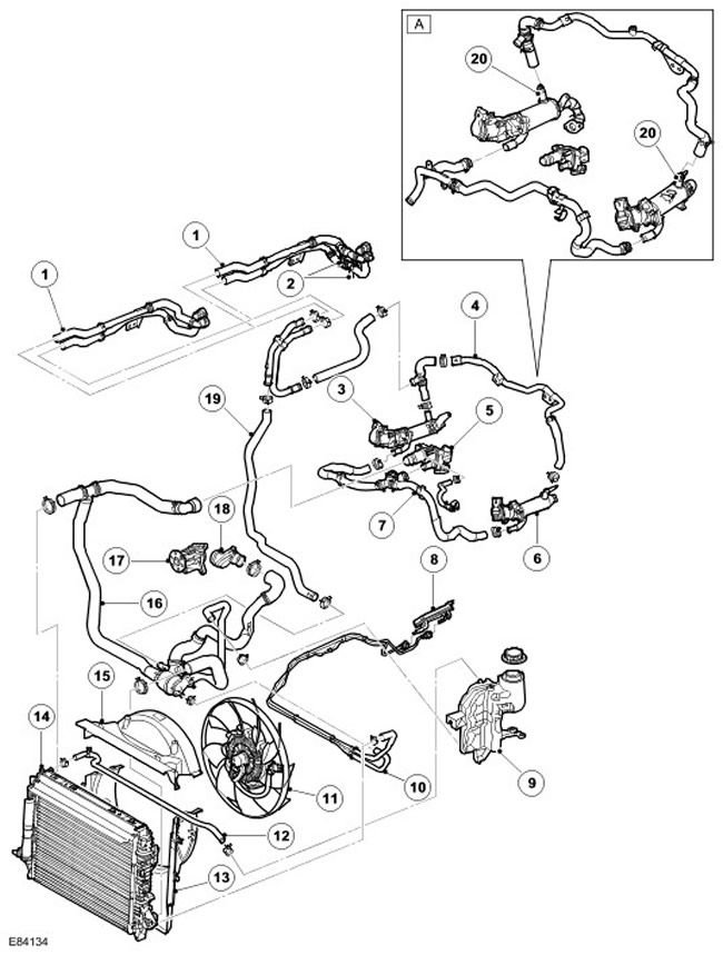

I'm from Poland, Land Rover from Germany, which element in the diagram do you mean? https://www.lrman.ru/img/disco/2287.jpg
Item number 5 on the diagram.

Where is he located? at the back of one of the heads?

No, right at the front under the intake Y piece.
