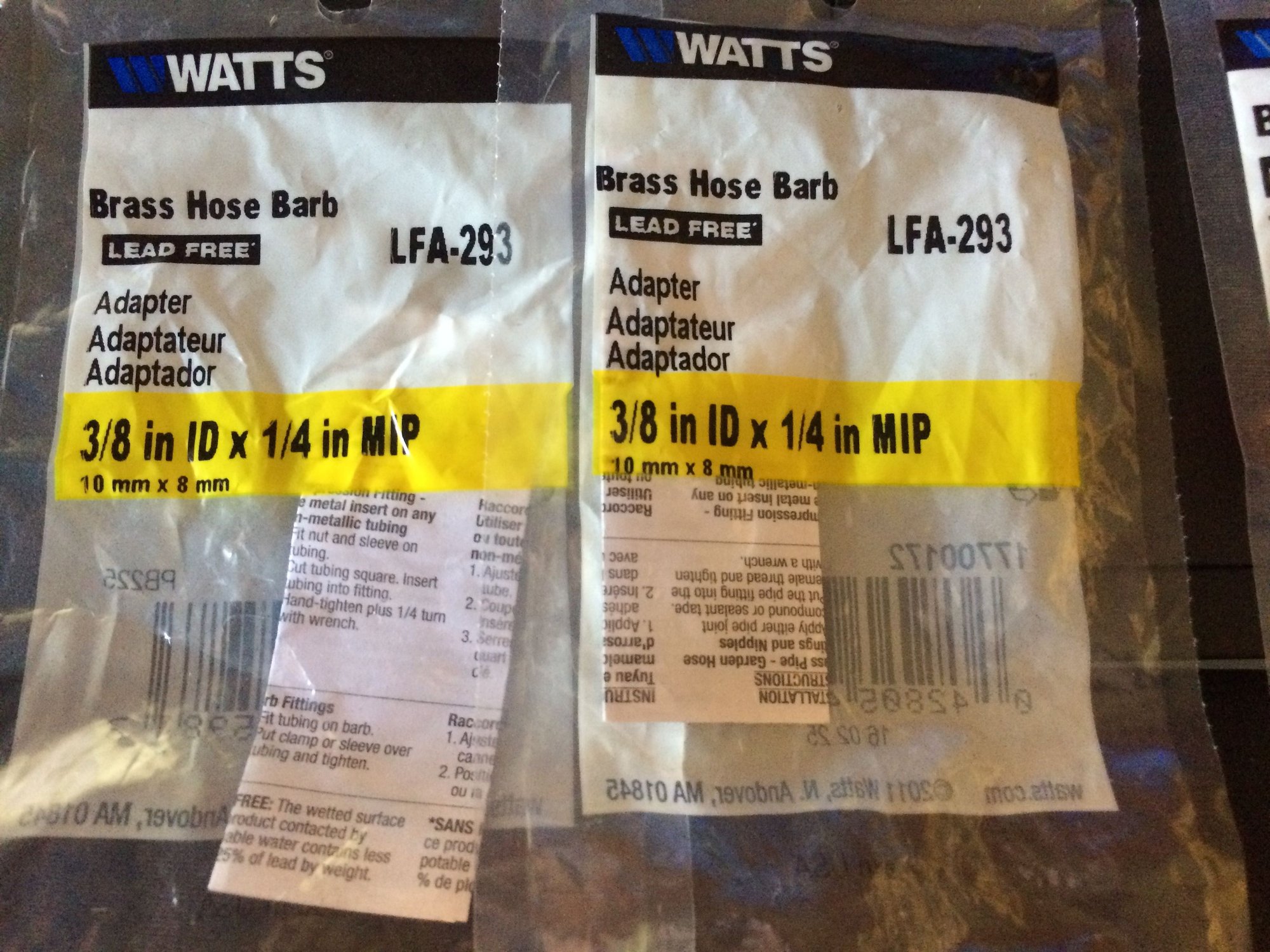

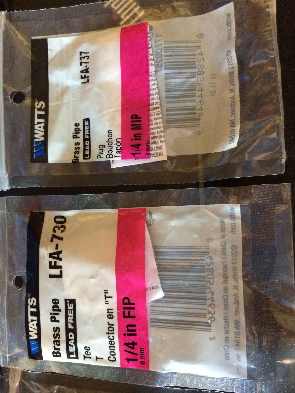

My Bleeder T valve broke into little bits yesterday (Saturday). Fortunately, I was close to the house before she heated up. I have an 06 LR3.
No repair shops or parts stores open on Sunday, and needed the truck fixed asap. Went over to Home Depot and bought (2) 3/8 X 1/4 Barbs, 1/4 T connector, and 1/4 plug.
Seems to be holding up just fine.
