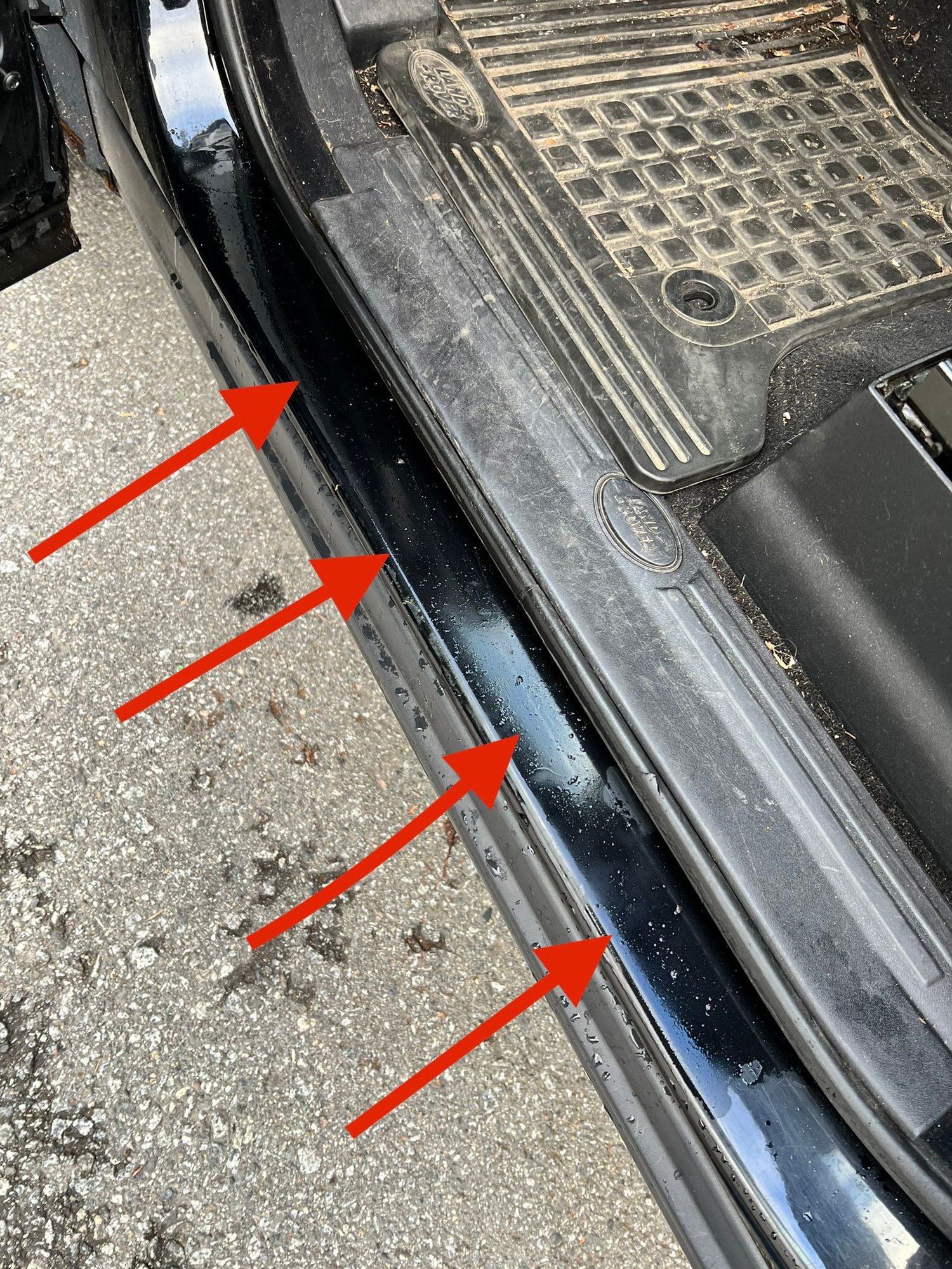

The big one that is puzzling me is why is there water under the door sill and in the door jamb when I open the drivers side door?
See attached photo and arrows. Am I missing something obvious?
Water pools under the door jamb. When I open the door water is where the arrows point.

Did you pull that LR logo stamped sill plastic plate to verify no water below it? But usually if I see this it is after a car wash. I have also see it when the upper door gutter seal is damaged missing. This is a seal that runs from the mirror and all the way above and over both doors to the back. If missing too much water gets between the outer door seal when raining, especially when driving since it can easily work its way past.

The carpets and area below are clean and dry. Must be the seal around the door, as there are bits missing.
I will investigate further.

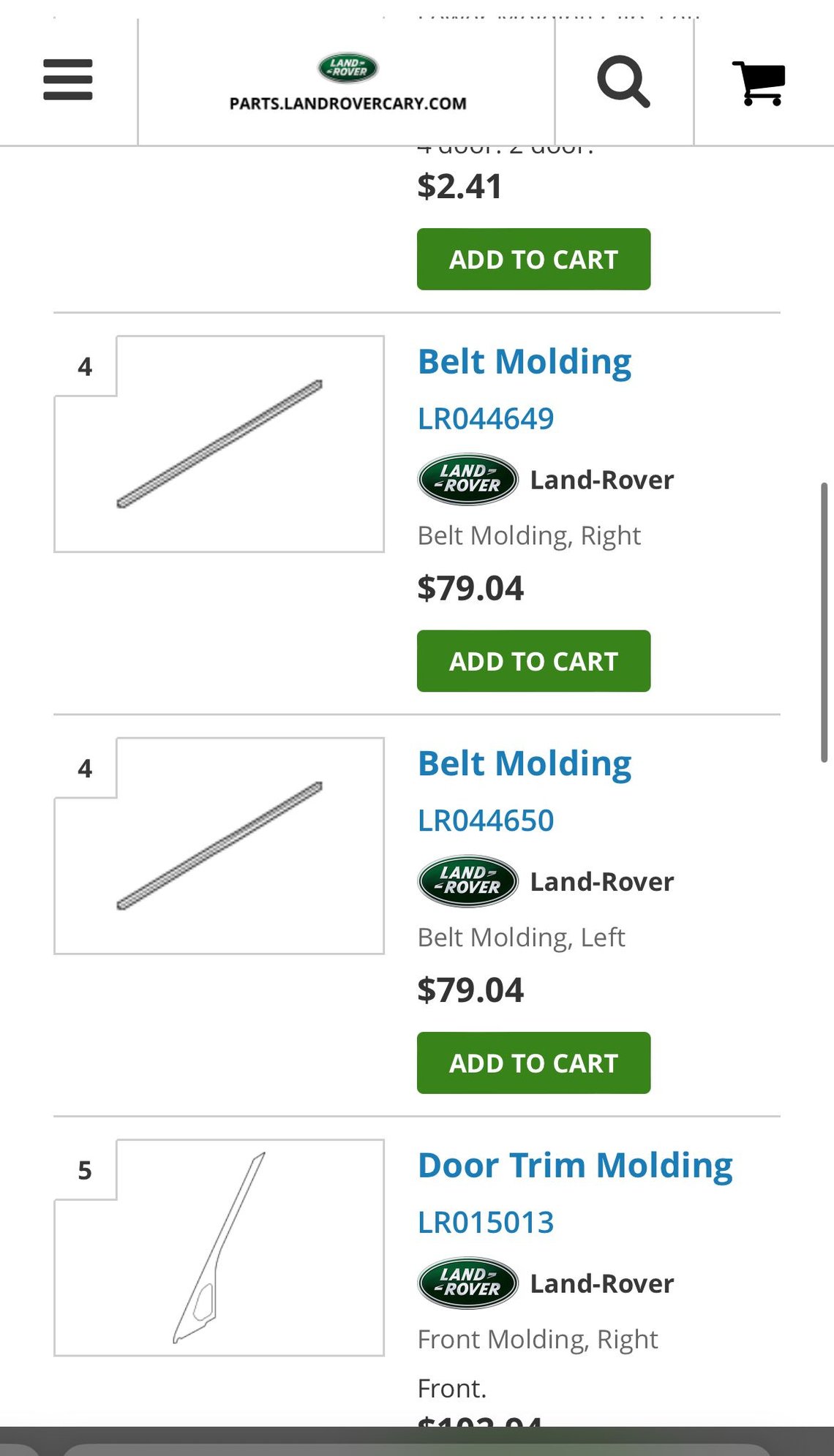

Check if your door has drainage on the bottom. If it does, is it wet? if it is, then your outer belt molding maybe damaged or worn. Water maybe getting in between the belt and glass. Check your weatherstrip, Your door shell and uniside opening should have no contact with each other besides the weatherstrip sealing the opening from the elements. The door shell also has weatherstrips, check those as well.

Timing is everything. Last night I fired it up, took it for a spin, dropped the drivers door window and upon winding it up, it was wet on the glass.
Do you have diagrams to the mentioned parts to check inside the door?

I think I found the parts as per the image below
Land Rover LR 3 / Discovery 3 Belt Molding part numbers

Weather molding is my next fix as there is moisture inside the door as confirmed when rolling a dry window down and it comes back up wet.

Appreciate your enthusiasm, but, @aljpro2000 has provided insight into why there is moisture in the door. Once I have replaced the part referred to I will report back.
