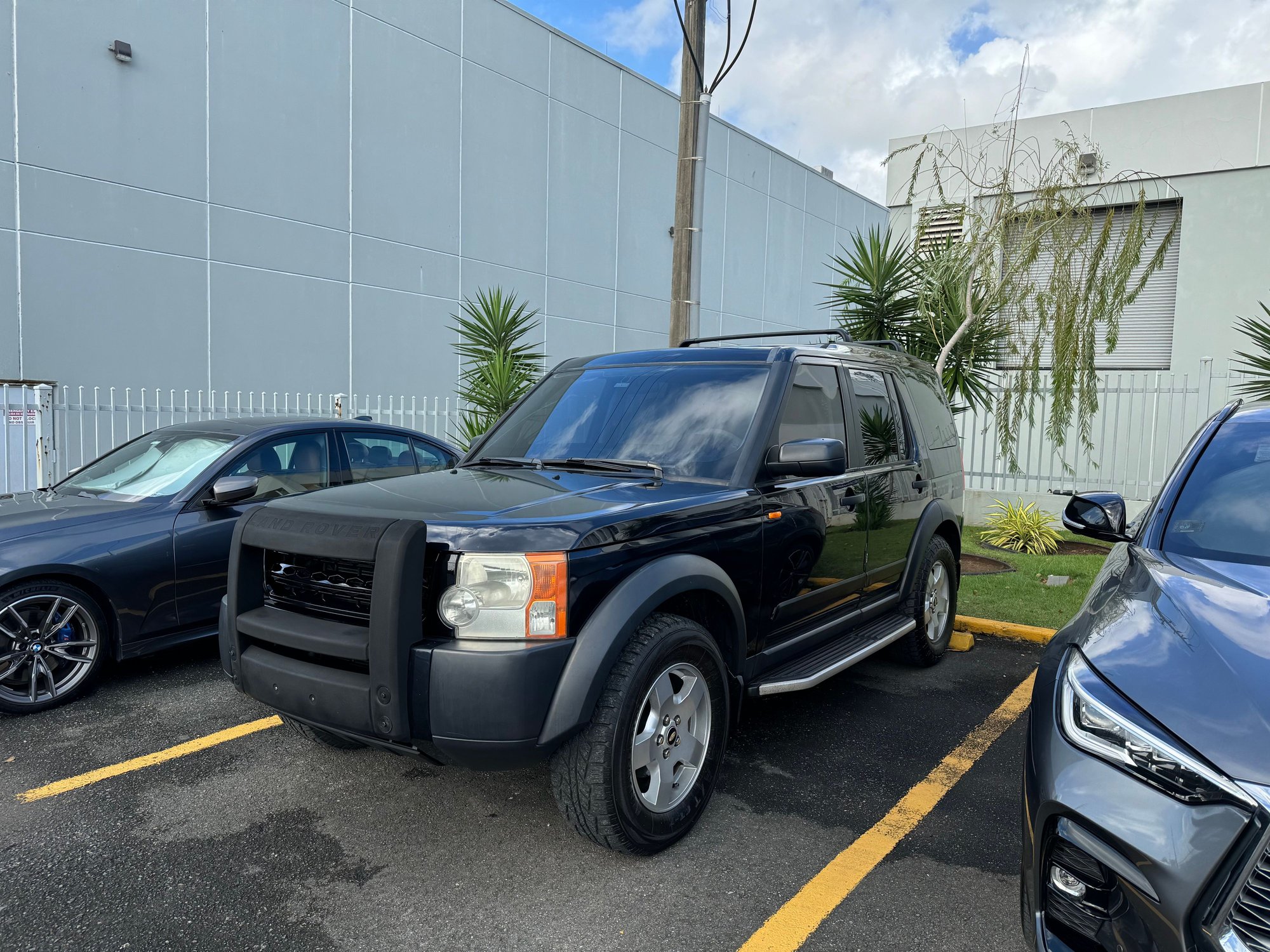

Hi. There are driving/fog lights for the OEM A-Frame Bar? My LR came with one installed. I’m looking for this look.
There are one that can be easily installed?

Yes! Mine already has the A-Frame. Thera are any OEM ones?
My Bucky:

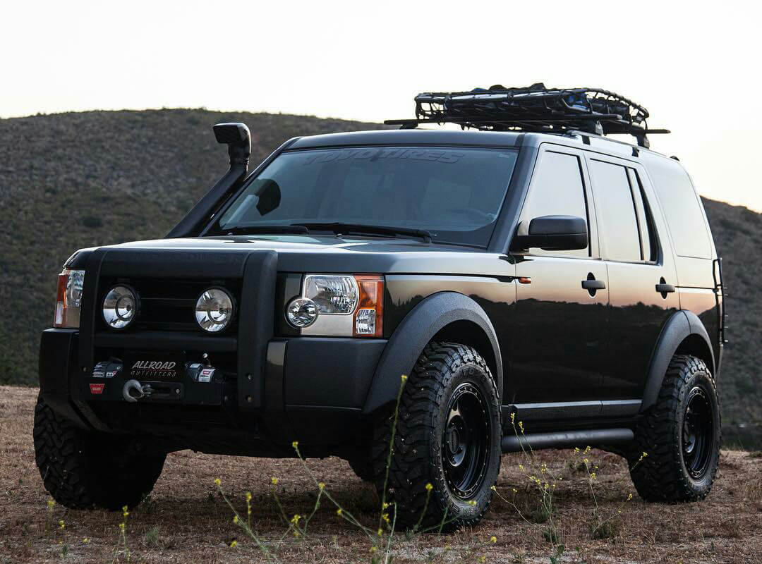

You mean like this?
https://miamibritish.com/shop/land-r...lr3-discovery/

X, I wouldn't think so. I have these lights on my '05, which I had the dealer install way back in 2005, and they mounted a separate switch on the dash, just to the right of the instrument cluster. It's a LR/Factory switch. It's nice; looks like it belongs there.
