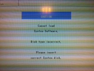

This is when the real problem started. See the attached picture at bottom of thread. My DVD NAV seems to be locked up and looking for something.

its possible however unlikely the master disc they used could have faulty or a german one. But the bootloader disc that is used for them should have worked.
although most likely the issue is with the telephone module but it looks like he made things worse.
They could have programmed the wrong info as well.
and yes you have a battery problem. Just look around and online for a battery that is 700 CCA

I got bad news. I just reviewed the HDLF bootlegger bulletin and if the screen did not say Specifically,
HDLF bootlegger error then using that disc ****ed the system up.
a reprgm of the nav unit with SDD would not have done that as the system would have seen the differences.
Its entirely possible that they ruined the nav unit when it was not needed in the first place. The only thing needed was diagnosing the voice command which is stored in the telephone system itself.

yes you can but it wont fix the no sound.

Swapping the nav ecu with a know good one would be a good place to start.
at least you'll know if the problem lies in the ecu or not. Do you know anyone that
has an LR3. It's less than 10 bolts to remove the donor. You can unplug yours
and plug the donor in without removing your seat.
