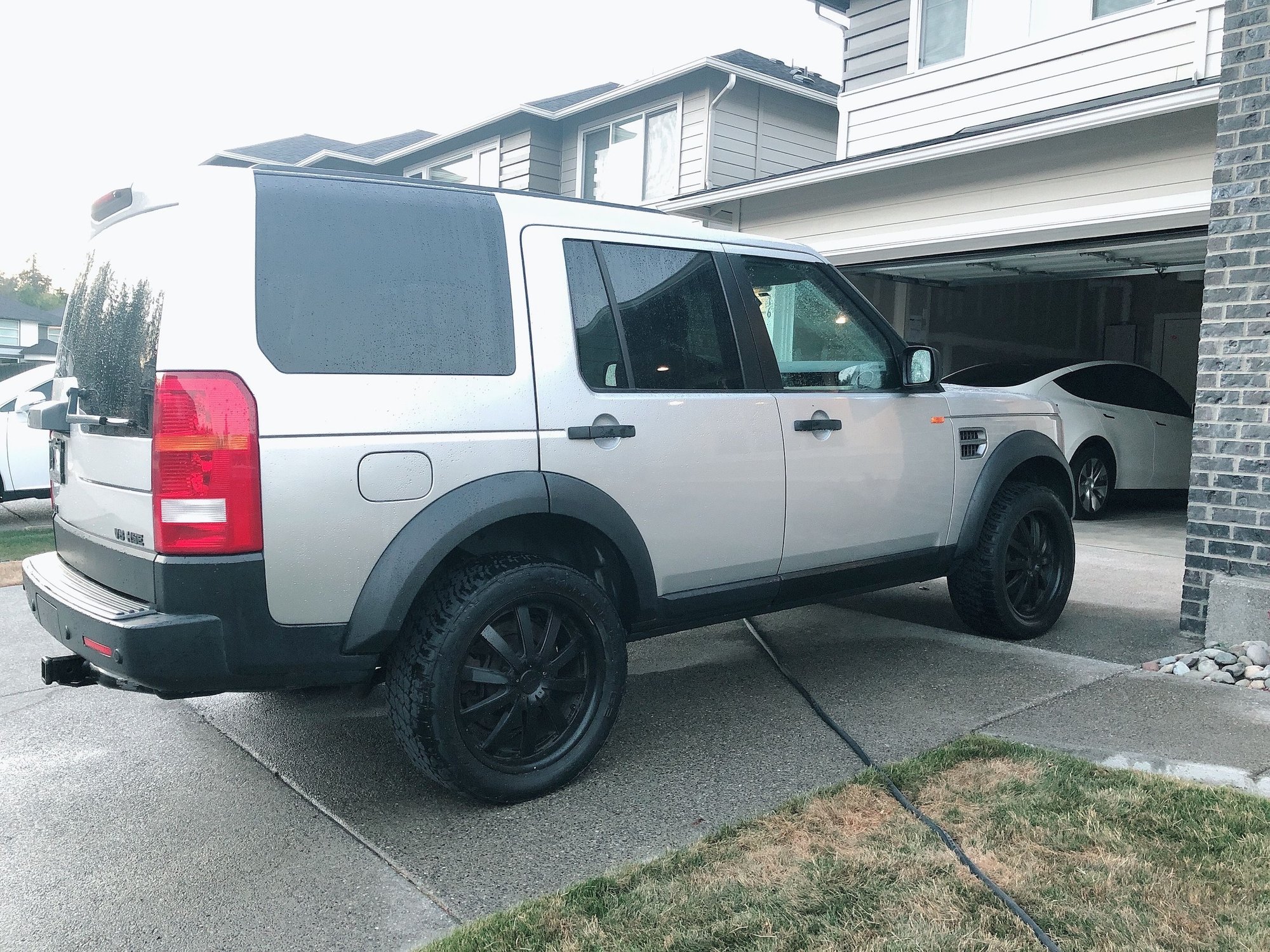

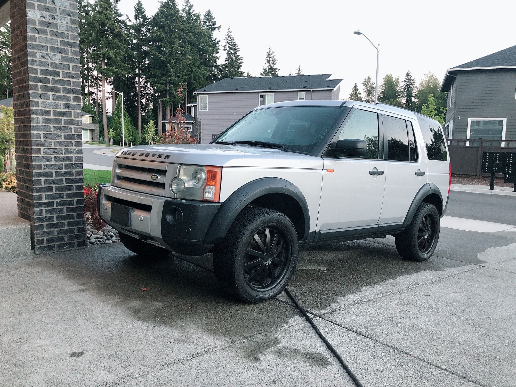

P.S. Does anyone know what brand the wheels are? I plan on getting them swapped out for 18" Terrafirma steelies soon, but am curious.
Anyone know what brand these wheels are?
