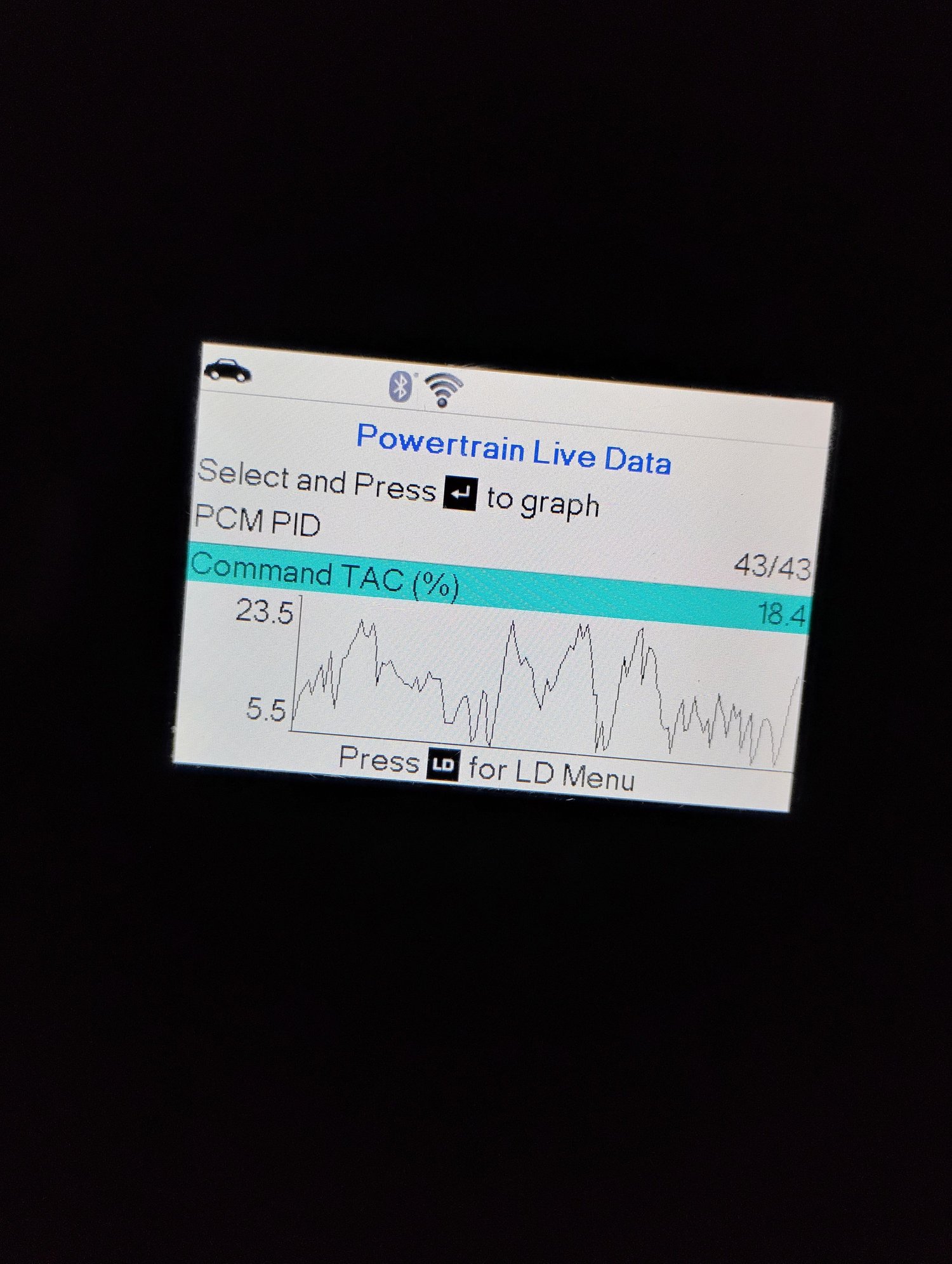

Second update from earlier. I went ahead and cleaned the throttle body and recorded some data. Looks like the computer is relearning a little but the Command TAC still appears to be all over the place. Can anyone confirm if this is normal for an idle? Maybe I need to hard reset again and give it more time

Problem Solved, for now. After the new MAF installation I smoke tested the system again and no leaks. My scan tool gives me fuel trims short and long term per bank. One thing I noticed was when I quickly pulled off the throttle while driving, the fuel trims made a large adjustment for a second or two then evened out. That happened even after relearning. So as I mentioned above, I cleaned the throttle body but eventually ended up just buying a cheap Chinese aftermarket throttle body from eBay for $60. Figured what do I have to lose. I plugged in and tested both.
I had my wife move the throttle with the engine off and checked the old one, no noticable issue. I ran a volt meter on the old one, no noticable issue. So I said, why not I'll just put the new one in. No noticable difference between the old one and new one when testing movement when the car was off. I then did a hard reset discounting the battery for 30 mins and boom, fixed. No check engine light or lean codes. My guess is the old one was not fully resetting when I went quickly off throttle. It felt tight and no binding. The part is a Ford motor company and I figure probably just wore out around the 147k mark. Hopefully this helps someone else. No code on the throttle body or loop, only codes on bank 1 and 2 being lean after the new MAF. So far put about 250 miles on with no returning lights or codes.
