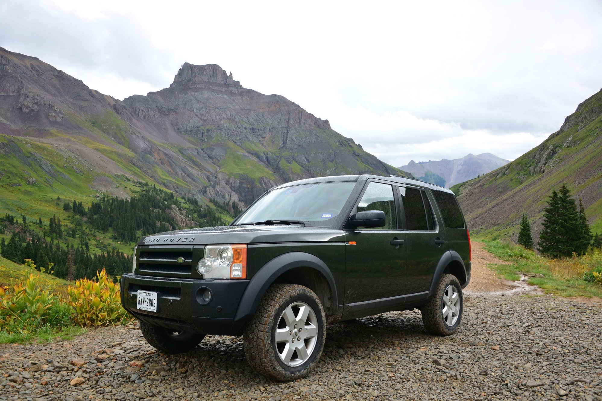

Well we made it! Hit a couple of trails along the way. The altitude triggered a rich code on both banks, but they cleared and didn't return. The coolant reservoir float sunk with a false "Low Coolant" warning. A new reservoir is on the list for next summer. All-in-all it was a good trip!
