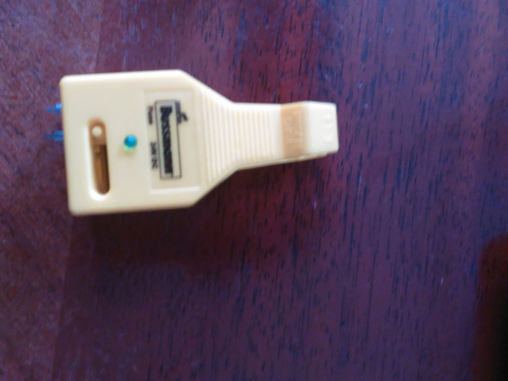

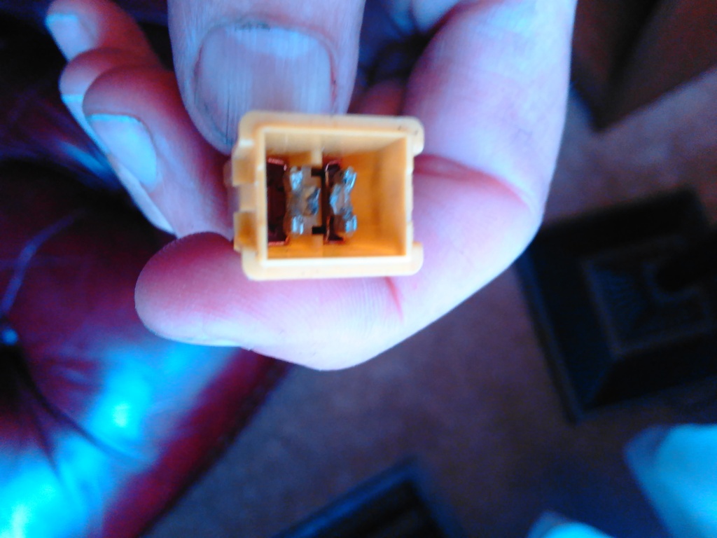

Default Now Im messing with fuses...help girl here lol?
Guys,
How can I tell if fuse FL10 (60A) is blown? does it look like the pics?? and what about the other reg. fuses? ..I have this yellow tool to check them but have no idea how to use it..does the car have to be on and if the green light on the tool comes on does it mean the fuse is good? lol
Thanks for you help

I assume the green lite means good and power needs to be on, if the carpets are wet first thing u need to do is pull them up and force all water out of carpet and insulation , sop it up and leave the carpets up till 100% dry
Next check all connections in pass side rocker with blue tape a lite tug, if they seperate repair
There is a fuse that blows if the noise box on right side of trans is bad, put in new fuse look for smoke at trans then fuse pop
You can't diagnose anything till floor and carpets dry and wireings dry, this vehicle is very sensitive

Yup....what Tom said. Dry out the carpet and underneath the carpet, check for corrosion on the wires/connections and clean any that you find.
