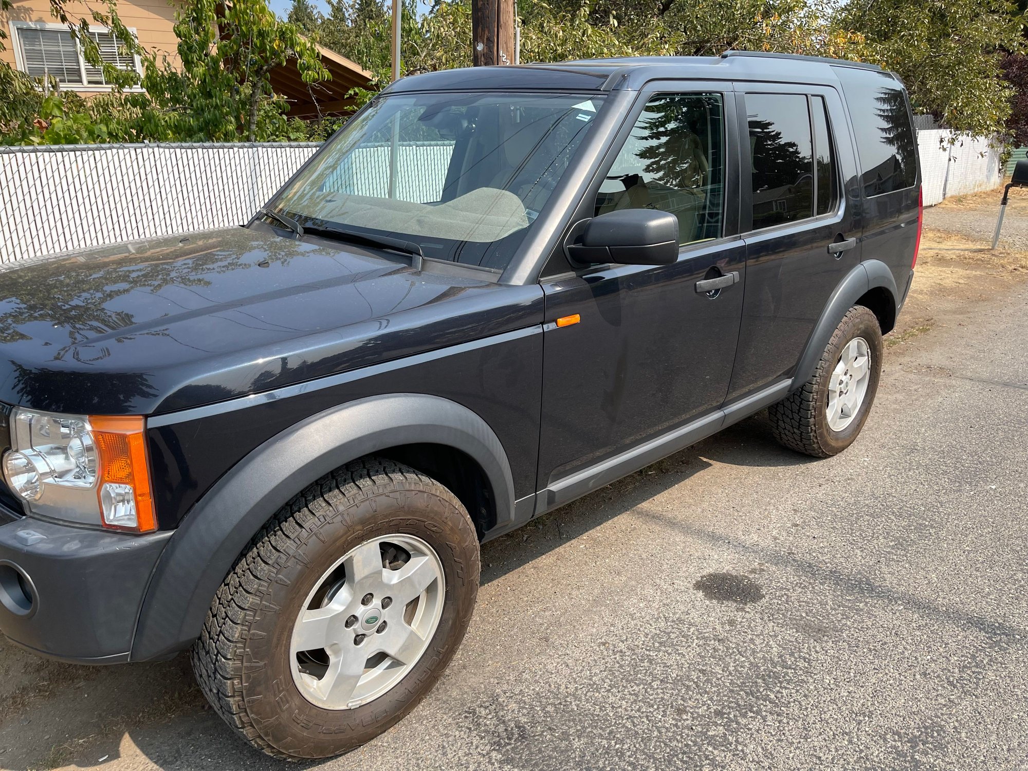

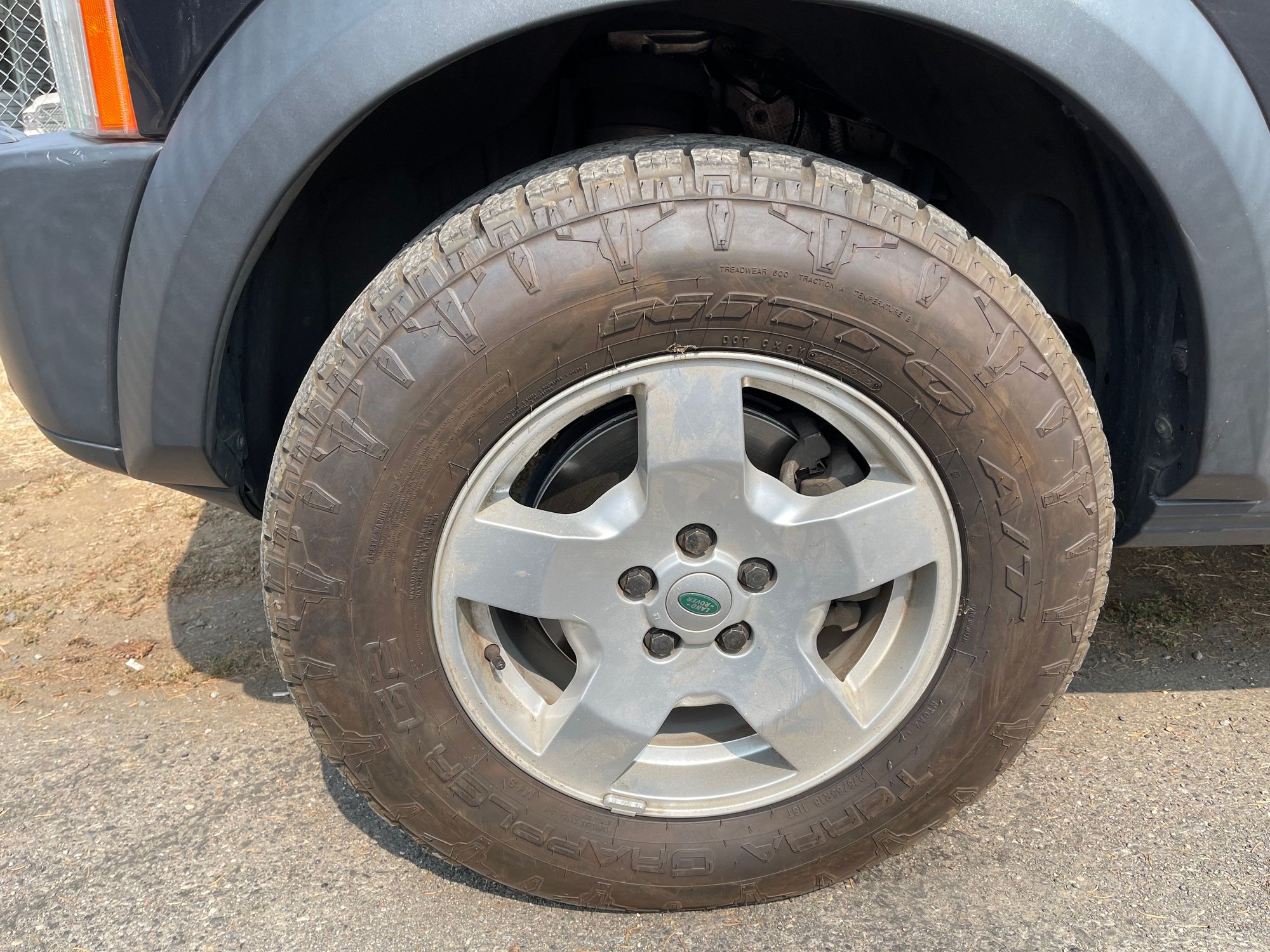

Hey, OP here. I was just busy the last few days with family stuff and work (I worked on Labor Day, it sucks) and didn't have any time to reply. I finished putting my wheels on yesterday and have about a 1 inch lift using the GAP tool. I also fixed the "Tyre radius" in the CCF files as "400", as opposed to the "370" that was with the 255 tires and the speedometer is spot on (verified with GPS speedometer app on my phone). The GAP tool is so amazing, it literally pays for itself every time I use it. There's also no rubbing anywhere, even with turning and with speed bumps, and they looks pretty amazing. My only gripe is that huge rocks now get stuck in the tread spaces and I have to manually remove the more stuck ones. All-in-all, a wonderful tire set. Thank you again Rennie. There also might be some cobwebs that didn't get blown off by going 70mph on the freeway, hopefully the pressure washer will take car of that.
EDIT: I know from the looks of the pictures that they look dirty and old, buy be assured that these tires are almost brand new and still have their factory "whiskers" and no tread wear at all.
A closeup. I still need to clean these.
A side profile shot.
