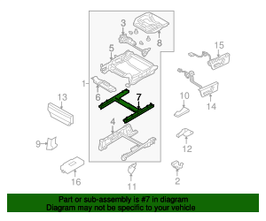

I had this problem. The worm gear on that side has gotten jammed up.
You can take it apart and may be able to unjam it. I had to replace the whole "H" shaped mount. As a side note, the motor is mounted in the middle and used cables to drive the worm gear on each side.
Part number is LR021396 and here is the diagram
This part has the worm gear and motor
Hope this helps
