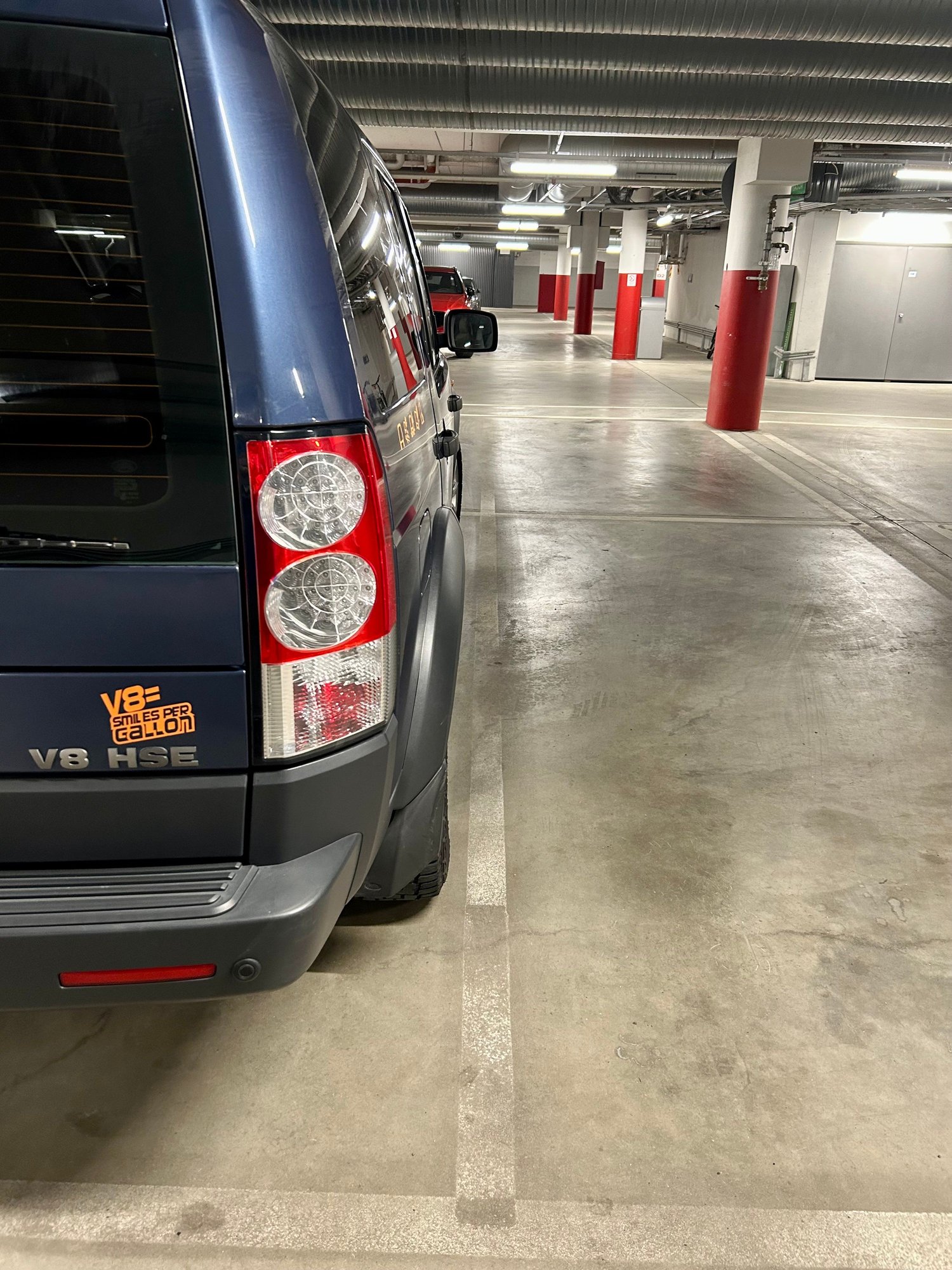

You can change the D3 taillight modules to D4 (red surround) or D4.5 facelift (black surround) very easily. You do need to add resistors as otherwise your D3 will think the rear lights are broken and blink 2x speed when using the turn signal.

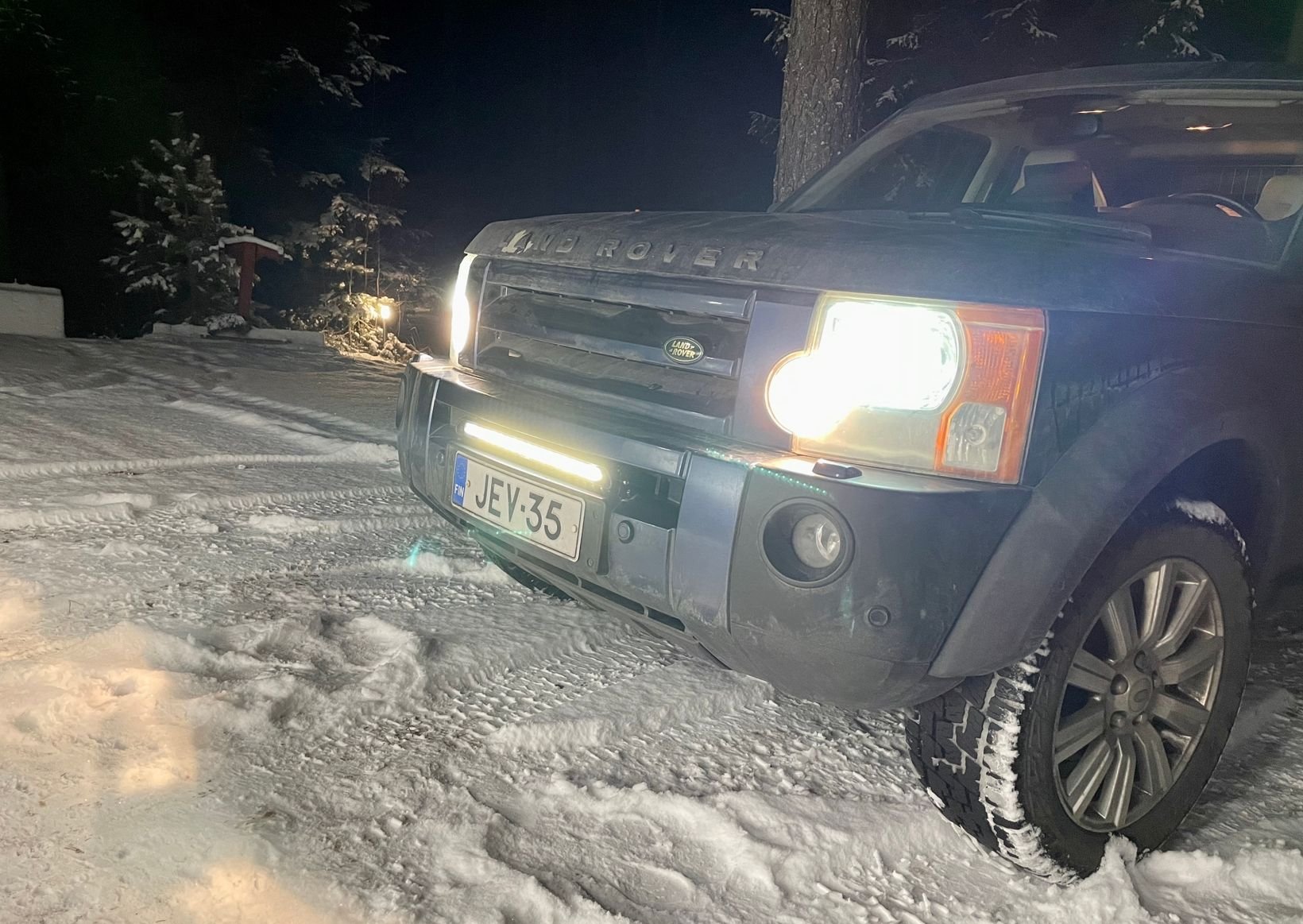

As for the front - I wouldn’t do anything for the existing HIDs unless you want different color temperature (like Osram Xenarc Cool Blue Intense D2S). You can mount a separate led bar in many places. I mounted mine in the air intake above the license plate.

my D3 with D4 tail lights

LED bar mounted. The light is a Lazer Linear 18 Elite which gives of a crap ton of light in a very nice pattern.

Thanks for this, I love the look and location of the light bar.
