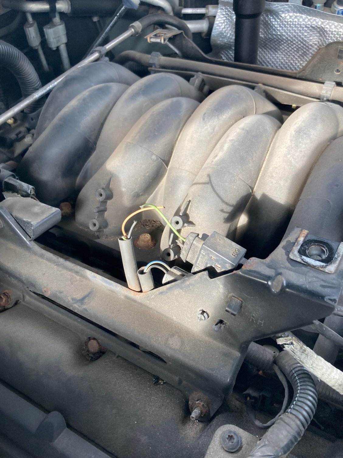

also noticed the wires of the this electrical connector on top of the engine were brittle and broken. Are these fuel injector wires? The engine was running smooth and getting great gas mileage.

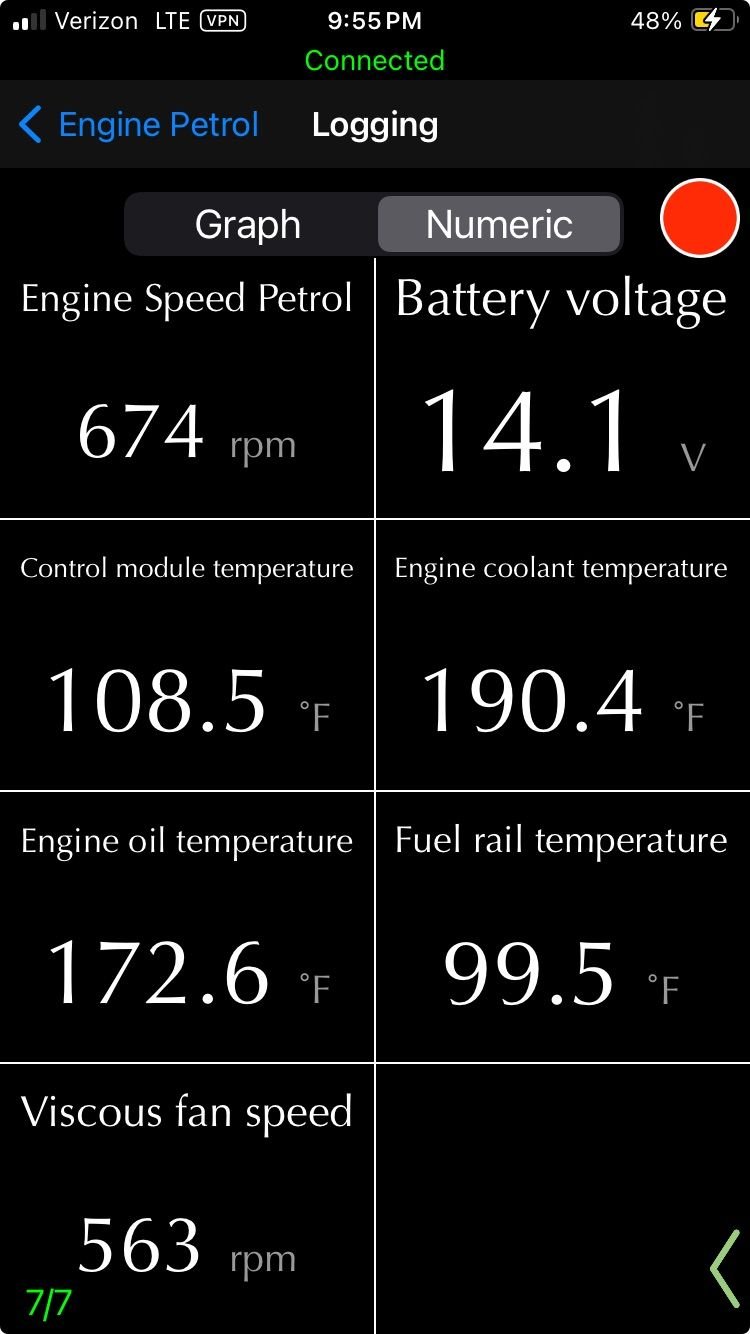

Update, replaced the water pump, very easy job other then the coolant mess from draining. Two pieces of advice, keep the belts on when removing the pulley bolts, and get a vacuum coolant tester/filler. Both of these will speed up the process and make life easy. I bought this vacuum tool: OEMTools 24444.
after install, I drove for 30 mins around the neighborhood to get the coolant up to temp and everything checked out fine. I’ll check fluid levels in the morning.
obd II live values after 30 min cruise and T-stat opening up.
