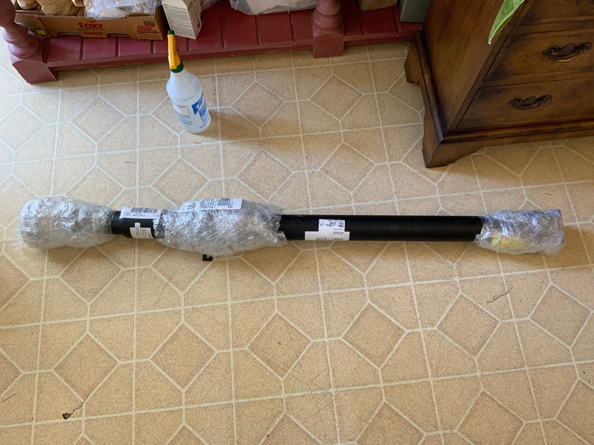

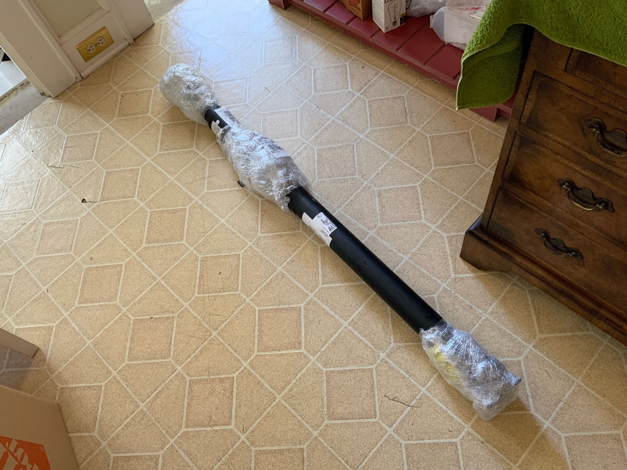

Hi we just received Driveshaft from PartsGeek. Is it normal to send it UPS Ground with
pretty much no packing around it ? Is this how yours arrived ?
Thanks
