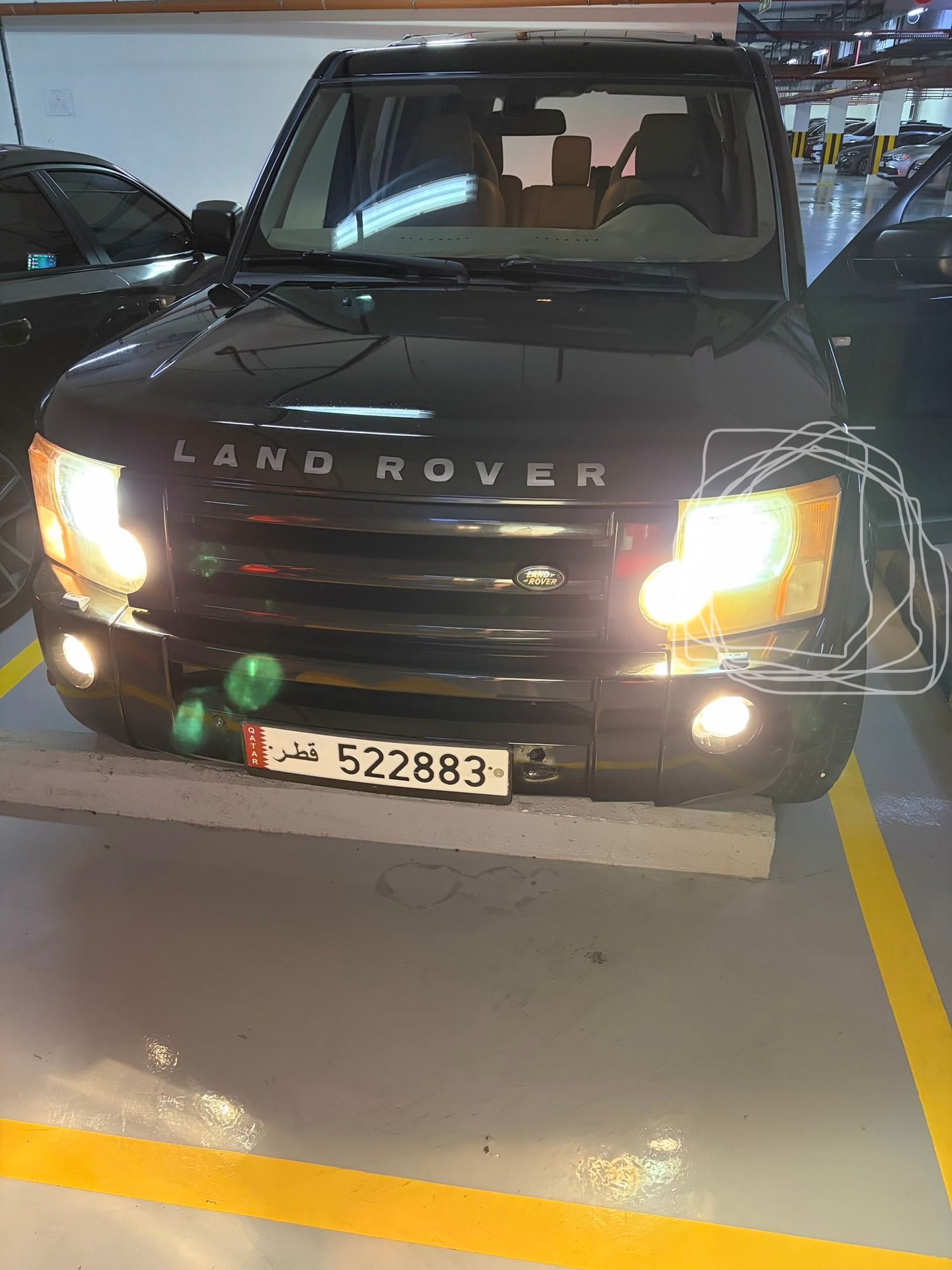

Hi
My lights are really bad in the dark and some warm white and some blue,
I can get the glass polished here but need uniformed bulbs that's actually let me see in the dark
any help please
KR
Carl

Many swear by Genuine LR bulbs
Some say any reputable brand of the right style will work fine
This chart will help with identifying which bulb type to look for:
https://www.rangerovers.net/attachme...pecs-gif.4323/

Thank you so much, what do you advise ?

Do you want standard halogen or LED?
I like Philips or Bosch for halogen and Lasfit for LED

I live in quite a dark place, literally we are a country of bright buildings but very dark streets and ambient in the city only, so literally the brighter the better for me
what would you suggest ?

I like Phillips which was factory. They should last 100k miles, easily, before they start to dim but I tend to replace mine every 50k miles cause I get em for $1.00 USD each. But there are several options as the video link will show some. For LED, a no go for me. I get ice and snow where I live and it will build up too much on the lens.

These Philips are great lights. Friend has them in his LR3.
Philips H7 Extreme Vision Philips H7 Extreme Vision

Also, don't forget about the small light below the front turn signal light, not sure what it is called, but I think it is a D10 bulb, or something like that. They can definitely brighten things up.
BTW, love Qatar. Hope you're having as much fun as possible there

H7 are for high beam. I went with Hella H7 2.0TB for them and just realized I have 100k miles on them. The high beams (fill lights) do benefit a TON from better lamps, more so than the low beams.
