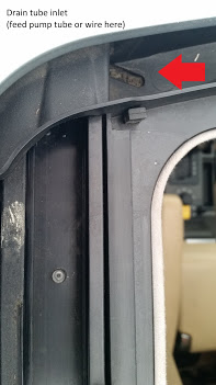

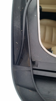

pics courtesy of DanC
Size:  13.2 KBclogged drain at each corner
pump to unclog
