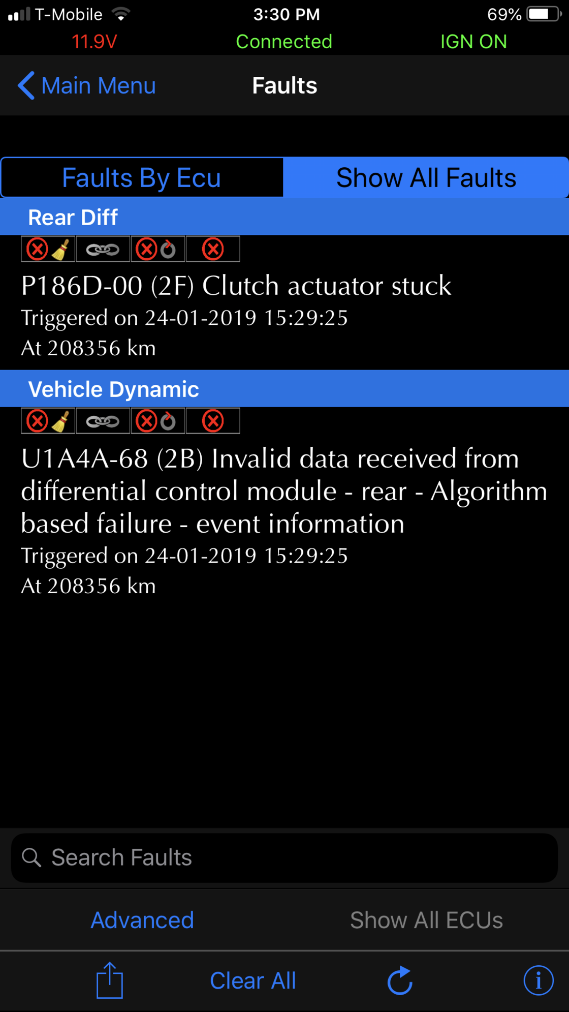

So I got the P186D-00 code and the U1A4A-68 code. Code came up when wife was driving normal, she said 😂 I have a Gap tool cleared it then self tested the Diif Lock a few times. My wife then went on a short drive and had no issue. What can I do. Or should I just keep an eye on it. I’m thinking about a rear differential overhaul. 2008 LR3 HSE with rear Locker.

What are you reading codes with?
I had a customer that was using a generic reader and it was pointing to his rear diff based on his research, but the GAP and Autologic said it was the transfer case.

There was a LTB issued in January 2009 in regards to that code.I had that code appear for a while, but did not pay attention up until that point that I could hear a screech coming from a rear E diff actuator motor. Rear diff will not not throw any codes per se as everything goes through Transfer case hence codes showing transfer case module involved. Basically you will need a software update for the rear diff actuator motor as it has a tendency of being partially stuck or engaged partially. Worst case scenario you will need a new or rebuild rear diff actuator motor and software update afterwords. One way to check if the actuator is bad is to listen for a screech sound while turning ignition off with windows down.

I have the IIDtool BT.
