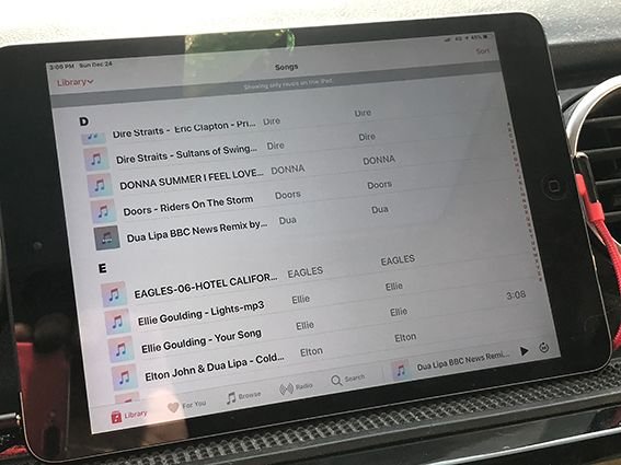

In the meantime I wanted to attach the iPad literally to the face of the old Nav unit. The best solution I found was to make up a sort of mounting platform using 10mm Foamboard. The foamboard can be put right on top of the touch screen, it will not affect it, there won’t be any constant selections made on the screen, the foam board is inert. The end result here looks crude but it works and under the back tape its quite neat!
First, I tried using a self adhesive magnetic strip I bought in ACE to hold the iPad against the foamboard, but despite the label saying “Extra Strong Magnet” it had all the strength of a wet tissue, so plan B was to use Velcro. I had some Velcro from an earlier project but this was a really heavy duty Velcro, so I just attached two very small patches to the back of the iPad but even so, it grips like a woman giving birth and is a bit difficult to tear it away!

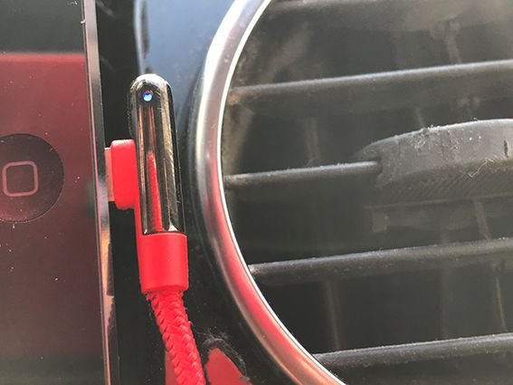

To connect the power I found a very small right angled Lightning connector which is perfect, and used a standard 3.5mm jack connector to feed into the AUX socket on the LR3.
It works well. There is a slight issue with Dubai being so dammed hot even in the winter, the iPad can overheat if left in the car all day, until it cools down again. I changed the angle to what you see, first time I had it on a slope to match the slope of the vents, but the sunlight kept hitting it, so this more upright angle is better.
Oh, and playing the music from the iPad through the LR3’s Harman Kardon hifi system is amazing! But when you turn off the engine, the volume of the Harman Kardon drops by half automatically, I wish I could change that!
