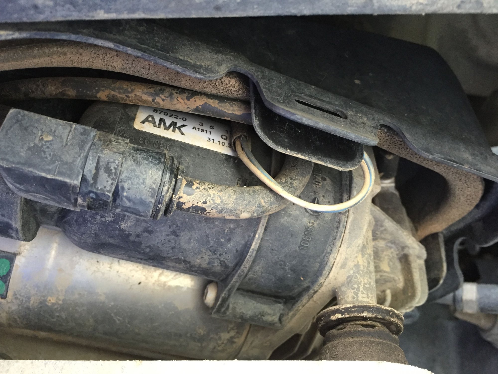

Ha, it's the AMK, despite the IID tool saying the flash on board was Hitachi. Not sure if they never flashed it at the dealer the PO had it repaired at, or if the read was in error, flashed it to AMK, no noticeable difference.
compressor

Looks to me, at least from the pics, more like the front driveshaft CV joint is failing. I don't think you can get just the CV, but the whole driveshaft is fairly easy to replace. If it's a street truck you can use aftermarket but if it's for off-road use I'd stick with OEM. And no, there is no lube point for the CV on the driveshaft.
I dunno. The spray pattern on that grease in the first picture indicates it's across the car, left to right. If it was from the CV joint, it would be more of a front to back spray pattern. Besides, the CV boots I've had fail certainly haven't resulted in a pattern that nice... it's more like every thing is just covered is nasty grease... everywhere.
EDIT: Oh, DRIVESHAFT CV. My bad. That could certainly be a possibility.
