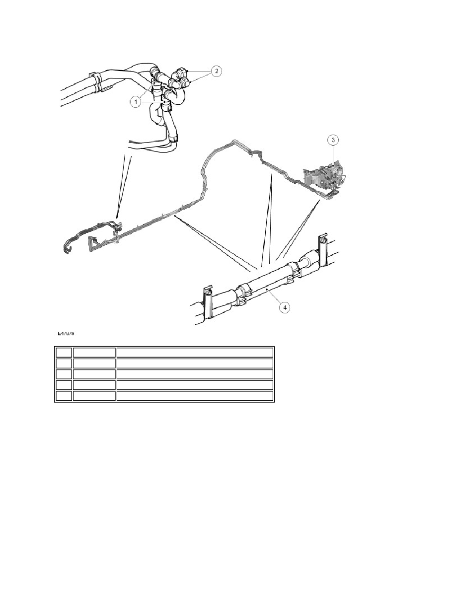

Yeah I think it is coolant reading more about it. They probably switched it to the non-DexCool (yellow) when I had the engine replaced.
This section from the manual makes it kind of seem like they might be easy to replace? Joints and quick disconnects? Anyone know how much replacing these lines is? I know the refrigerant lines are $$$.
Two heater lines, supply and return, connect the heater core in the auxiliary climate control assembly to the engine
cooling system. The heater lines are routed along the rear crossmember, around the right rear wheel arch and along the
RH underside of the vehicle. The heater lines are connected to the engine cooling system at the rear of the engine
compartment. The heater lines consist of sections of aluminum alloy pipes, insulated with foam rubber, which are
connected together with rubber hose joints. Quick release fittings connect the heater lines to the engine cooling system.
