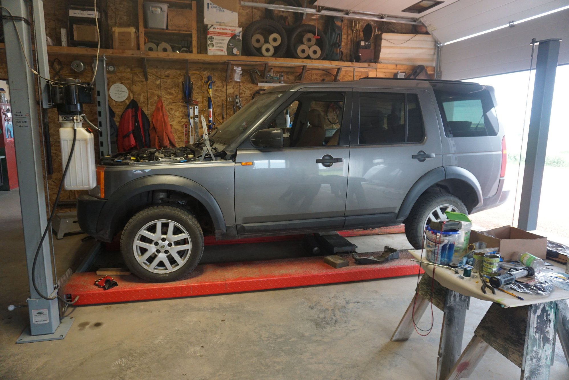

Had to remove power steering and aircon compressor to re-route wiring, plus figure out which was left and right cylinder bank for knock sensors, installed coils, spark plug wires and engine block grounds. Birthday party for the 11 year old was a cake filled success!
Edit: Wednesday August 7 we buttoned everything else up and as we were adding coolant, noted a pinhole leak in the radiator, so all on hold until we get a new radiator, LR021777...
Edit: Thursday the 8th, removing radiator and having a local company examine it to see if it is fixable, hopefully it is. Photo is just before adding antifreeze and discovering radiator leak...

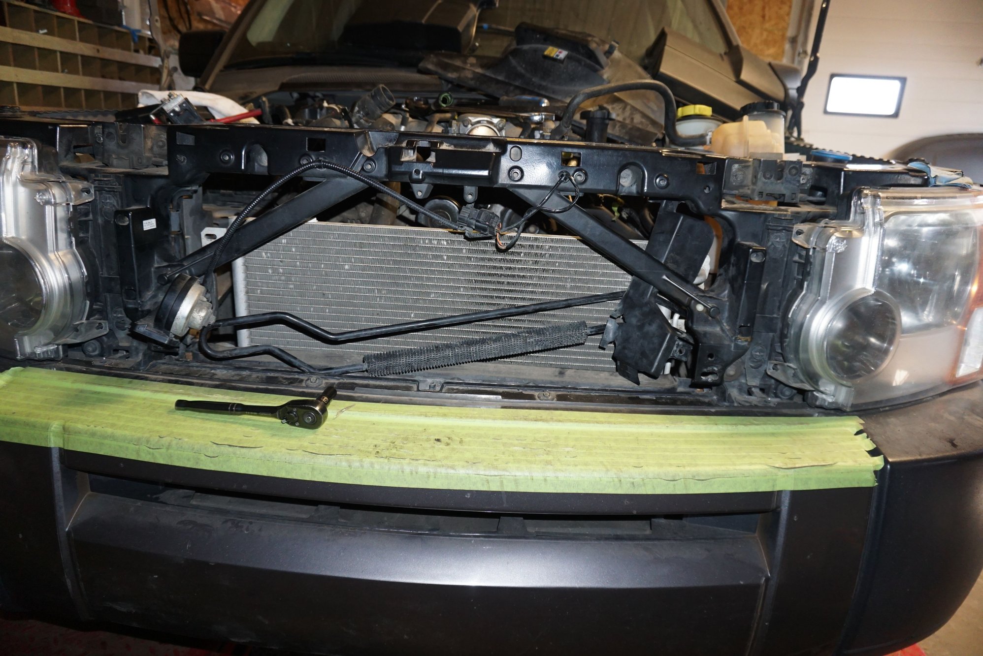

Radiator removed and engine compartment looking like 2 days ago, taking radiator to a local shop, we must have damaged it when working on the engine, was not leaking when we started. Of course, this is good experience for when the air conditioning condenser (silver coloured radiator in photo) or the power steering cooler (black device in front of A/C) goes...
