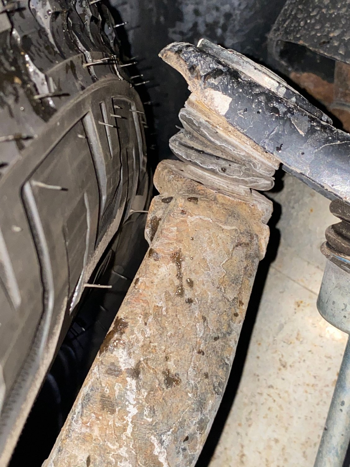

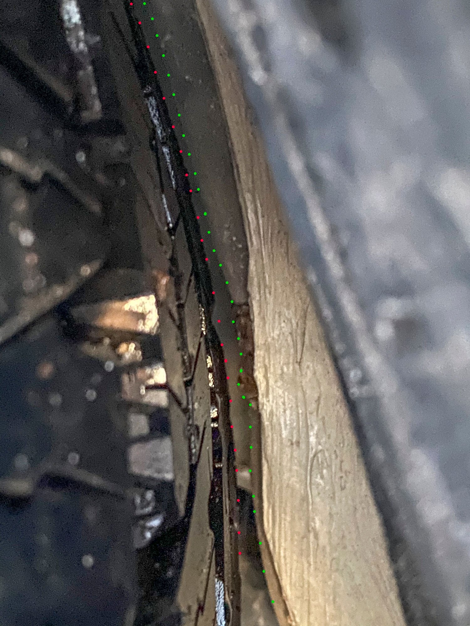

Well I guess I can answer this one on my own. In short, not much to worry about at all. I did not move my coolant lines. Pics:
Truck is at access height, so a touch low. Substantial change from the 245/55/19 I was running before the swap. Still have those since this was also a wheel change.
I did move the height sensor harness on the front driver wheel well by pulling it up to the support for the upper control arm. Not hard to do and apparently not necessary from what I can tell. And you can see here, with tire turned full to passenger (had a buddy hold wheel while I took pic) there is plenty of room to spare. Also room to spare at the upper knuckle/arm. I don't have a pic, but there was no possibility of rubbing against the back of the wheel at the frame. So like I said, moving the harness was probably not needed with this tire. A mud tire of the same size? I think one wold have too.

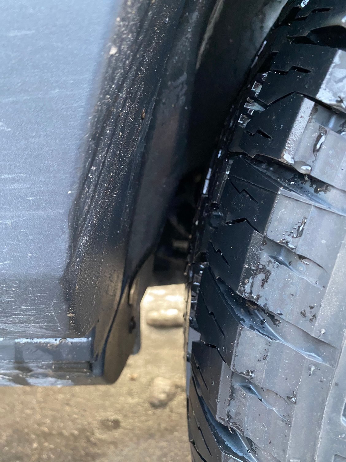

At the rear is where I had rubbing but only when on the stop and it was in the upper parts of the liner and very minimal. Certainly nothing that would prevent driving. I even drive it back and forth and could not tell where it rubbing, just head a little squeaking. First pic below is driver side at the small bump in the forward part of the liner. I think some deform this in and flatten down the metal fin behind it. This pic is at access height and when slammed there was not rubbing here.

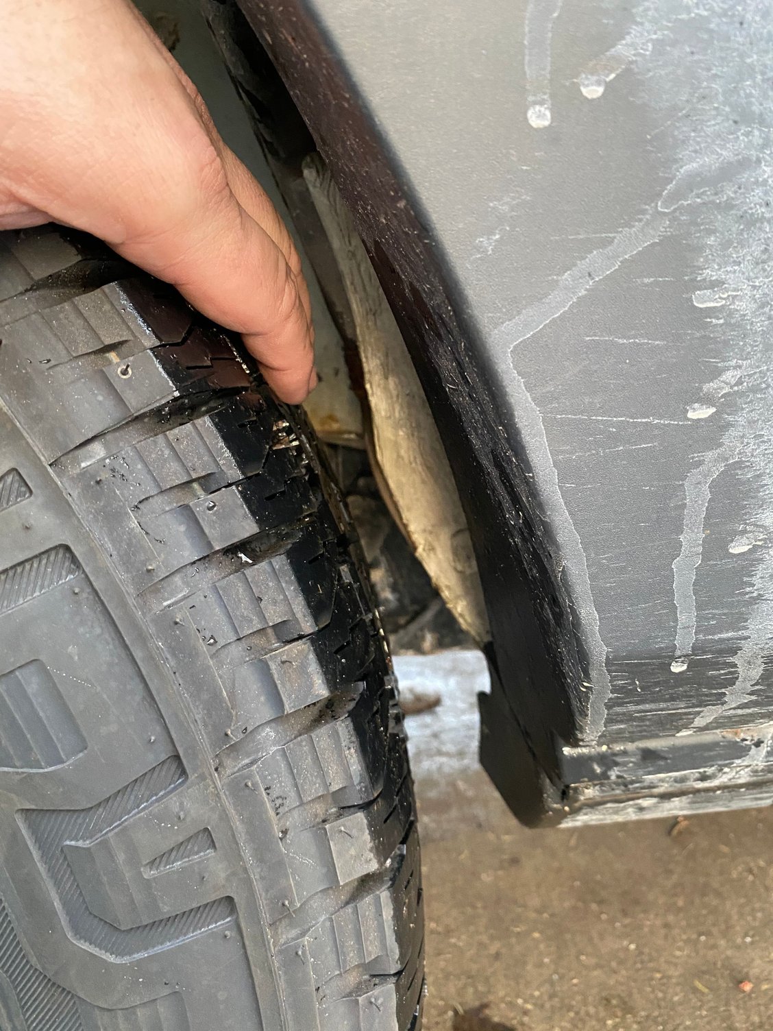

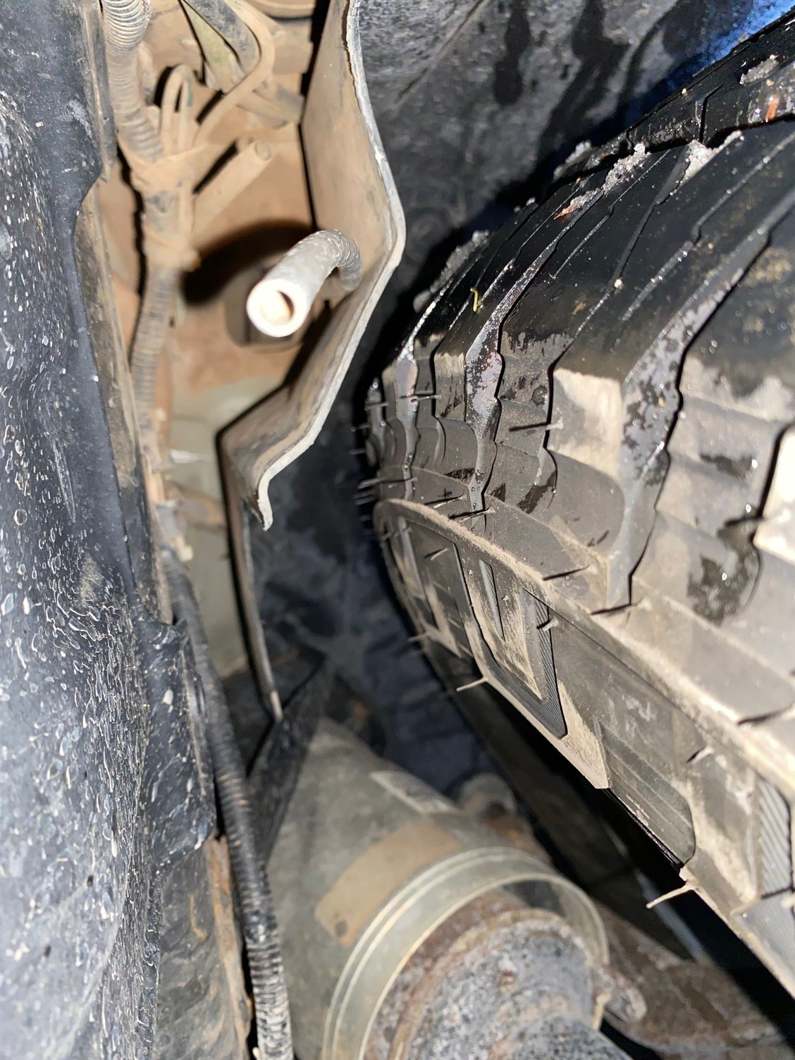

These next two pics are the are of concern, the passenger side rear wheel at the coolant lines. At access height I can easily get my hand between the lines/metal fin and the tire. No risk of rubbing. On stops, its really close and I think this is where there would be an issue with rubbing. In the pic, no liner is installed yet and the gap is only a liner or two thick. So its not much. So I took the liner and used a heat gun to flatten/push in as best I could before installing. If there is rubbing here, it will be with the liner and not the metal fin or cooling lines themselves. So maybe during some extreme articulation I will get liner rubbing, but I am not worried and will keep an eye on it to see what happens.

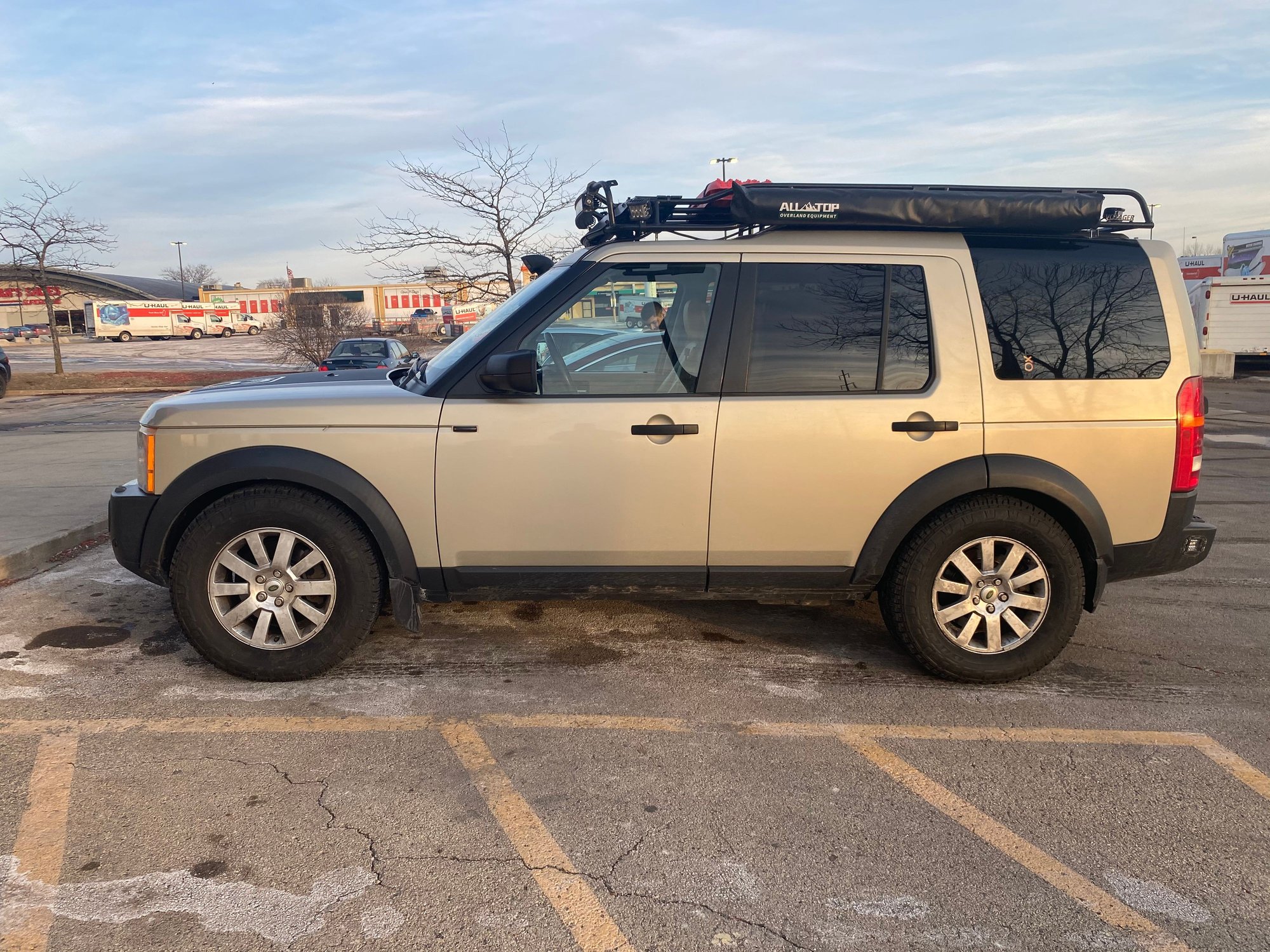

So in conclusion, I had no big issues at all and I know this particular size is less commonly used on the LR3. But knowing they work can open up options for some. These particular Revo tires are not noisy at all and ride incredibly well for an e-rated tire. I think an increase of 27% is what is helping me the most though with ride comfort. The specification for this tire is 32.1" by 10.8" wide. I am not using spacers and at this time I see no need for strut spacers. I do have a GAP lift of exactly 1.5" done during a full factory suspension replacement, so all bushings are "homed" to the proper lifted height. I do feel that some who experience rubbing issues have worm suspension which can change the geometry.
