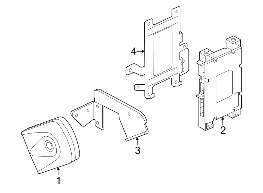

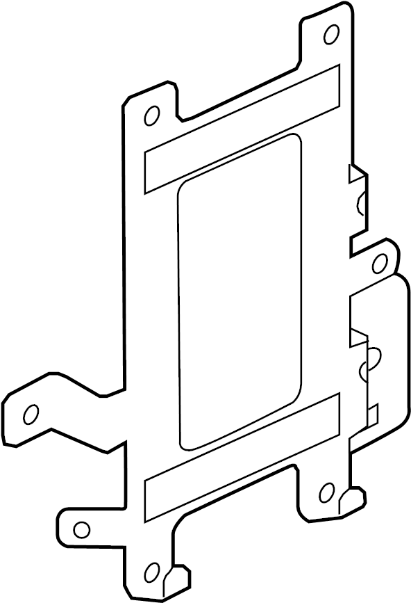

For anyone swapping to the LR4 module you will probably need a proper mounting bracket since the LR3 module is rather different. The part number needs is FHC500390 with an older part number of FHC500300.
I picked up mine from Merriam Parts for $24 shipped (the part was only $8 USD, shipping $16).
