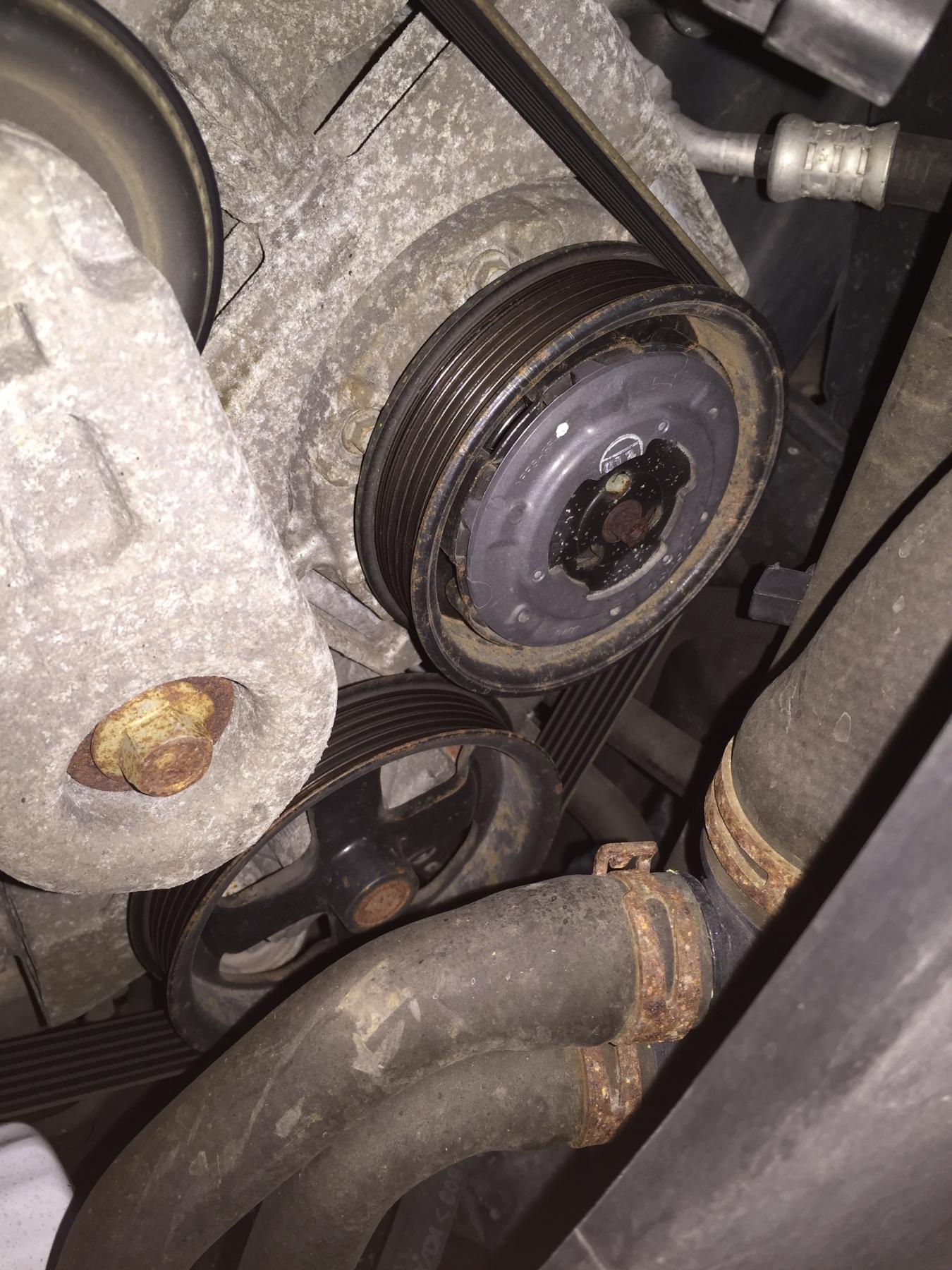

Hey Unseenone, got a grinding noise DEFINITELY coming from my compressor. Ever get it figured out?

Replace the compressor before the metal parts end up in your cooling lines..

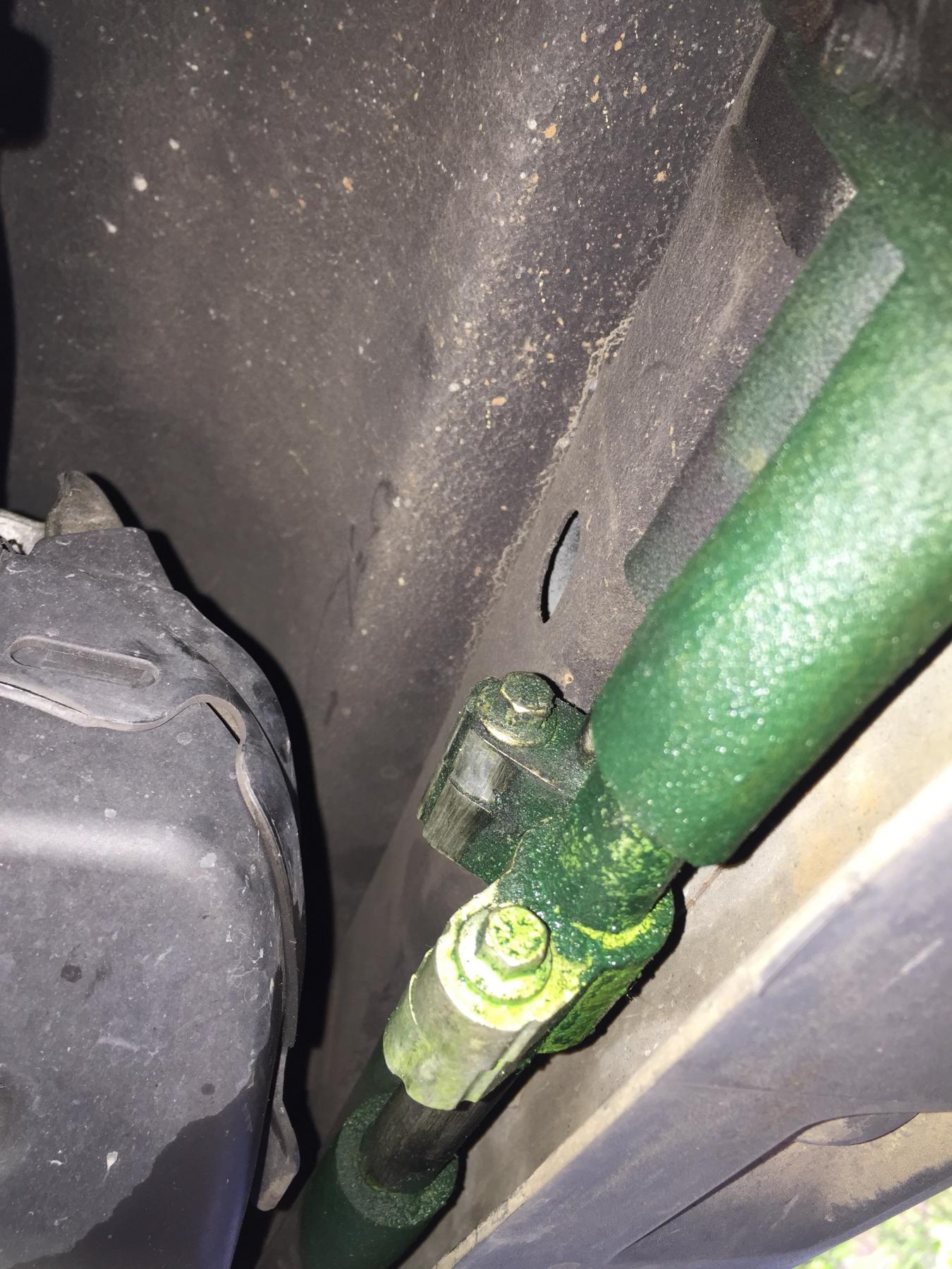

Damn... So do you think that might be why my A/C Lines are leaking? think I'm too late? I just okayed an order for a new A/C Compressor, and should be here on Tuesday. How bad is the install?
