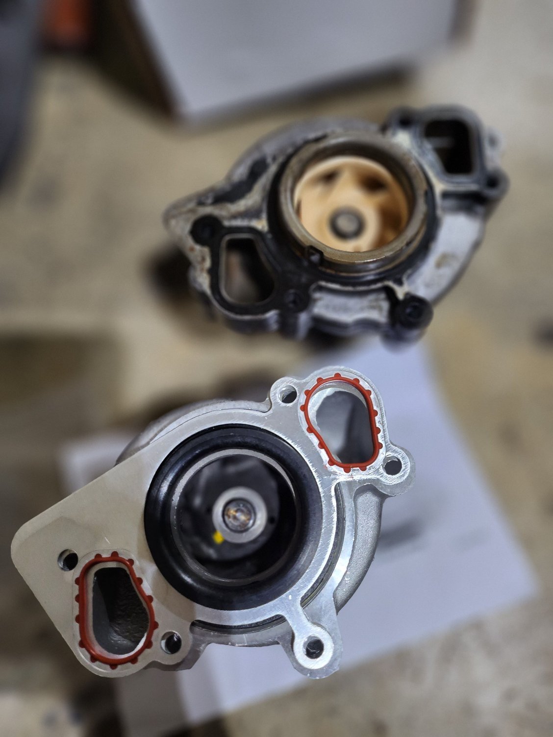

I have solved this issue. It was the water pump. If you can remove the fan, everything from there on is not too difficult.
One thing to note though, I initially bought the improved one piece water pump which did not work for me. It took me hours removing/reinstalling the water pump due to a major coolant leak.
Thinking about it now, this 1 piece design has a large rubber ring where the water pump goes into the engine and I think this rubber ring wast not seated properly, causing the leak.
I ended up paying more for the 2 piece design and everything worked out without any issue.
comparing the old water pump with the 1 piece water pump.
