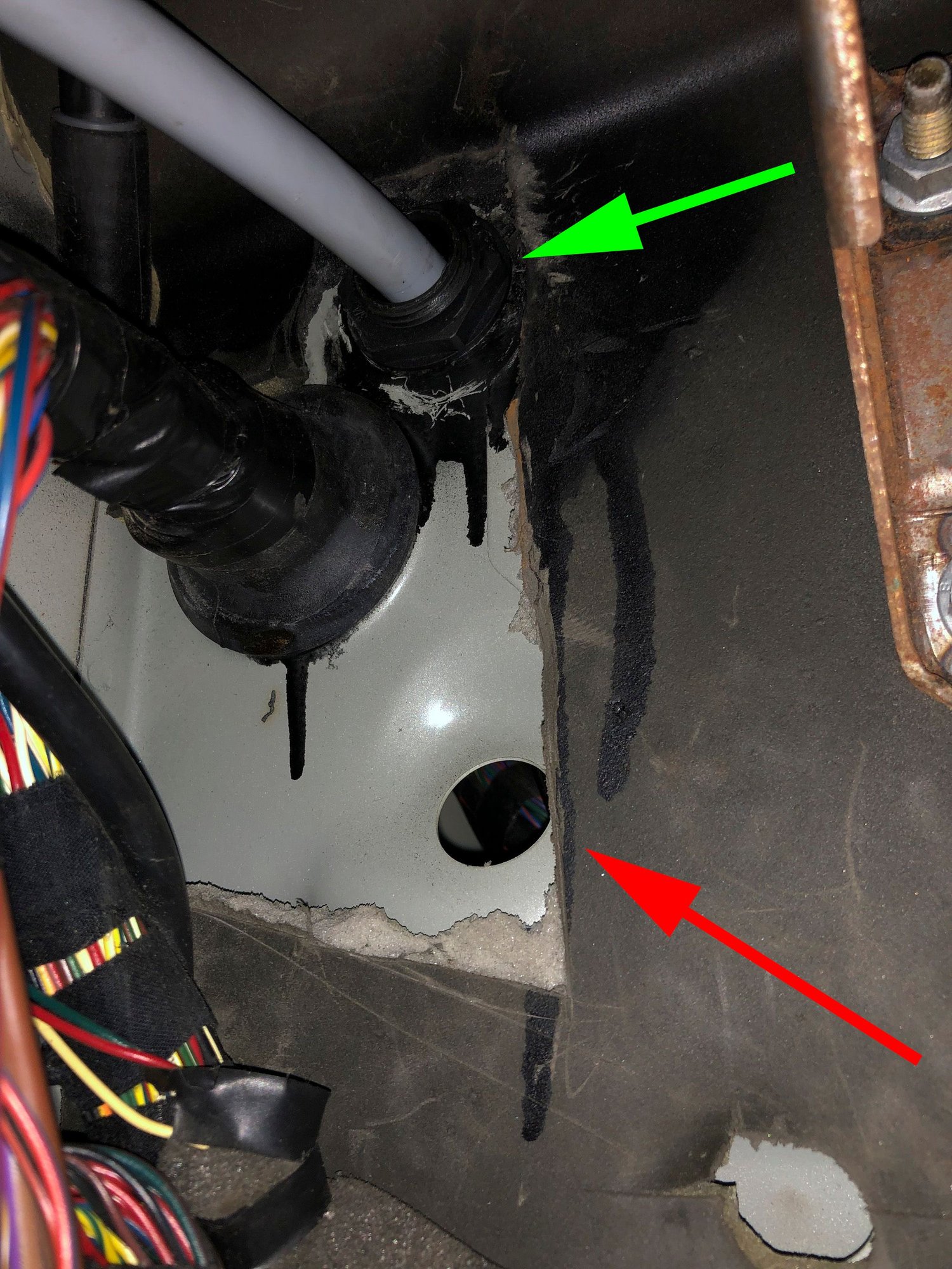

In my many searches on routing wires from the engine bay into the the cabin, I never ran across this one. If its been mentioned, I certainly did not see it as most just mention the one hard to see plug above the main harness. Well I used that one and need to run a large 0awg power feed. So I cut away a larger area of insulation when I found another! I dont know if I can make it work with etc brake booster installed so I will probably still drill a hole. But here ya go, hole number 2 is lower, slightly morein board than the other and actually on metal that gives it a downward angle. I think the idea was that if it was used the angle helps prevent butting up against the backside of the booster. Plugged like the other and appears the same sized opening.
Green arrow - the hole normally mentioned.
Red arrow - the one I have not seen mentioned.

I dont think that will be a problem. Its hard to see in that pic but the upper hole I had to slightly enlarge. Luckily, unlike much of the firewall, that is a single sheet of metal so it was not much work to Dremel it out larger to install that cable gland. But the glad was oversized and looking back I may have had an exact fit without enlarging by using a smaller gland. For my 12-wire switch harness (that grey cable) and for my 0awg primary, this is the gland I used. Your 2/0 is only one millimeter more in diameter and this gland would work fine.
