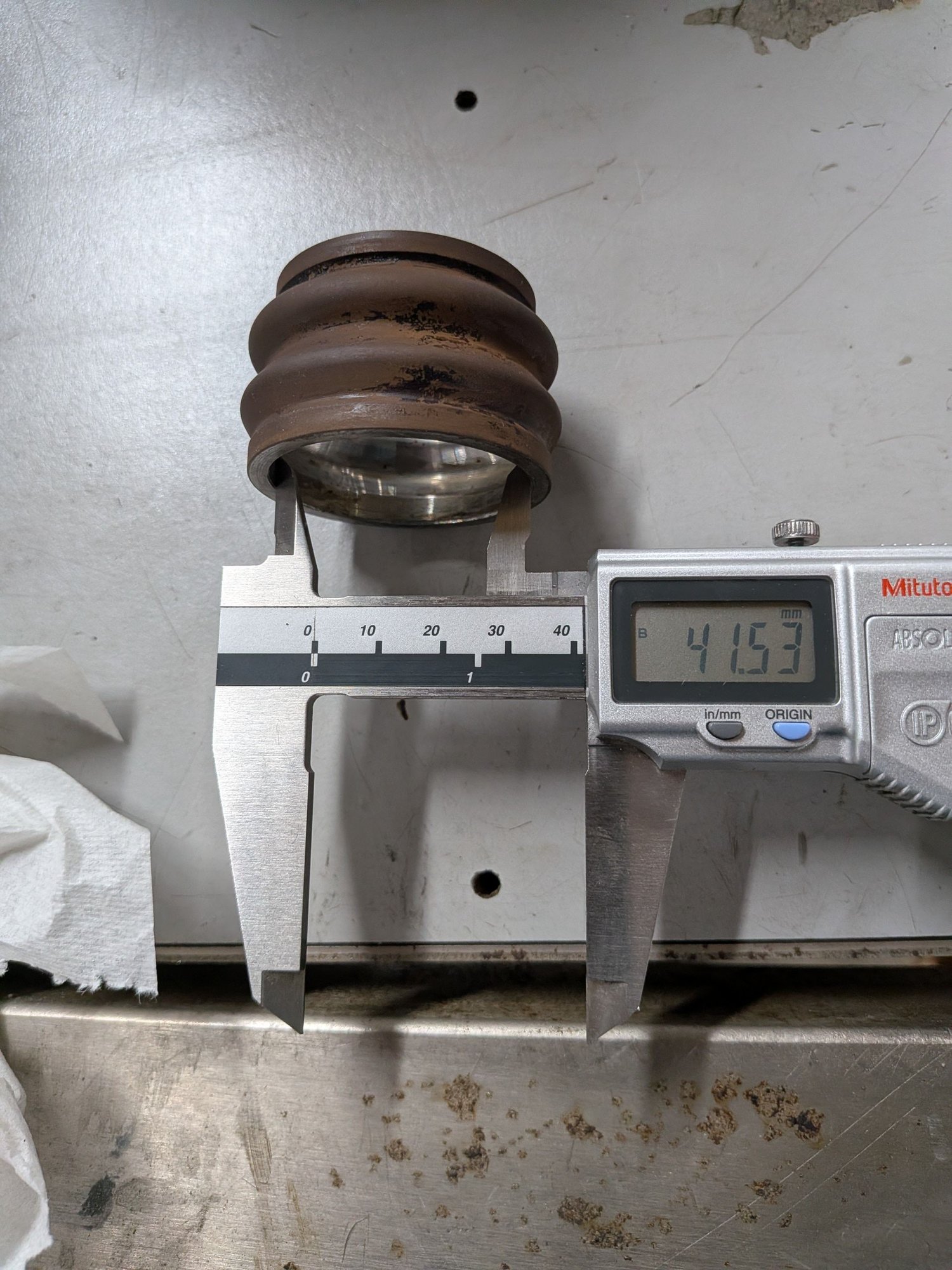

The spacer I have is a "Dana 30 TJ/XJ Crush Sleeve (50576, 4864845, Yukon Gear & Axle - YSPCS-007)"
Measurements as new:
35.95mm end to end (should not be a very critical measurement)
34.8 to 35.2mm ID, deepening on which end - as far as I know this value is also not critical, from what I have seen it should be over sized and slide right off the pinion shaft.
45.53mm is the widest bit at the "bulge"
So the more I look at it, the less critical the measurements are as long as they are really close to what is needed because the torque applied will crush it until the needed value is reached. So as long as it slides over the pinion and is within a loose value for length.

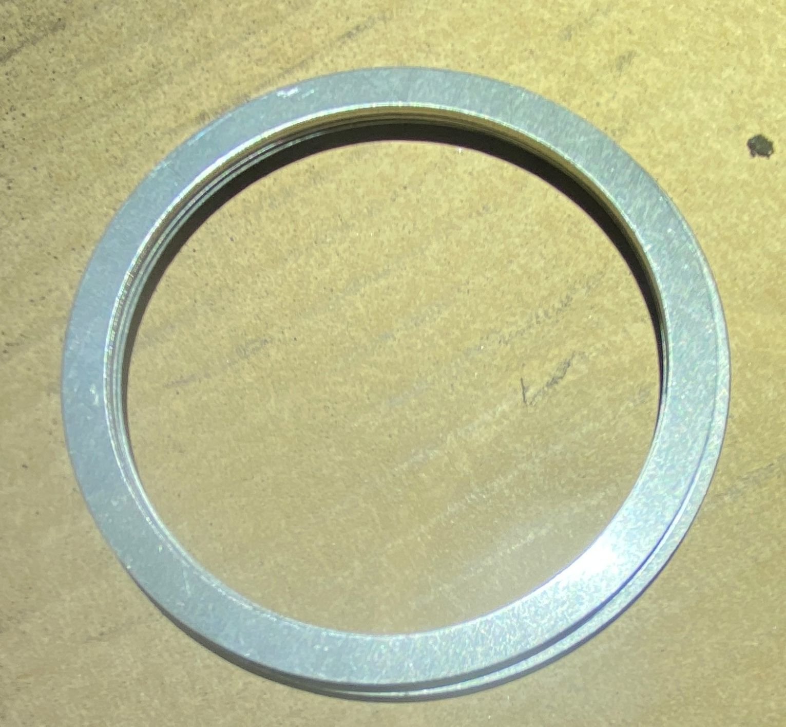

Shims came today. Not sure if I will need to use em or not. They are not the exact size of the originals, a bit smaller but they still plan on the race lip. Even the originals move around a lot. So I think they will work if needed but I would like a better fit. They are for a Dana 35 carrier race (not pinion) so I can see why they are not an exact fit. But they are also labeled M200, which is what we have. It was all I could grab quick and cheap so if they did not work I could just make em into Christmas tree ornaments.... I forget how many there are, but there are several very thin one and a couple thicker. Maybe six total? Note that may who know Dana better do say that people often call the M200 a 35, but they are a different generation.

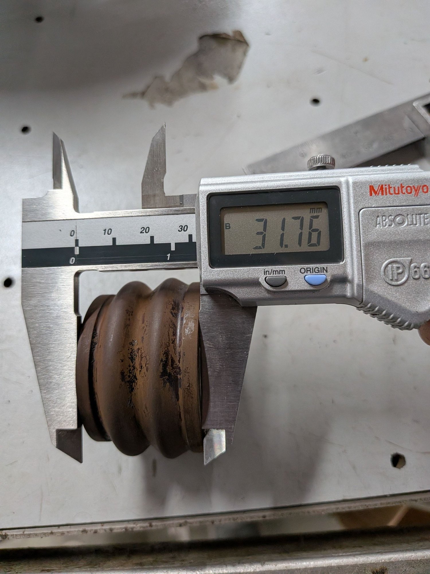

Picked up another diff today, opened it up and it looks to be in great shape
Here's the crush spacer I pulled out of the rusty one

That looks like a different design for sure. The ends appear to have a built in lip which will interface with the inner race better. This is the pic of the one I have.
