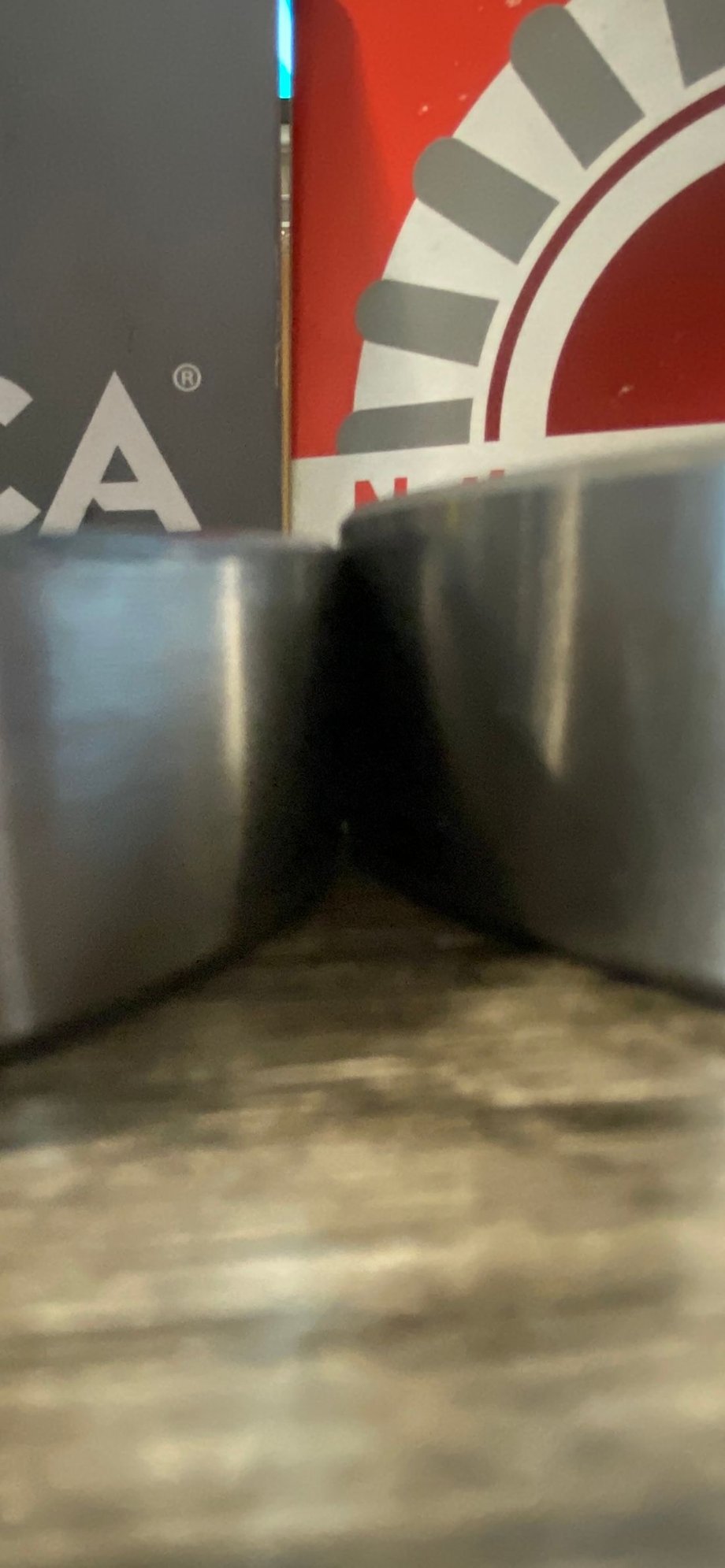

As for shims.... well that is related to why my project is stuck right now. I decided to buy NTN/National bearings. Had to mix because of availability form Rock. Rock Auto does not sell Timken. Timken is what Dana used on these with a Koyo pilot bearing on the tube. And what I found is that the National I bought has a taller race than the the original Timken. Crap pic below. So now I have a Timken on order for he driver side and I may get Timken for the other side too. In theory they will be made to the exact same spec as before and therefore the same shims can be used. Lesson learned, maybe. I also have shims on order but they are for a Dana 35, not 30 so not sure if they will work.
